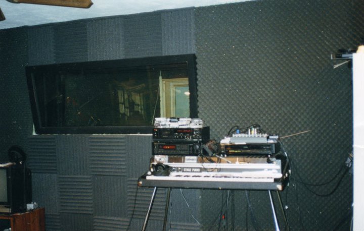

You can put foam up on the walls behind them and this will help but it won't do anything for the lower midbass to bass frequency's depending an the type of foam you are using.

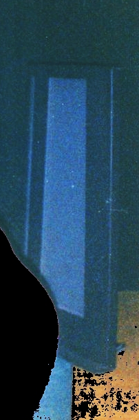

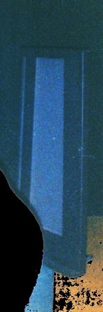

Here is a picture of the foam wall I once had and a crappy picture of one of my Apogee Duete's later positioned in front of it were the Piano was.

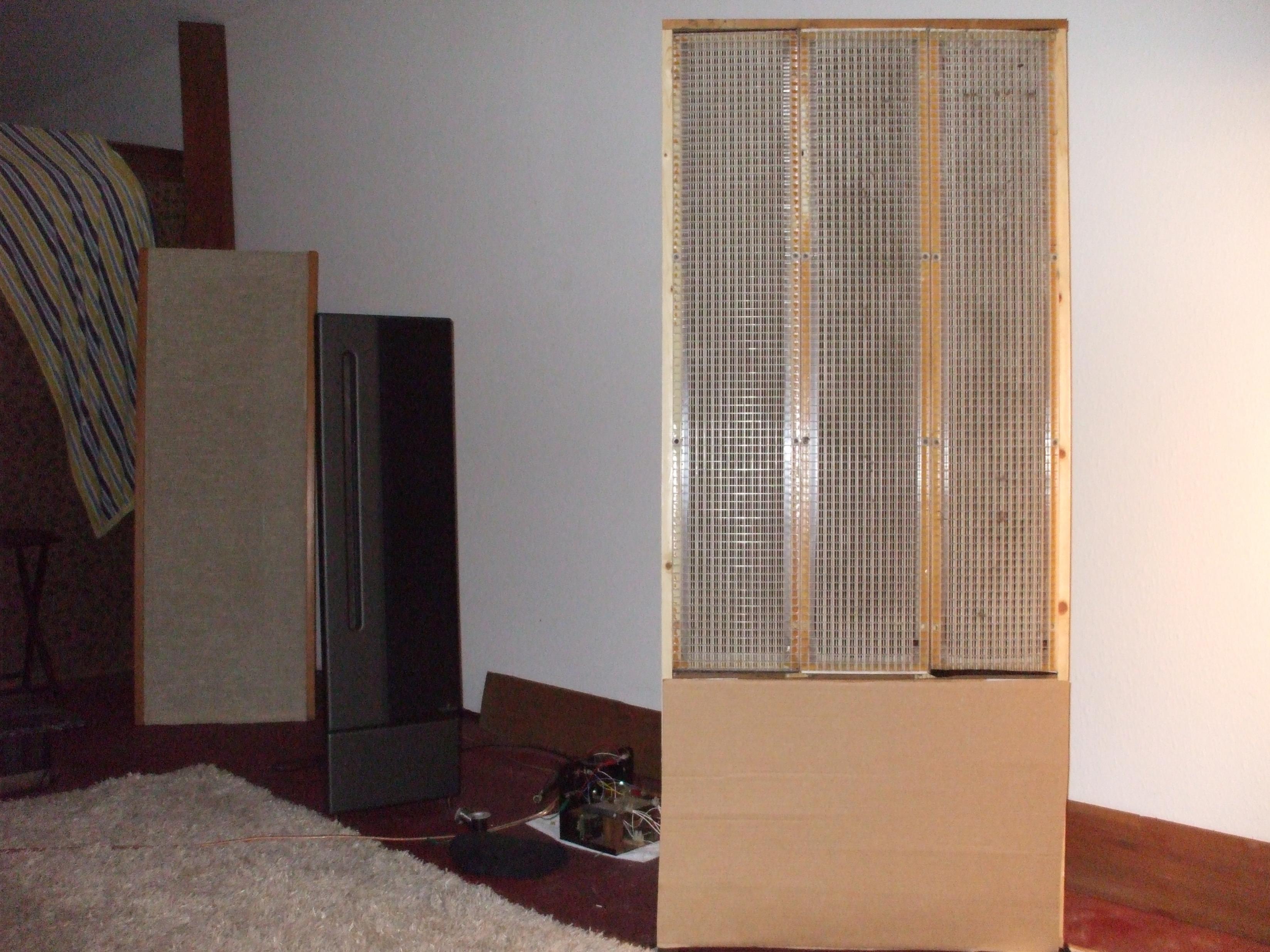

I have taken the approach of building narrower panels instead of wide ones.
I like their horizontal dispersion characteristics better.
I also have started to employ electrical segmentation in my latest build as well, I just haven't gotten the needed resistors yet.
I also use a bit more D/S than most, 1.85mm is what my new panel is set and may need to be increased a little, as this will allow for more output at the lowest frequency's than your typical panel made just for the midrange and higher with a typical D/S of 1/16".
I can get really good performance down to the 150hz to 250hz range just at the edge of diaphragm\stator clipping with a D/S of 2mm (3/32") and a width of 3.25" (and a 9.75" length) or so, and it is quite loud at this point (est. about >105db at 1 meter).
To compensate for this I use a much higher Bias voltage as well.
And higher transformation ratios (1:150-250) as well are possible increasing the overall efficiency using smaller area panels.
When the panels width equals one wavelength or greater than the frequency being produced, Then the dispersion starts to transition form a figure 8 pattern in to a narrow beam and keeps getting narrower as the frequency rises.
It also produces main smaller lobes off to the sides as well.
I have no issues of getting a high output from my little panels even down to the 200hz to 300hz range, providing that the stator coatings are up to the task of with holding such high voltages and there is plenty of D/S spacing.
At the lowest Frequency's the output level is directly related to diaphragm displacement and of course the dipole cancelling effect otherwise it would have a circular horzontal dispersion because the diaphragms width is much much less than one wavelength of the frequency being produced.
Wings can help with this and in a small setup I have found that it can increase the low end output by as much as 3db.
I have had better luck with not ruining the sound quality by using reflectors directly behind the diaphragm than I have had trying to dampen the backwave with some sort of absorbing material that is close the the diaphragm.
The back pressures created from anything within about 10"-12" from the diaphragm would reduce all of the finest details in sound that ESL's are so well known for, in my earlier experiments.
Using wings will help with the low end roll off as per dipole action, But the width of the diaphragm itself will determine the horizontal dispersion effects (beaming) for the higher freqeuncys.
And the more the displacement, This helps with the low end.
It is obvious as to why ML suggests to toe out there speakers!!
Its due to the delays and refraction issues of using a curved panel.
When using a taller panel in a line source arrangement the top and bottom reflections from the ceiling and the floor give the impression of having a larger room such as mirrors would do using light waves.
Giving an extension to a virtual room, If you will.
At least that is the way I understand it from reading a lot material on the subject.
Having any space from the ends of the driver to the ceiling and floor is when the reflections are refracted differently and unequally.
FWIW
jer 🙂
