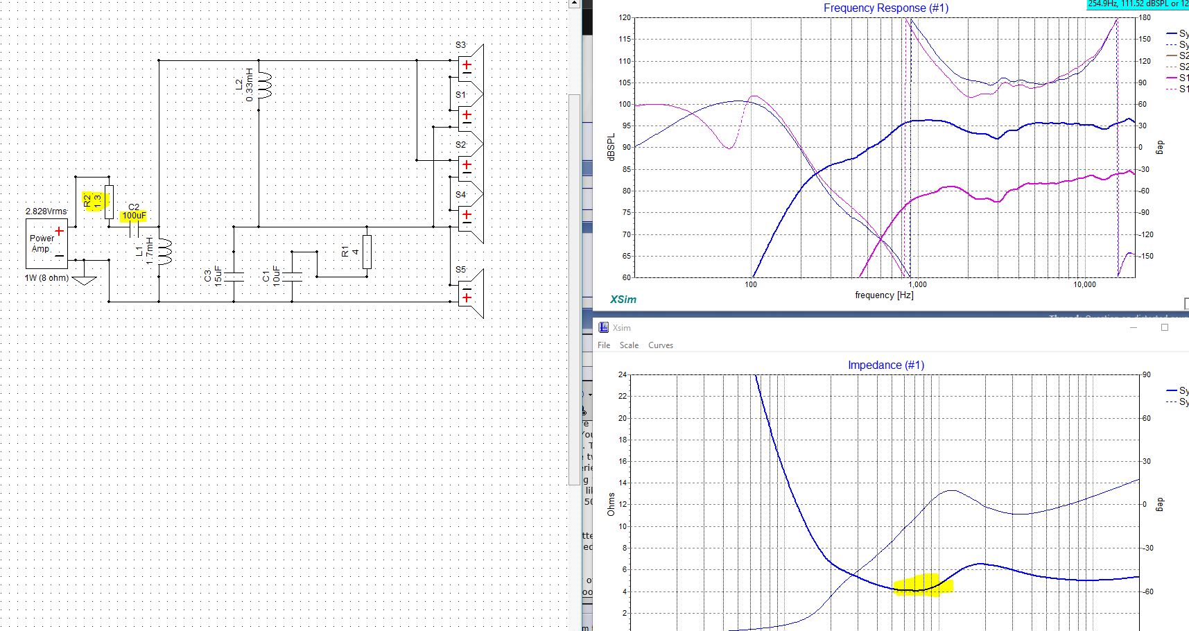

This is a simulation of a 15M only on a baffle (blue) and filtered with a bandpass filter of yours, the 3.4R padding resistor included. I did my own frd and zma. Is 900 Hz where you want your woofer crossed, and 3.3 kHz for the tweeter?

I see a 90 db mid with a 96 db tweeter in your setup
Im confused on your use of these drivers, can you state all crossover points of all drivers including woofer

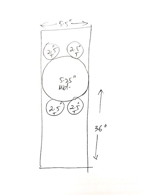

Here's a rough drawing of the baffle
Hmmm have U tried that tweeter arraignment before?? That's a very strange tweeter array.
The simulation looks wrong to me. That tweeter wiring should give approx. +6 db over 1 tweeter. That puts tweeter sens at around 95-96 db. Even if your mid is 92-93 db that's still a high tweeter level
No, but I would like to try it. I have tried it in a vertical array, it has limited top to bottom dispersion. By doing this, it reduces beaming a little bit.
I agree with the +6db on the tweeters, I did not consider constructive interference, I will pad them down with a resistor or just EQ them to taste, especially in the 3k to 10k region.

With good reason. As part of test hearing different components, I removed the 6r8 to see if it was causing a shift in FR, but quickly realized why I had it in the first place... the amp was not designed to be run at 4ohms... it shorted out 10 seconds... now I have a secondary issue to deal with. 😡 Its not going as well as I thought...

As for the tweeter array, the 4 spaced around the mid may give less vertical beaming than the 4 in a vertical line, BUT I would guess thats only because the 4 spaced around mid produces a more diffuse and less coherent wave. Not really a the best thing for image specificity and driver blending.

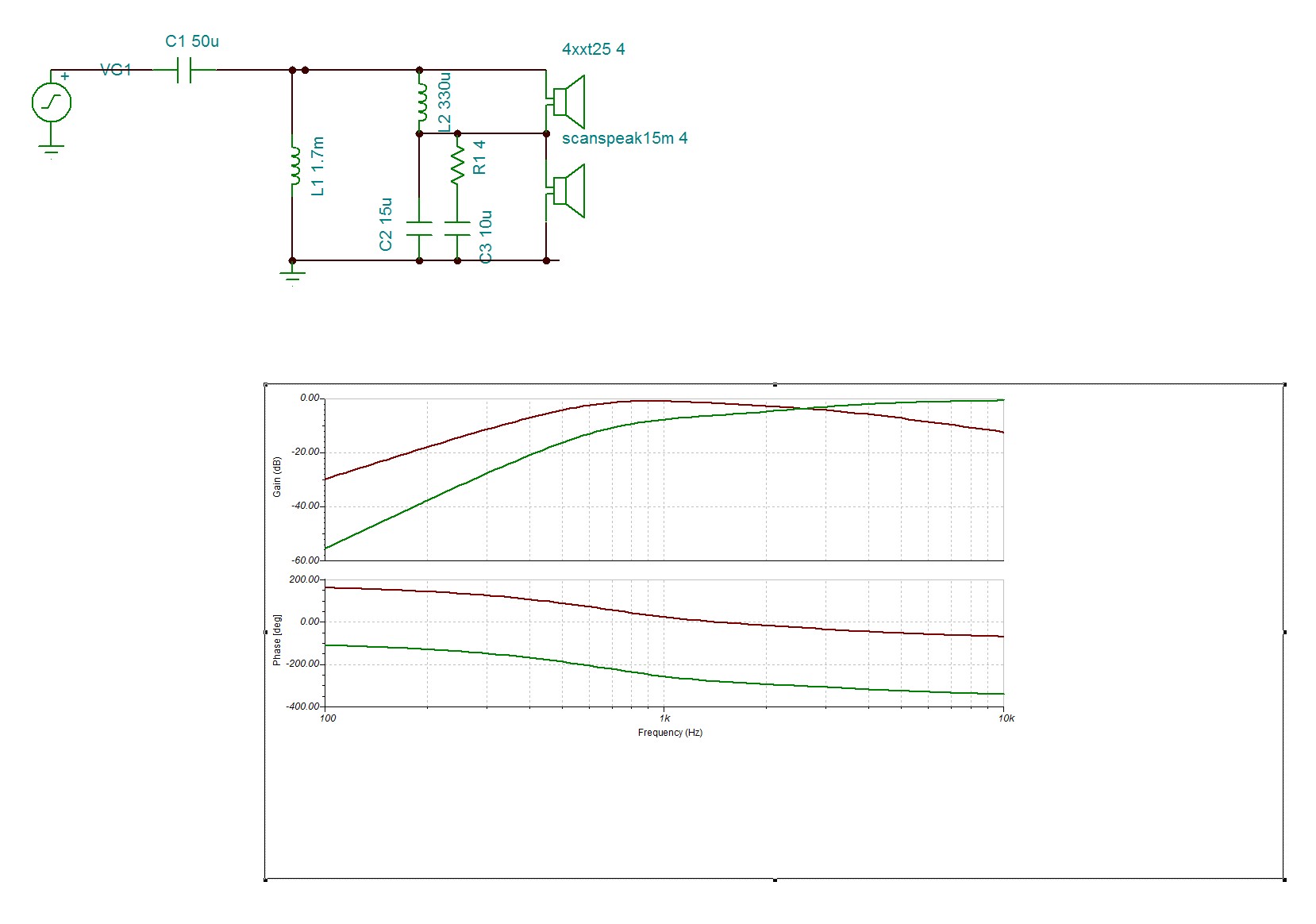

You have a very particular configuration , made of 4 x100w capacity tweeters . You don't need to cut off second order but make it complimentary first order . This type of filter provides perfect addition of the sounds, specially if the tweeters are surrounding the midrange . Four tweeters in parallel serie mounted ,gets it's efficiency increased by about 6db at non beaming frequencies ,which may exceed that of the midrange. The midrange as you liked the sound , I advice you to dedicate the widest range . I adjusted 500hz ,2.5khz .

Thank you, very interesting and outside the box. Let me sim this on Xsim and see the FR.

I made a couple of adjustments for better integration with the bass units with are cross off at about 250Hz. Added a 1R3 to keep impedances above 4 ohms for a bit smoother sound.
In this sim, I had to invert the polarity of the Mid, to keep phase coherence intact, is this what you had expected too?
