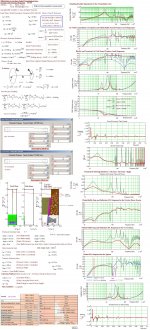

Thanks guys for the information, I'll have a look at TL/horn, Bjorno posted an example calculation a few posts ago but, I'll have to study it because I basically know nothing on that area, the screenshots he posted are mostly "chinese" at the moment 😉
..I'll have a look at TL/horn, Bjorno posted an example calculation a few posts ago but, I'll have to study it..
Hi Manuel,
Have a look at this supplementing MJK simulation where the HR T-TQWT in post #16 is modeled as an OD-TL (Offset Driver- Transmission-Line):
b🙂
