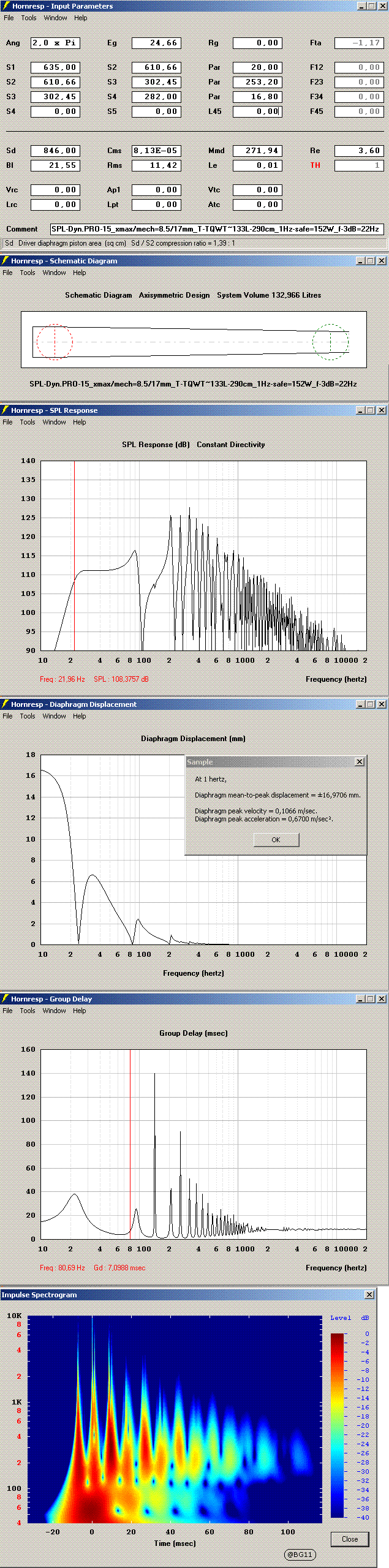

Thank you, I was looking to have a maximum SPL at a certain frequency and have a quite flat response in the area I wanted to use.
The max SPL I got by entering my amp power into the model, the frequency response by changing the tuning and size of the enclosure...
I added two screenshots of the SPL and frequency response at 700W.
If I understand it well I could get the same frequency response and SPL output in the 100l enclosure by simply equalizing?
sreten, the port needed for a 15" driver in a 100L tuned to 20Hz box would be a transmission line. I agree above 80L sealed you don't gain much.
are you checking on excursion for those sims?
I have entered my xmax when I inputted the driver, but beside that I would not know where to find the excursion 😕

are you using Winisd pro? It's under the cone excursion drop down menu thing.
a port becomes a TL when the port resonances move low enough to come into play. basically any port longer than 34" you have to use stuffing to tame the resonances. or... crossover the subwoofer really low so the first harmonic is below port resonance.
Thanks, no I'm using the beta version...
I was going to use a square port about the height of the enclosure, I fairly calculated it will be less then 34'' deep so I guess I'll just escape the TL trouble?
I should buy the Pro Version once, the guy deserves it 🙂
Thanks revboden! Downloaded it, excursion is perfectly good until the tuning frequency...
