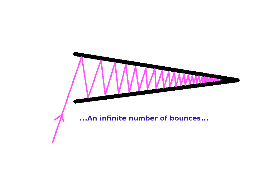

That old 1972 Bailey transmission-line design uses a clever trick borrowed from geometrical optics (ray optics), namely, directing a wave into an ever-narrowing wedge-shaped space.
If you trace the path of reflections in such a space (see attached hand-drawn image), the (purple) wave bounces back and forth more and more frequently as the space between the wedge walls (black) tapers towards zero, so that you get, in theory, an infinite number of reflections before the wave reaches the pointed end of the wedge.
(For an analogy, imagine summing the series 1 + 1/2 + 1/4 + 1/8 + 1/16 + 1/32 +......, which goes on for an infinite number of terms, with every term smaller (half) the previous term. There are an infinite number of terms in the series, but, as some of you might remember from high school math, they all sum up to a finite number. In the same way, an infinite number of bounces between the wedge-shaped walls occurs in a finite length of wedge!
Getting back to the ray bouncing between those walls, if you lose even a little energy to absorption on each bounce (which you always do), then an infinite number of bounces will absorb all the energy, leaving nothing! No energy left to bounce back and interfere with the ray that came in.
In practice, of course, you don't get an infinite number, just a very large number. And you don't get 100% absorption of the wave, but you do get almost 100% absorption.
So this sort of tapered wedge-shape behind the speaker is a pretty clever way of absorbing most of the rear sound radiation from the speaker. (Much more effective than generic wavy walls.)
-Gnobuddy

This problem with this thinking is that it assumes that sound radiates as a focused beam like a laser pointer. In reality sound radiates with a spherical wave front and the further it travels the larger the diameter of the sphere. At some point, the sphere becomes large enough in diameter that it reaches both sides at virtually the same moment and the 'infinite bouncing' ceases, the contributions from left and right walls become in-phase and you get a reflection back.
The wave front you drew is perpendicular to the direction of propagation of the wave.
The purple arrow I drew is what is called the propagation vector in contemporary terminology.
When the wavefront is a small diameter sphere, the direction of propagation varies from one location on the sphere to another, i.e., the propagation vector varies from one place to another (in direction).
When the wavefront is a very large diameter sphere, it is nearly a flat plane, and the propagation vector description becomes very good in any one small area.
So in fact, when the wavefront is a very large diameter sphere, the ray description is more accurate, and the idea that the ray bounces infinitely many times is closer (rather than farther) from reality.
This is probably not technically 100% accurate but I think it gets the point across
Unfortunately, it gets the wrong point across!
I agree, neither the ray nor the wavefront description is 100% accurate. To be 100% accurate, you solve the second order differential equation that describes sound waves, applying the proper boundary conditions (zero air velocity at the surfaces of the walls of the tapered horn.)
Richard Feynman gave one of his famous lectures on the sound wave equation, and derived the one-dimensional version of this wave equation with his usual amazing clarity of thought and description: The Feynman Lectures on Physics Vol. I Ch. 47: Sound. The wave equation
In our case, we would need to use at least the two-dimensional equation (both x and y) since we have to deal with two non-parallel walls. With the right software, this would not be hard today. But while you would get pretty accurate results, the process would be obscure enough to make it relatively hard to understand what was going on.
That's why I used the simple geometric ray-tracing approach. It is not 100% accurate, sure, but is "accurate enough" to give some intuitive understanding of the problem, as long as the wavelength is sufficiently small compared to the horn, and the wavefront radius is large enough to be nearly plane compared to the diameter of the horn.
Ths simple ray picture isn't exact, of course. There won't be an infinite number of bounces in the real world, but this is most likely because the tapered shape eventually narrows down until it is smaller than a wavelength, and ray optics ceases to be applicable.
The main point I wanted to make was that a long wedge-shaped space is much more effective at absorbing unwanted radiation than a smoothly wavy surface of the sort that started this whole thread.
