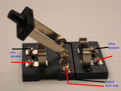

Get a double pole double throw switch. Connect the amp output to the center terminals, and the speakers to the outer terminals. The picture just illustrates how to hook up the switch. You can use any dpdt switch for that; it doesn't have to be as big as the one in the picture. And as everybody else said, don't connect the 2 channels (outputs) together. I don't see why you couldn't do a/b testing using the signal from only one channel.
But does it let you hook one speaker to the left and right channels? That has been the big sticking point here. Everyone tells me that doing this is not a good idea, and now I have a dying amp to possibly back that up.
I looked at the Niles and other units. I figured I could just build one, but now everyone tells me that doing it the way I need is bad for the amp. So I don't know what the answer is right now.

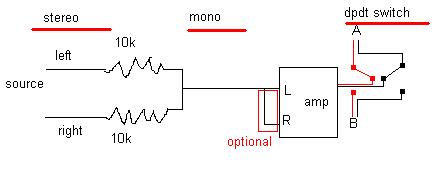

Why do you need to hook up one speaker to both channels? If making the stereo signal mono is your main concnern, just make an adapter as shown in the drawing. 10k resistors would work for this. And then, only use one channel of the amp. Make sure to use resistors, or you will overload the output stage of your signal source.
One more thing you can do is connect 2 rcas to the output. Then you can feed both channels the mono signal. Connecting amp inputs together is fine, but connecting outputs is not recommended.

This is a great idea, but again, as I explained elsewhere, what do you do if you choose to test using the left channel and all the vocals are mixed in the right channel? If I were using a tone generator, there would be no problem, but I'm using real music and so I have to be able to hear the entire recording, not just one side of it. That's why I feel I have to have the information from both channels.

xplod,
Could you please look at my thread in the Class D forum (it's still on page 1) and perhaps post you schematic there. You bring up another question that I had, and that is what effect all this might have on the source.
And yes, the whole issue is combining a stereo signal into a mono signal, AB switching it, and running it to individual speakers without blowing up the amp or the drivers, or the source.

Here you go. Here's a way to connect it using the channel summing before the amp, and the a/b switch after it. Doing it this way will not blow anything up. Or you can do as others have suggested in the other thread and switch the mono signal to either left or right channel while having a speaker connected to each channel. That will affect your results because there might be differences between the amp channels.
Thanks, I saw your posts in the other thread. As for differences in the amp channels, I noticed this in my other amp. It really didn't create a problem. The difference was extremely minor and only affected volume. I figured that out pretty quickly and was able to adjust for it. If I had any doubts on something, I switched the speakers.
