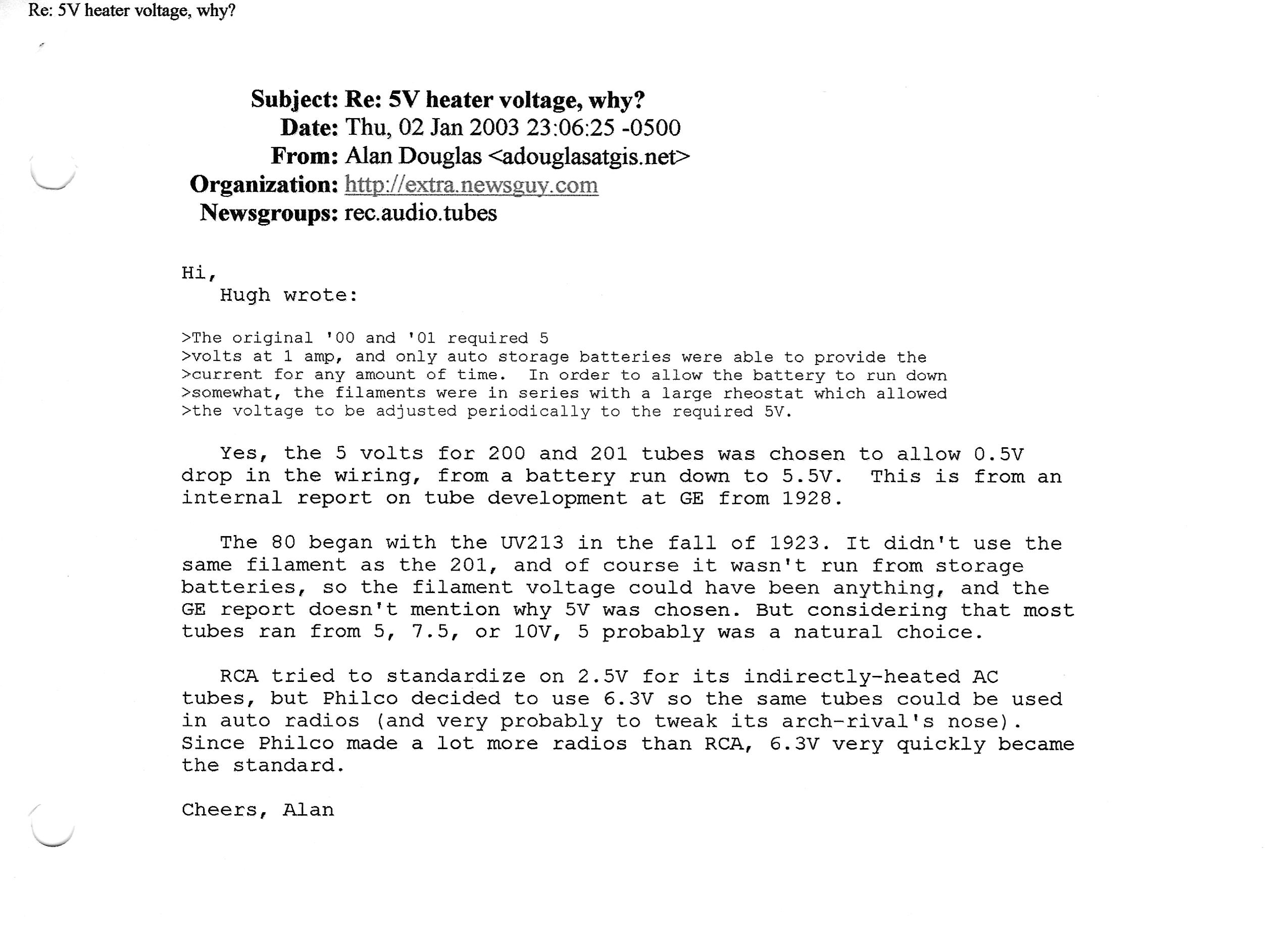

Why 5 volts for the rectifier? Maybe because 5 volt DHT's already existed? It would be pretty easy to make a rectifier out of a twin plate 2A3 with no new parts. I don't know for sure.

Most probably your theory is right, as it also might explain why there weren't 5 V rectifier tubes here in Europe (until the GZ34/5AR4): We just had no 5 V heated power tubes here.

The 5V rectifier was an American thing driven by the large industrial labs GE & Westinghouse in the early 1920s. All covered in a few pages (~p 324) in Gerald FJ Tyne's 'Saga of the Vacuum Tube'. The 80/280 was hatched in May 1927 as the UX280 at Westinghouse. Many of the triodes & other tubes in development used 5V cathodes, it was a natural progression to simply use what was known to work.🙂
