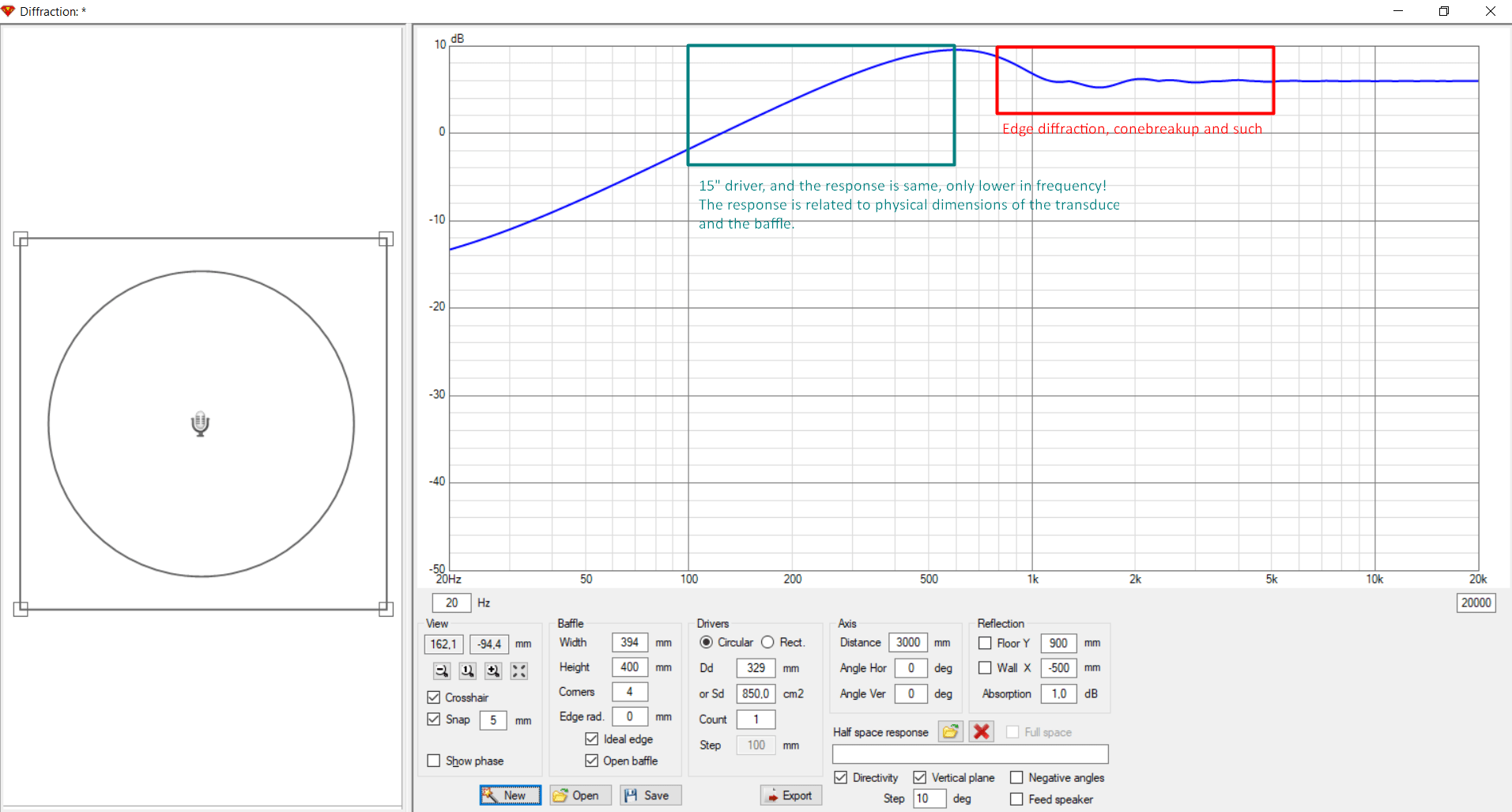

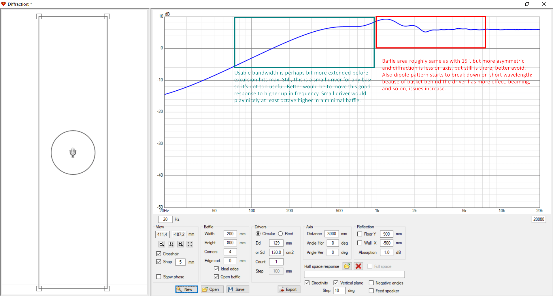

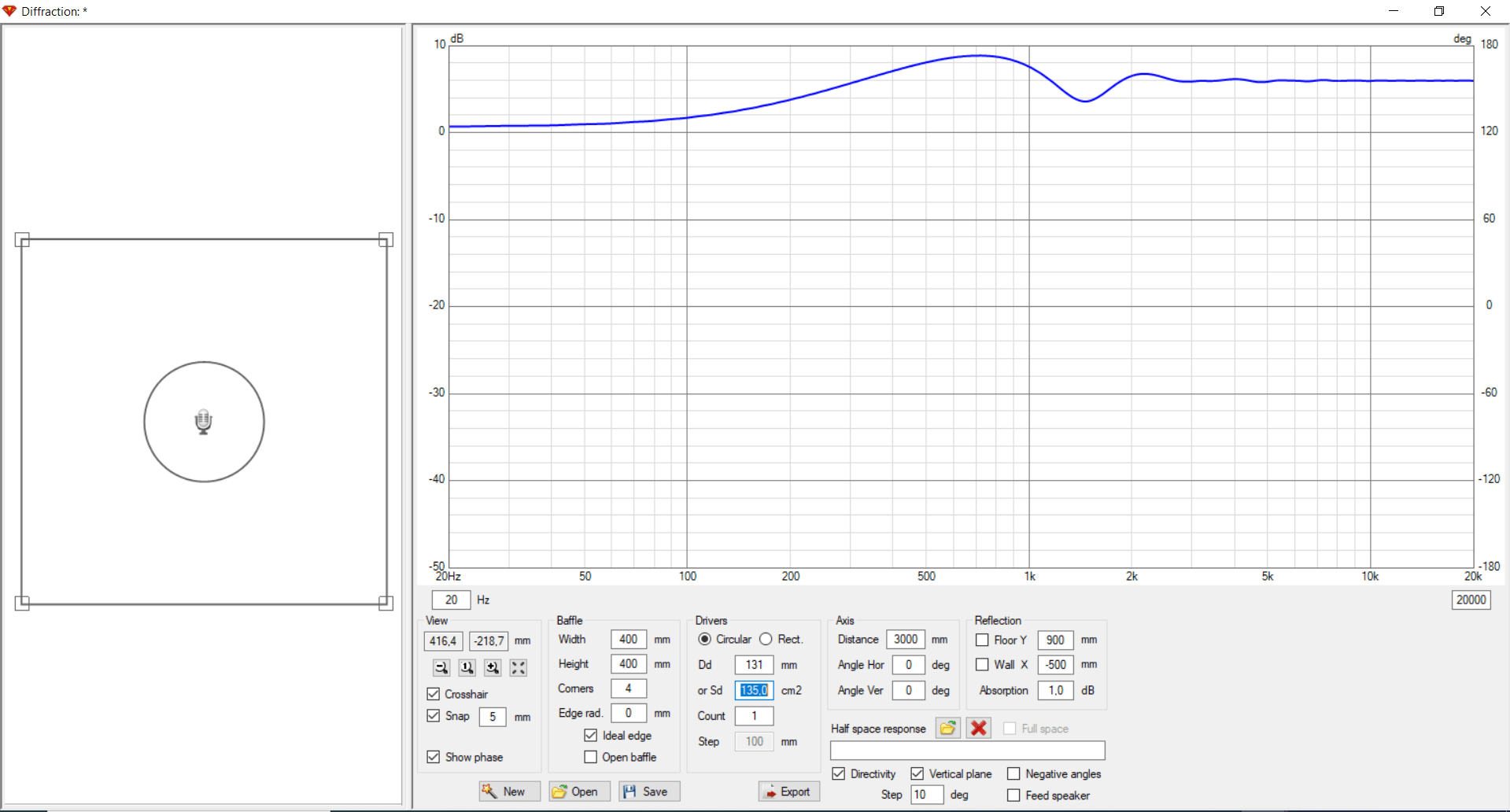

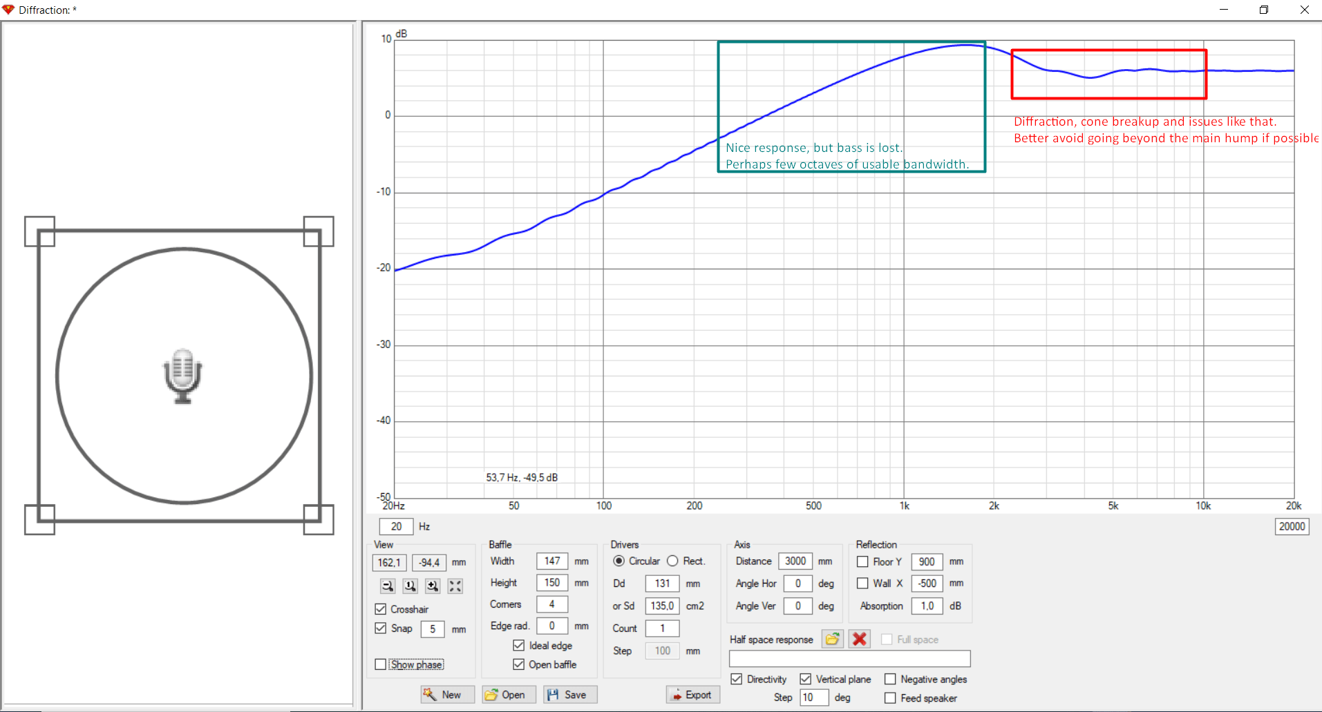

Eh, edit time over. The VituixCAD diffraction simulator has zero thickness to the baffle and is simplified in many ways, so what comes around from the other side perfectly coincides with the diffraction backwave that emits, hence both OB and closed box diffraction sims look pretty much the same. If baffle was very thick, the sound coming from the backside would have more delay than the back wave at the front edge, and they would not coincide and reinforce each other as perfectly.
So, the dipole peak and dip is a concept that exists separately to the diffraction backwave just like Linkwitz writes and calculates, but observed from listening window it is about the same as diffraction back wave as long as one driver is used for both front and back sound and the baffle is much less thick than wide, in other words an OB.

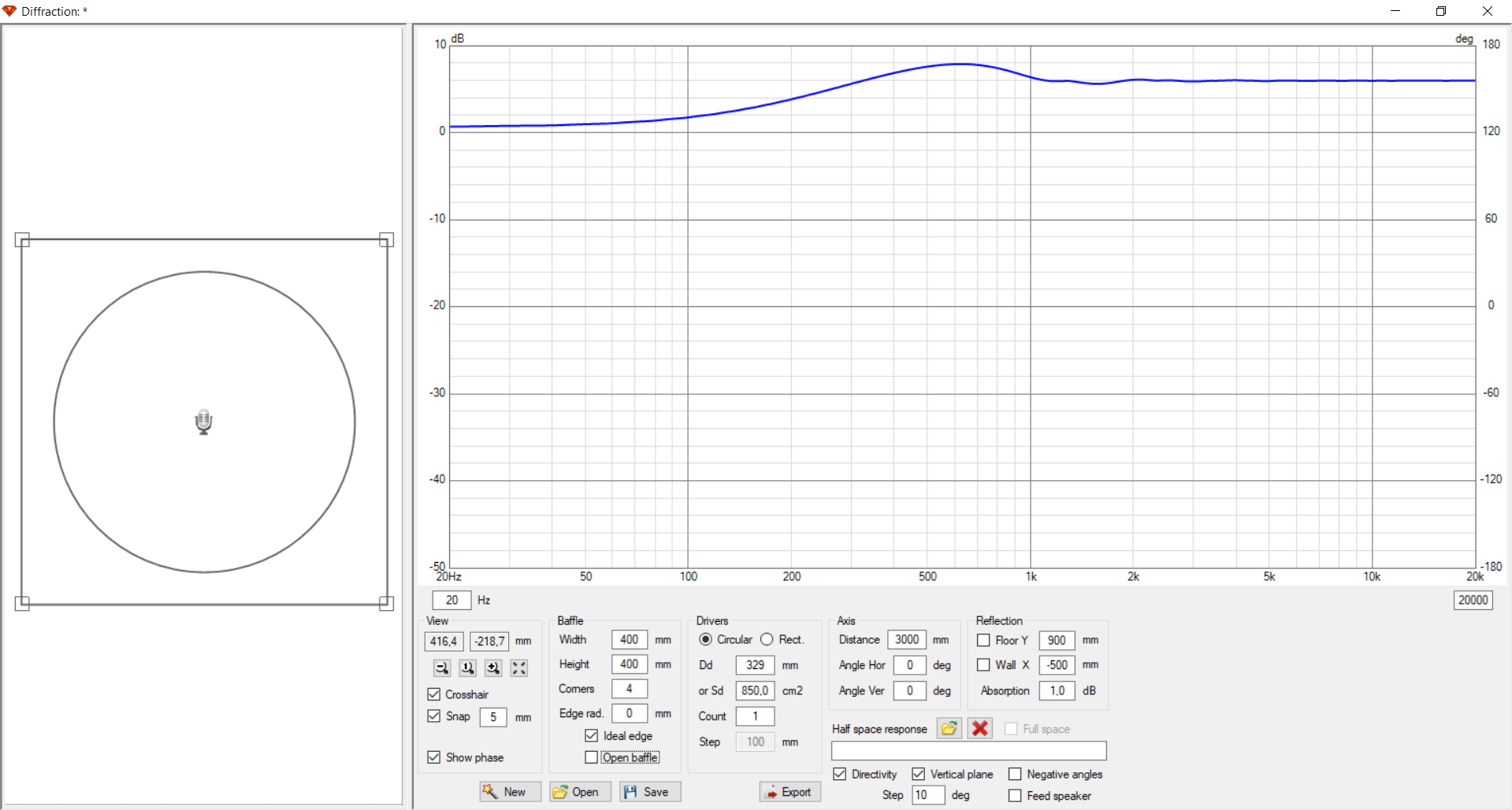

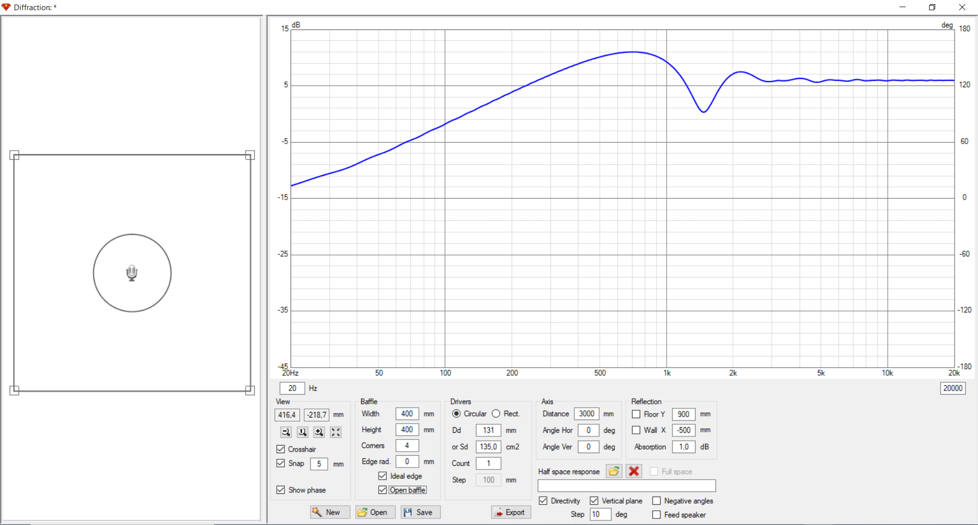

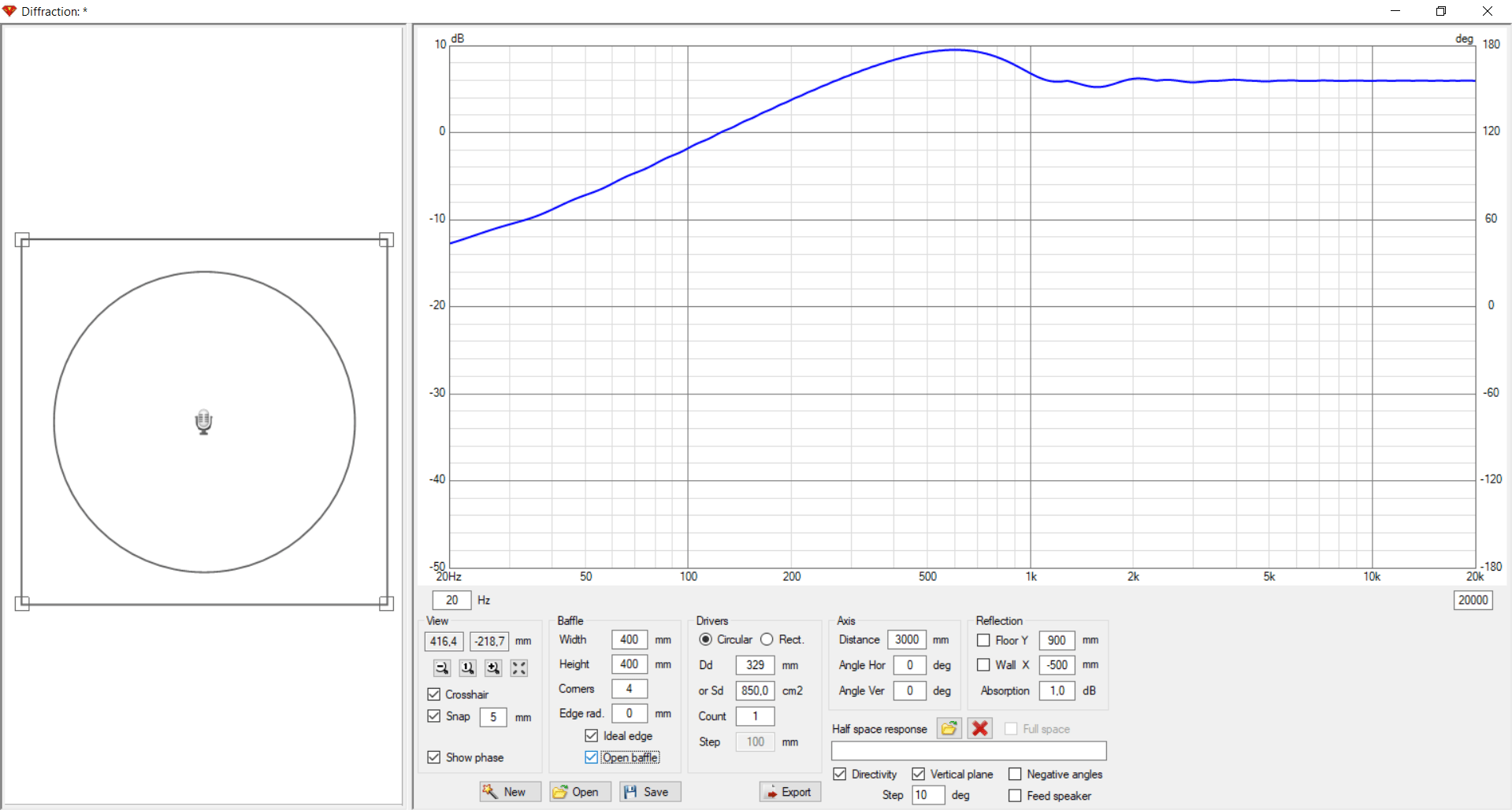

Another simulator view to this, VituixCAD is nice as it's real time and simplified in a away that it enables do this kind of "in isolation" tests.

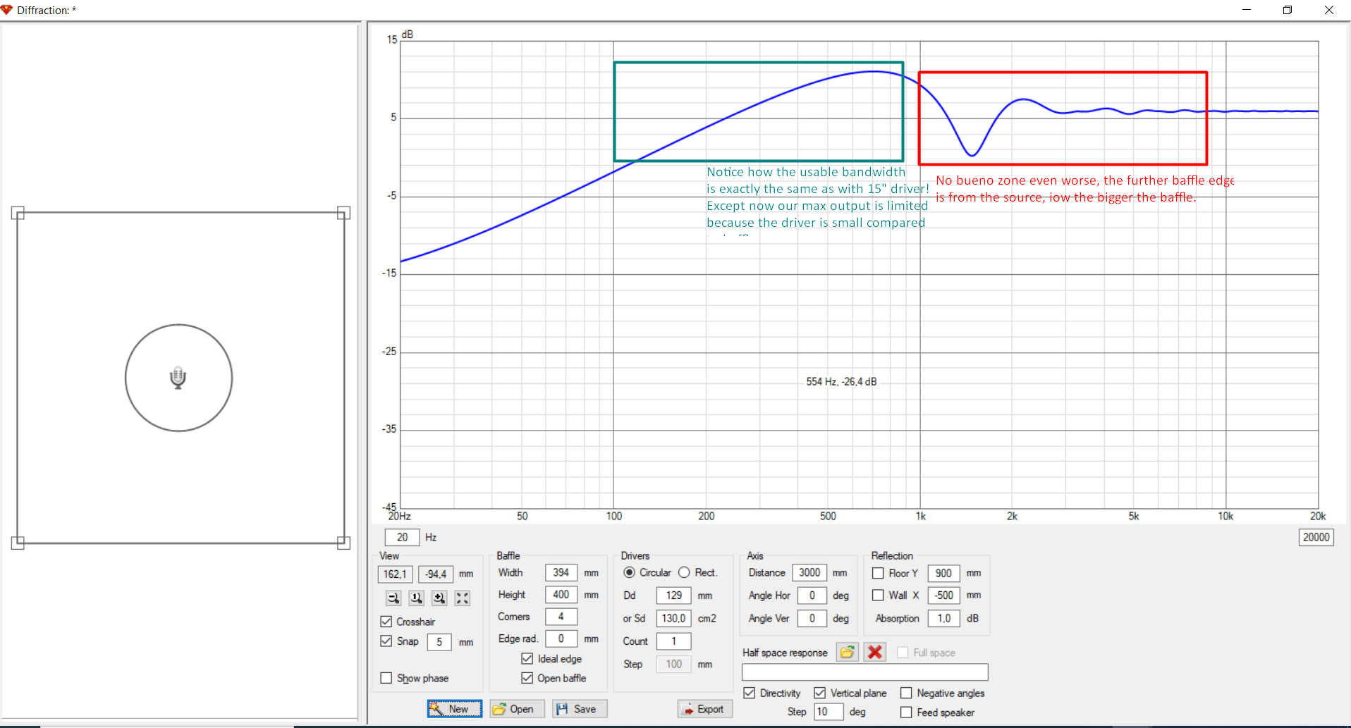

Here is the same 40cm baffle and ~6" ideal driver I've used on previous examples. It's a closed box to have only the baffle edge effect.
Export full polars to the main program, flip around 180deg and flip polarity we get the sound that would come around with a OB speaker from back side towards the listening window. So this is basically backside response of the OB speaker towards 0-axis in isolation, without sound from the frontside.
Here is the front side of OB in isolation, without effects of the backside:
These two combined makes the OB speaker response towards 0-axis. Familiar looking graph? Just the diffraction simmed OB from previous post next to it
What we can do now is increase baffle thickness, try to separate sound from backside making the "dipole peak and dip" from diffraction back wave peak and dip of the frontside 😉
Fun stuff 🙂

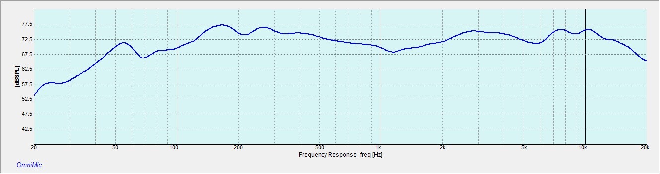

Just for info - this is in room measurement of my open backed 9 sided horn - including the reflections, microphone is ca 1 meter from the mouth (I know, too close). I think the first three dips (ca 150 - 350 Hz) are caused by the room/environment, since they can be seen both in the midranges and LF drivers.
I forgot to say, I have not seen any prominent dipole peak and dip (will check more in detail later).
Is there audible "horn sound"? as per the reasoning above, with such hard edge at the mouth there is strong diffraction backwave back into the device, which reflects back out, then again and so on. More over, it's not just the diffraction back wave, but also the OB sound from backside diffracts into the horn and reflects out. This all kind of maximises "mouth reflection back to the throat" phenomenon, although as per the above reasoning perhaps it melows out some?

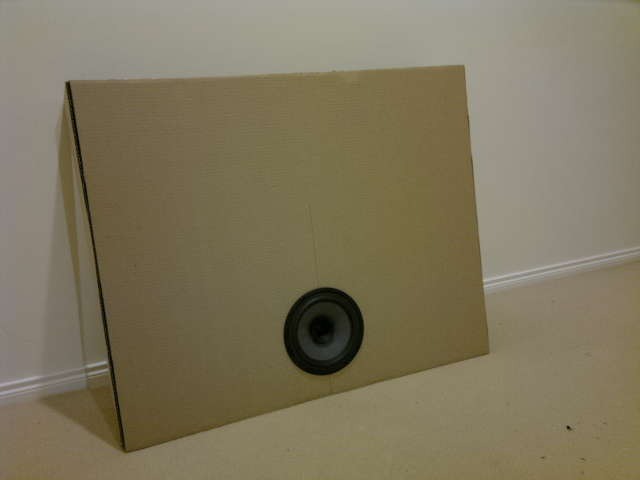

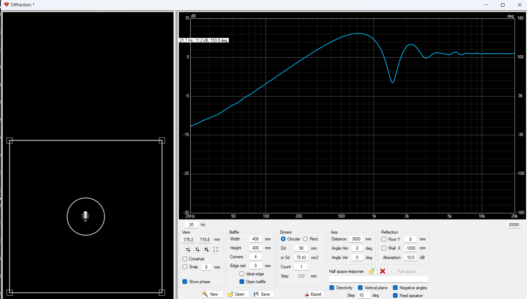

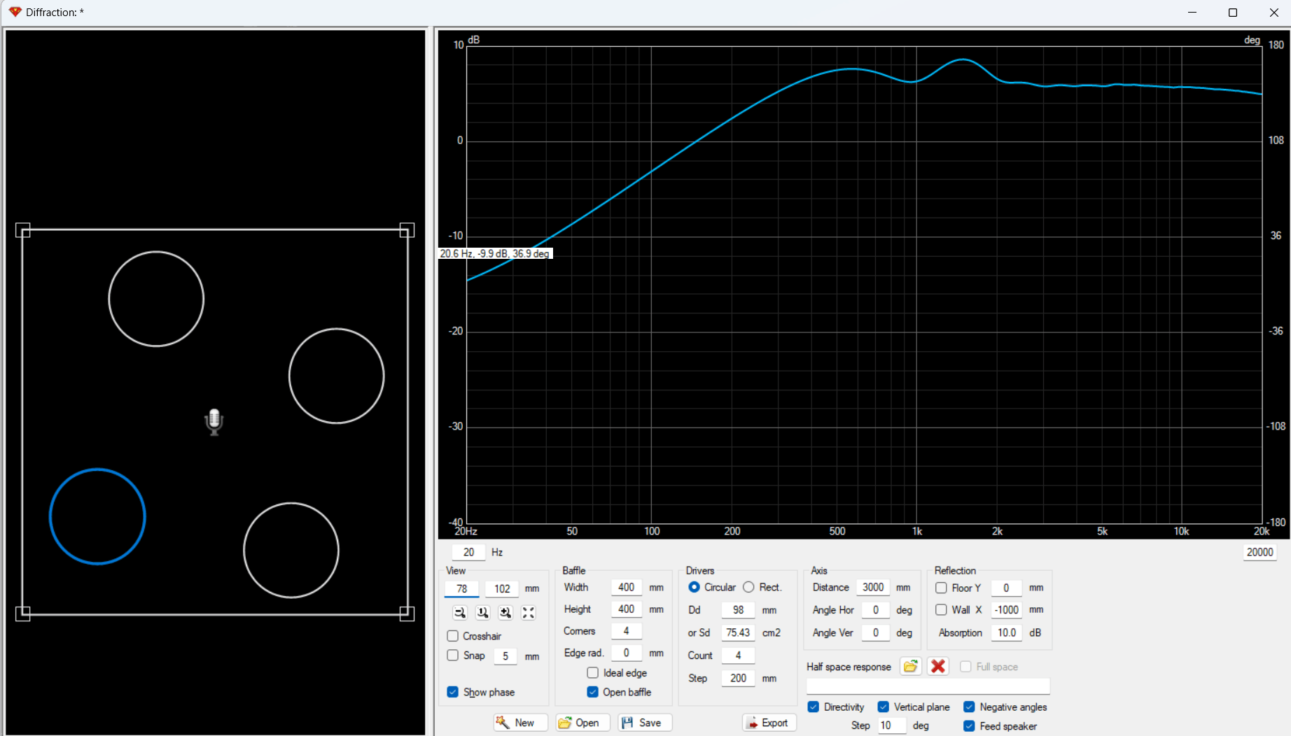

This is the sim of a sixteen inch wide baffle with four woofers
this is the sim of a sixteen inch wide baffle with five woofers
this is the predicted polar response (normalized) of an open baffle with five woofers
If you can live with an off-axis dip at 1khz, it looks like you could cross the 16" wide baffle as high as 1khz
But ideally it would be done somewhere around 400Hz or so, where the polars are better behaved
If there's a decent midrange that can handle high power, it might be tempting to reduce the baffle to around ten inches or so, or even less. I'm definitely seeing the appeal of small baffles, but multiple woofers DOES seem to improve things quite a bit.
