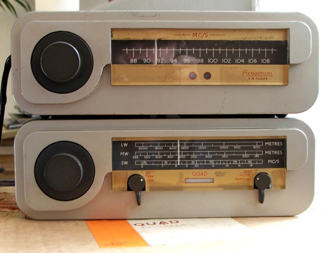

Get the strongest FM signal you can arrange; as suggested above.
Actually - of more direct interest - note that Quad tuners FM 1,2,3,4 are all designed to drive a minimum of 100K input impedance in the preamp; and so have very, very small output coupling caps (100n - 220nf max). Replace or augment with 4.7-10uF if your preamp has a lower impedance input (as is likely)
I've everything from an 'Acoustical FM1' (1954 - made before P J Walker's company was renamed Quad); to a late -production FM4. They are all lovely to use - subject to the above...
(ETA: for the valve FM1, FM2, you must add a buffer to drive anything below 100K; else you overload the valve Foster-Seeley discriminator which is also the stage; that done, the musical performance remains excellent)
eta2: pic...
