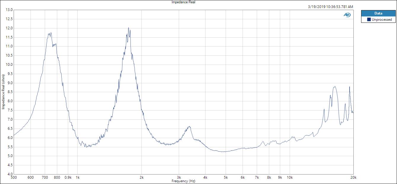

Attached is a previous JBL2432H Compression Driver with a JBL PT 1010HF waveguide attached.

First, the three large impedance peaks are the result of driver resonances, not horn resonances. Only wall discontinuities (most notably the mouth) will cause horn reflections and further impedance peaks. A very low diffraction/reflection waveguide will have only two peaks, no others, as mine do.
To me, the rough nature of your impedance indicates a poor measurement and not reality.

I completely disagree with both of your paragraphs.
The first or lower impedance peak is related to the compression driver.
However the higher the higher impedance peaks change completely or even disappear with different horns or waveguides attached to the very same CD.

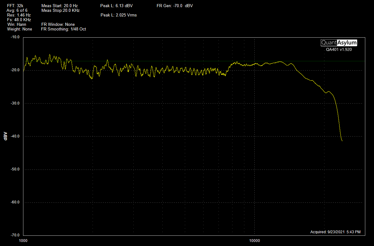

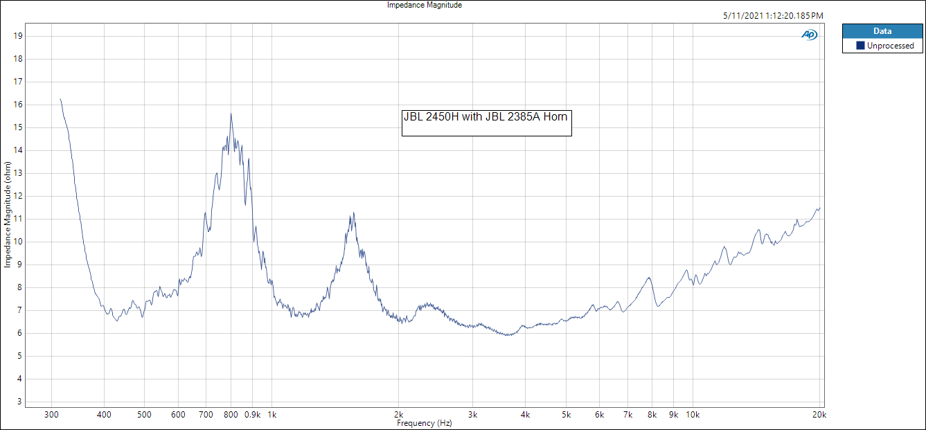

There is no error in the impedance measurements. The measurements are made with an Audio Precision APx555 Analyzer and Audio Precision APx1701 Transducer test interface following AP procedures. Professional gear.
The graphs are from raw data with no smoothing or math adjustments. The saw tooth appearance only appears measuring CD/Horns/waveguides, not with cones or domes. If I turn on the math smoothing the plots do not have the saw tooth appearance.

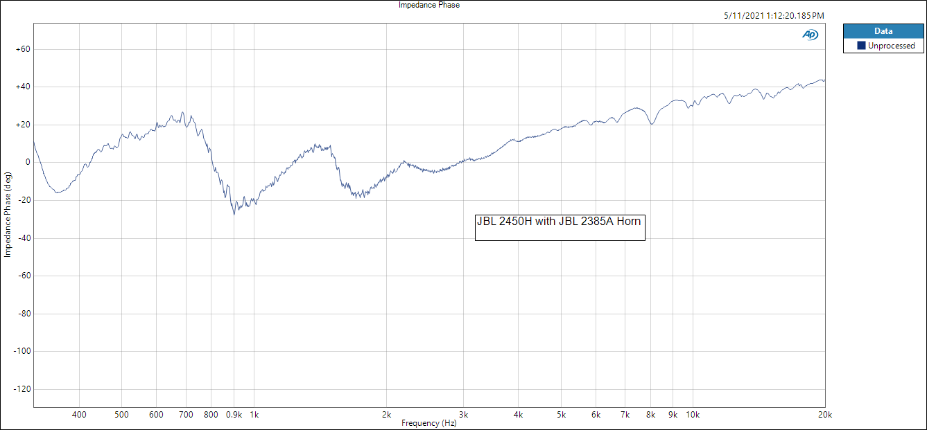

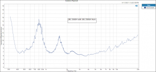

Another CD/horn plot
All compression drivers have at least two peaks, on any horn. These peaks will move around based on the mass load of the horn. Some compression drivers can have three peaks, on any horn. As I said, mine only has two peaks and makes a very clean impedance without all the hash seen on yours. Trust me (I've done this more than a few times,) something is wrong with your measurements despite using premium equipment.

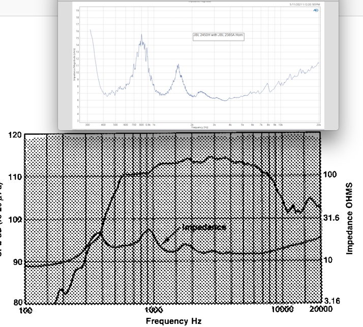

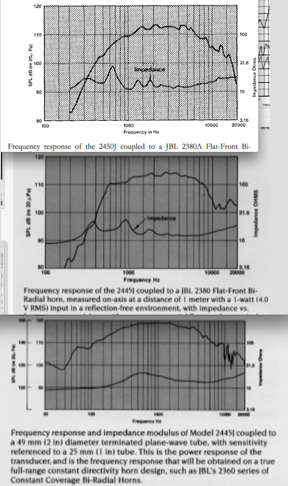

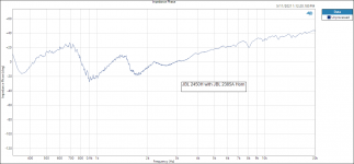

Looking at the JBL impedance plot of a 2445 driver on a 2385A compared to your JBL2450H on the 2385A horn, the peaks on the 2445 appear to be at 450, 900, & 1800Hz, the 2450 at 800,1600 & 2200 Hz.
It appears you may have used a series capacitor in your test, which may affect the impedance peak locations.

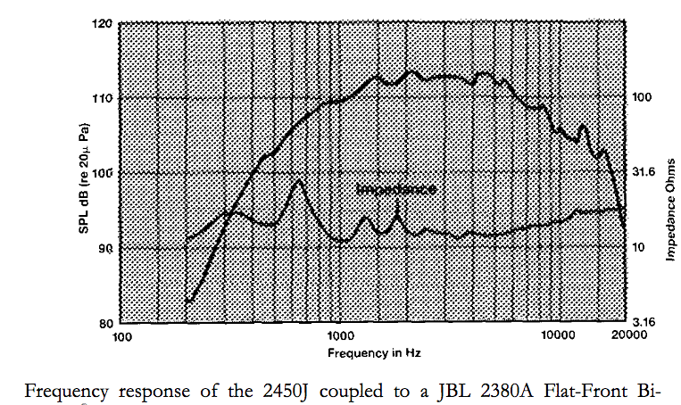

Looking at JBL's 2450J/2380A impedance plot, the peaks are at 650, 1400, and 1800 Hz. Different horn/driver combinations result in different impedance peak locations.
Regarding the "hash" in your impedance measurements, I don't doubt that they are there, the smoothing and shorter vertical scale in the JBL measurement would mask the finer detail apparent in yours.
Regarding the "hash" in your impedance measurements, I don't doubt that they are there ...
In all my years of making these kinds of measurements I have never failed to get a perfectly clean electrical impedance. You'd have to explain to me how such a fine "hash" as seen in those plots is possible. What could cause them (besides noise and the like in the data?)
If you did a two channel measurement of the voltage and current then you could look at the coherence to see if the results are valid. Usually I get a 1.0 across the bandwidth, except for a small portion around resonance where the current drops to very low values.

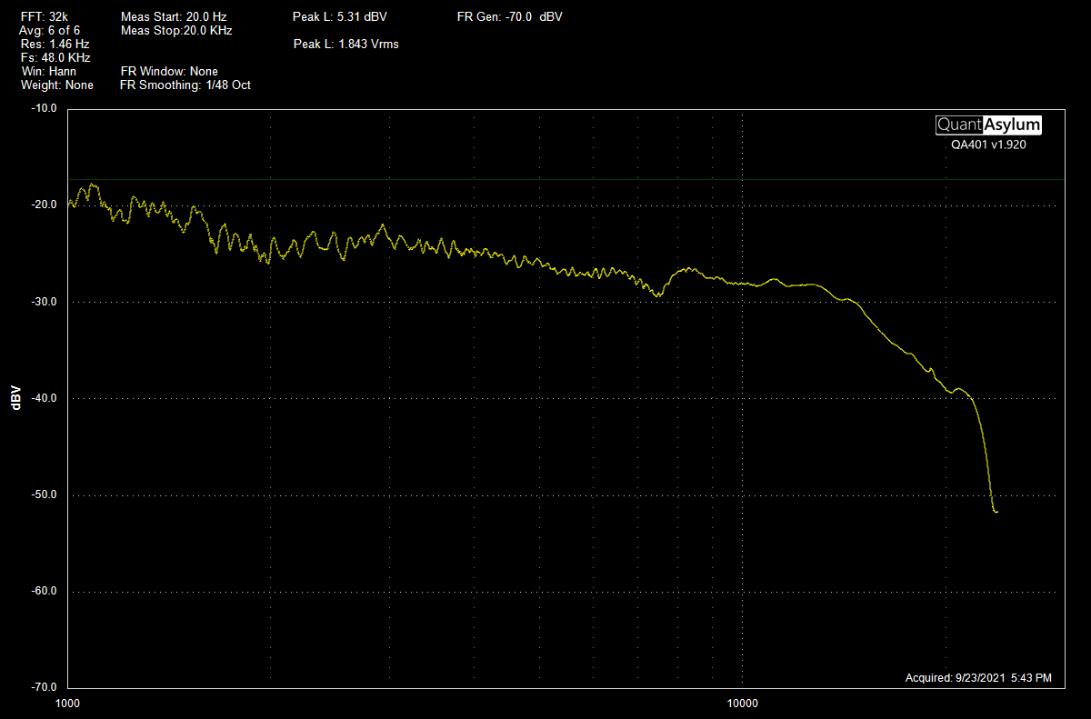

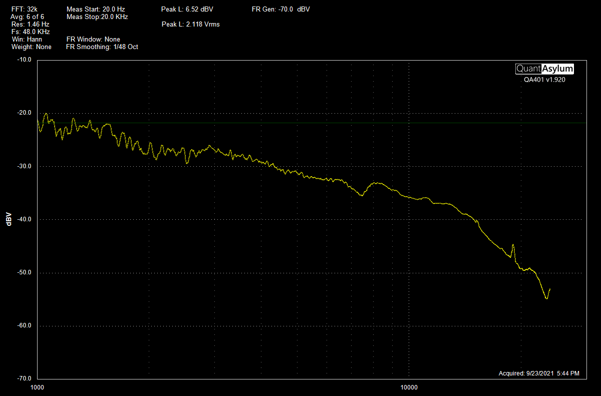

For grins when I first saw the saw teeth in the AP impedance plots I had much the same kind of thoughts.
Thinking noise I repeated the impedance sweep thinking that noise being random would tend to average to lower values. What happened was that the saw teeth appeared over and over again at the same magnitude right on top of each other on an repeated test sweep.
Then I repeated the AP impedance test sweep with everything the same but with a dome tweeter. All the saw teeth disappeared.

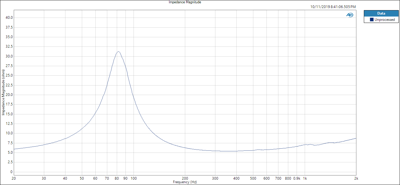

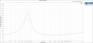

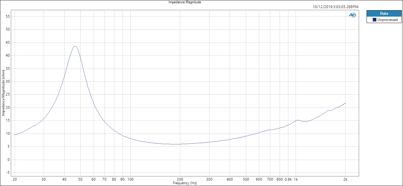

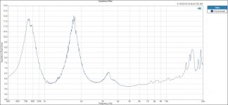

Thake a look at the attached impedance plot of a JBL2118H mid-driver that I like. Note that there are no saw-teeth.
Also see the impedance plot of a JBL2226H woofer. Note that there are no saw-teeth.

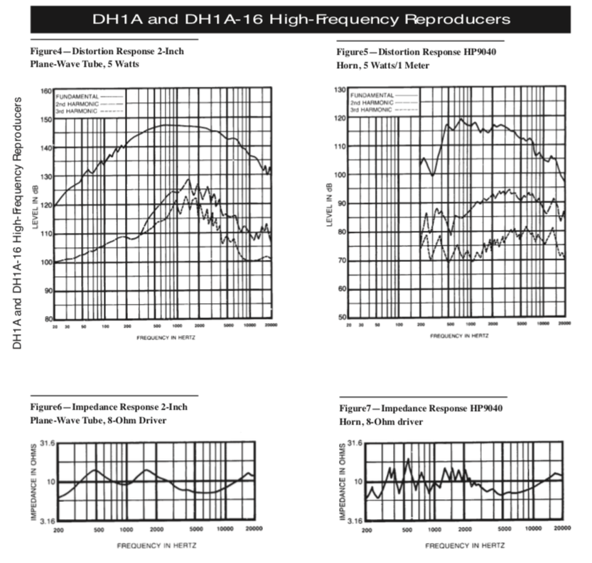

The JBL 2385 or 2380 horns exhibit several impedance peak/dips regardless of the driver used, though the 2450 driver has more than the 2445.
The EV DH1A on a HP9040 horn, which has even more "pinches" and transitions than the JBL 2385 or 2380 horns shows a far more ragged impedance response, though I suspect EV also used less smoothing or more data points than the JBL images.
Would you anticipate 30PPI reticulated open cell PU foam would reduce the impedance peaks/dips in those diffraction horns?

It might have a small effect, but probably nothing major. 30 PPI is very open and not a very heavy damping. I see little or no effect on the input impedance from its use. Best is to get rid of the diffraction issues.

I didn't realize that two drivers on this horn yielded the same problem. That is curiuos, unless the horn had a crack in it. That might do something like that.
My only point is that I never ever have trouble with electrical impedance measurements. They are always clean. I can't say exactly just what this is, but it just doesn't seem right to me. Especially because of how close together they are. If the AP does coherence then I would certainly check that.
