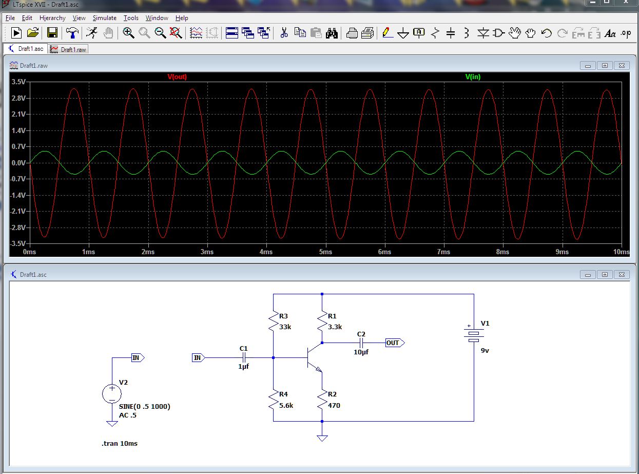

Yes, otherwise known as a transistoris there a nexus or junction point or special component in hifi amps in which the AC and DC are channeled towards eachother and are combined in readiness to carry on their journey together through the pcb's circuitry ?
so, for instance, mains power comes in from one source/direction and the signal/music comes in from another - is there a nexus or junction point or special component in hifi amps in which the AC and DC are channeled towards eachother and are combined in readiness to carry on their journey together through the pcb's circuitry ?

The attached thumbnail shows an extremely basic transistor amplifier, the general building block on which all amplifiers are made.
The DC power to operate this circuit comes from the battery (V1) on the right.
The AC signal comes from the signal source (V2) on the left.
The transistor in the center and it's 4 resistors take that signal at IN, with a small current, then amplify it producing a larger current, drawn from the battery and sending a larger version of the signal to the OUT pin in the drawing.
The graph at the top shows the small input (green) and larger output (red) taken from the IN and OUT pins.
That's what amplifiers do.

No. You really need to acquire some basic knowledge of three-legged critters. They make up the vast majority of active elements you'll find (whether transistor, JFET, MOSFET or vacuum tube), and all they are is a variable conductance, controlled by either a voltage or current.Great information - ok, I know I promised no more questions but this is directly related to the previous one.

In a water analogy (which goes pretty far), they are a valve - and you'll find that in the UK, vacuum tubes are actually still being called "valves". The load resistor is equivalent to a pipe of a certain diameter. Now by controlling the valve, you can control the water level in between with relative ease. Turn it up, water goes down - turn it down, water goes up. Turn it it down all the way, and water goes to maximum. Turn it up all the way, and water level approaches its minimum, depending on how plentiful the supply is to begin with (load resistor value) and the valve's capacity (parasitic resistance etc.). The friction of the mechanism will even model input capacitance!
DC vs. AC is a purely artificial distinction for simplicity's sake. You are never, ever going to stumble across a 100% true blue DC voltage out of an ideal voltage source anywhere in your life. Real DC voltages get turned on and off, have some degree of ripple and noise on them and may drift over time.
