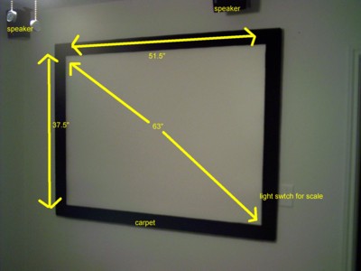

what i did was buy a 48"x60" sheet and cut it a little bigger than screen size. then built a VERY thin frame from poplar (lightweight) wood of the 3"x1/3"x48" variety. i then covered the frame with CHEAP black carpet ($6 a foot) from lowes. then i screwed the plastex onto the frame from behind. using picture wire, i simply hang the screen on two spaced picture hangers. the result is a nice, cheap screen that can be removed. you can keep it under your bed, and place pictures on the hangers when the screen is not in use. (keeping girlfriend happy)
check it out- all under $30 total

qwkbird, that is a nice looking screen - the best thing is it is ultra cheap.
I built one or two rigid screens along similar lines , but using white spray-painted hardboard, about 1/8" thick with a matt black painted border around the outside. The paint option allowed me to experiment with silvering the projection surface slightly to increase the gain - but ended up with too much glare.
I had to abandon rigid screens after a while because of storage issues when not in use - the surface got scuffed and marked too easily.
