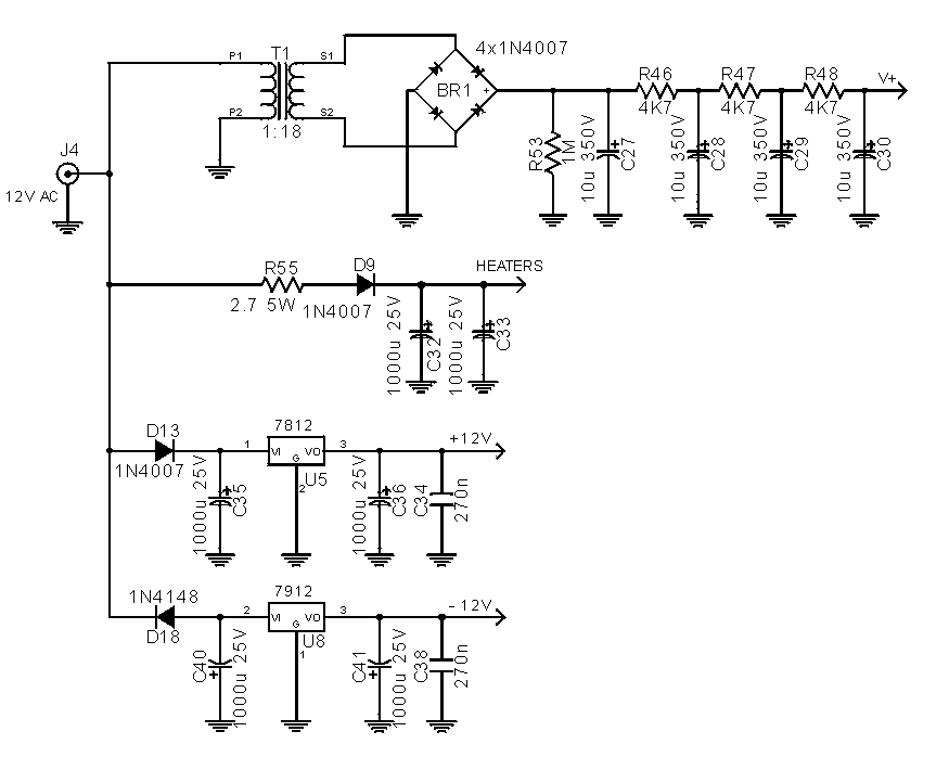

There's 3 basic techniques I have seen or heard about used on high voltage pedals: (1) feeding the box a high voltage (could be AC or DC) from an external transformer; (2) feeding the box a low voltage AC supply and having an internal step up transformer; (3) feeding the box a low voltage AC supply and having an internal voltage multiplier ladder.
A very popular trick is to feed the pedal 12V AC from a wall wart , mount inside a small conventional 240/12VAC transformer "backwards" so as to get 240VAC again, use same 12V to feed 12AX7 filaments and rectify them half wave to get raw +/- 16V DC to feed Op Amps, which can be further regulated.
Very clever.
Here's the Mesa Boogie V Twin pedal supply: +300V DC for the tubes, +12.6V DC for the filaments, and regulated and clean +/-12V for the Op Amps and Logic .
All from humble 12VAC .
