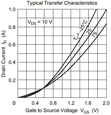

My main complaint about the irf devices is that they tend to be unstable in CFP configuration. In spite of the fact that their input capacitance isn't really that much bigger than the Hitachis.
Once you get them in a EF-like set-up, they are fine stability wise.

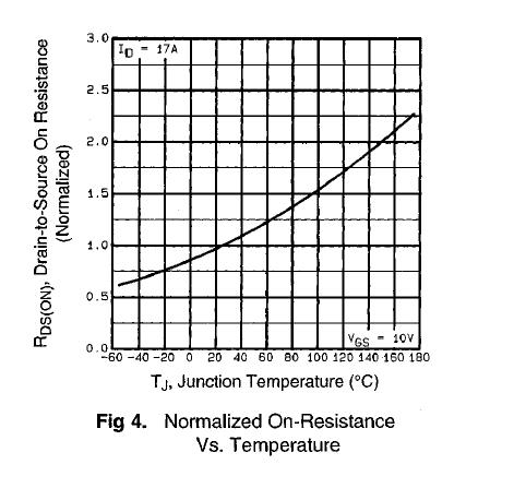

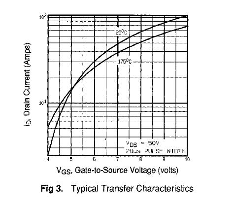

I think the susceptibility to thermal runaway increases significantly with the bias current, especially since one or two Mosfets start hogging current more as you increase it. The IRF Vbe multiplier would be great, if the thermal coupling was perfect. With imperfect coupling I found the bias would just increase all the time.
I would try the BJT at a lower bias and watch the current through the hottest output device very carefully. If you play loud music for awhile then check the current again after stopping it, the current should be the same or slightly less (not much less).
