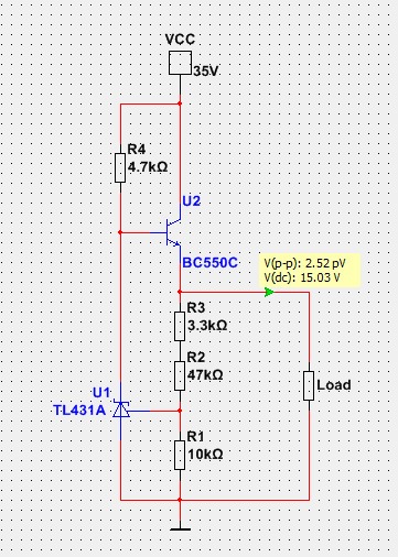

The circuit you designed is fine, but let me suggest replace the zener with a TL431 easily converting it into regulated and with much less internal impedance and better PSRR at the expense of some cents more in components.
This is how you can use TL431.
It keeps the voltage stable and the result is rather clean approximate 15.0 Volt.

My load will be 2 NE5532 OP-Amps in the phono pre-amp. I doubt it will ever see more than 20-30mA.
But I DO have a decent selection of some other higher-power transistors in my trays (including a few dozen various TO126 style).
The higher the beta of the pass transistor at the operating current, the better the regulation.
So a smaller transistor should work better in this circuit, given its power limitations.

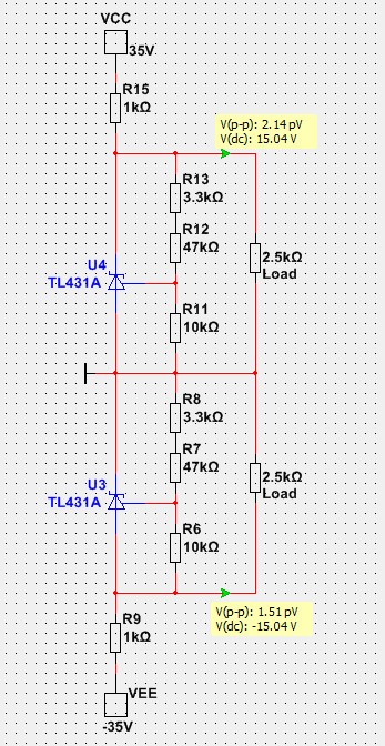

The circuit is fine except a Zener current 10x the base current would be excessive, and 28x way too much. I recommend Rs = (26-15)(load current/beta *~2) = ~5K or more, maybe 10K. This circuit is a regulator, just not highly regulated. Super regulators are mostly useless in an application like this. But this app is a perfect job for the standard 3 terminal 15V regulator chips 7815 and 7915. If you know the current is 4mA, you could just use a 2.2K dropping resistor and a filter ~100uF capacitor. Putting Zeners directly on the op-amp supply is typical, with no pass transistor, just dropping resistors. I have used op-amps on a raw supply with no sign of noise in the output because op-amps have very good power supply rejection ratio. Blasphemy to some, I know. Supply noise on the output is more likely due to bad grounding, which a supply filter will mask. So I would use 1K resistors and 15V Zeners, and a 100uF caps for up to 10mA op-amp current, ie no pass transistor required, or 7815 and 7915.
Updated my design as mentioned by stocktrader2000 and integrated the entire zener/resistor directly onto my phono pre-amp board since I already had the bypass caps soldered to the board.
Ran it for a couple hours last night and monitored current and temps.. all sounds great and absolutely dead-silent.
