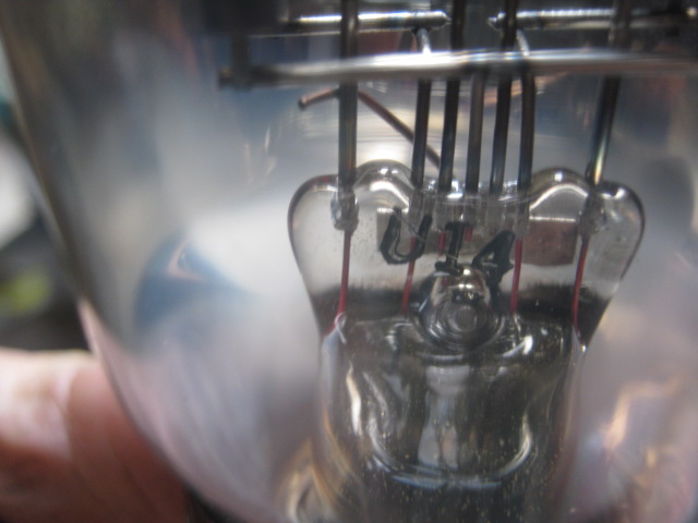

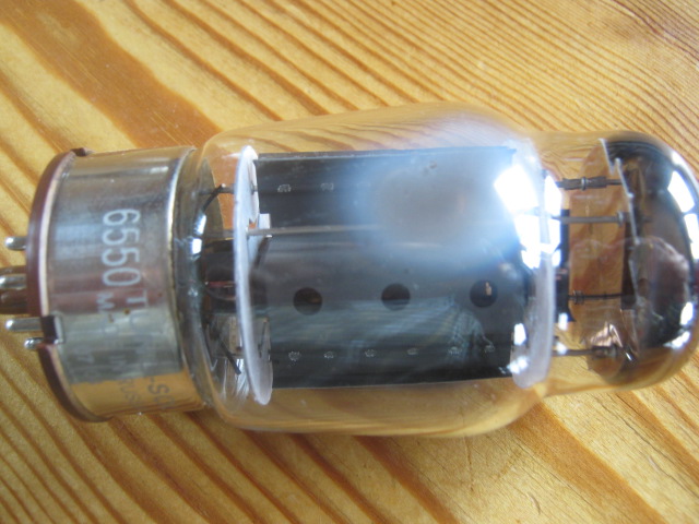

In the pics, #24-25 the view of a side getter of a TungSol New Edit 6550 tube which has only done 300Hrs under thrashed conditions; a getter in this condition indicates the tube is past it's peak. The anode dissipation has been exceeded, the grids strained but looking at the condition of the top getter between the upper mica cage and the inside envelope would indictate nothing was wrong.
Those of us experienced with tube amps, can say with fair certainty what life is left in a tube by carefully examining the getters. SOme tubes don't have side getters i.e original EL34 pencil types, but many tubes have been culled from amps which still had a good life left in them. There is no rule of thumb; it depends on the operating conditions. The cue is often to take tubes out of hard pressed amps and fit them into amps with lower dissipation and power. If the bias/current statistics are stable, one can be suprised how much life is left, sometimes years.
Pics of a KenRad 5U4 from 1955; (#33-35), looking near the neck at the getter low down is good, nothing amiss.
Looking at the getter from above, one gets a different picture, misleading due to reflections. This rectifier is 100% fine.
