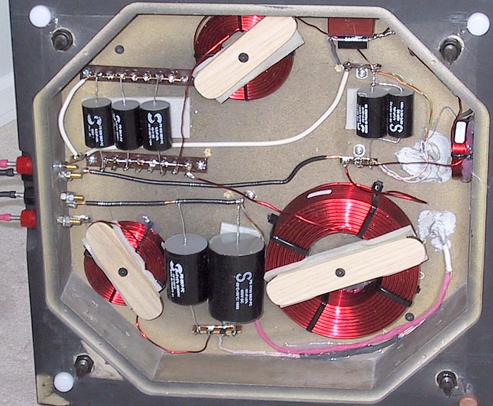

The thing about passive crossovers is that you first have to establish the frequency and impedance curves of each driver (trusting published graphs is arguably a wild card), figure out if you need any resistors to match efficiency levels, then calcuculate the reactive components, build it, and then measure with pink noise or sinewaves and an RTA or spectrum analyzer or O-scope to see what each driver is then ACTUALLY doing. I've never had it come out accurate based on theory alone (I've built dozens of speaker systems over the decades). Then fine tune the values, and try both phases for the tweeter to see which has the smoother transition through the crossover frequency, and only then can it be considered well done. It's not even enough to know the driver impedance at the crossover frequency, because the impedance curve is often not at all flat in the adjacent frequencies, and that throws off how the reactive components will operate.
FWIW, the last couple of very successful passive crossovers I've been involved with were designed using LinearX LMS/LEAP software.
Ground-plane semi-anechoic measurements -both gated and not- were taken of the drivers in the actual enclosures and with damping fill levels to be employed. Modeling is great, but I think this is the only way to include the effect of the enclosure on the drivers' real world performance that the networks need to "work with/ around" .
The combination of the FR and impedance measures were then used, along with published rated X-max /power handling, and an intended crossover point to iterate the required values to achieve desired results.
My favorite so far was the parallel LR4 scheme for a big Alpair MTM that had previously been actively bi-amped. A series network was designed for the same system, but -perhaps as it gave much better control over the LF roll-off of the A7.3 - the parallel worked much more to my liking.
No in room measurements were taken after construction - just listening.
Of course, a minidsp / biamped & DDRC system would very likely outperform this, particularly with the Dirac correction, but I've not got to that point yet.

I want to second what chrisb says above. Published graphs of speaker drivers are usually done with the driver mounted on a large wall facing into an anechoic chamber. While that has value, it's very different than how any driver will be used in the real world (baffle step).
Building a speaker system that is sloppy but OK for most people isn't real hard, but building one that is excellent is MUCH harder. Personally, I'm much happier with 4th order active crossovers (put ahead of the power amps) that include low bass EQ feeding closed box woofers, so the acoustic response is flat and tight down to 30HZ. The amount of time it takes to get a passive crossover properly calibrated can be as much as the time it takes to design and build an active crossover chassis and obtain another poweramp. For several reasons, the latter is pretty likely to sound significantly better.

One solution that worked very well for me in many cases:
If you use a 5-8" woofer that has a natural rolloff shortly after the intended X-over frequency, and say a 1" tweeter with low enough Fs (around or below 1kHz), then use an asymmetrical crossover, 2nd order low-pass (or 1st order with Zobel), and a 3rd order high pass, with inverted polarity tweeter. In most cases it sounds, and measures above expectations. Of course you need to "fine tune" the values empirically, but it is easier than it sounds, with white noise, and a few good recordings.
