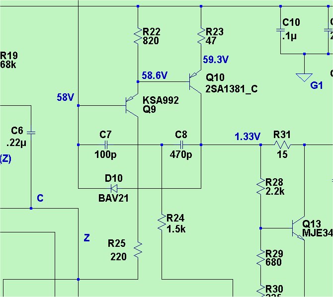

What I want to point out is that TMC feedback is some kinds of short cut. It partially skips the input stage, directly feed into VAS. If the simulation is not too simplified. The miller effect on input transistor will take some place, and you will see the difference on bode plot.
Both TMC and TPC are using RC network to switch feedback path. Did anybody try to use LC instead of RC network? As my first calculation, the required inductor values is about within tens of uH. That is completely do-able!
Nice idea. There are at least two possible variants of this:
  1. Replace TMC resistor with an inductor, say 100uH.
  2. That, and also replace the TMC capacitor (facing the VAS collector) with a resistor, say 470 or 820.
Spice suggests that both topologies can run stably.
(2) has worse distortion performance, relative to TMC. I guess it's really a nice feature of the TMC capacitor that it almost vanishes from the circuit at audio frequencies, and we lose that by replacing the cap with a resistor. I suspect the resistor is loading the VAS too heavily and contributing to this distortion; not sure.
(1) has equally good distortion performance as plain old TMC. I had to include a small resistor in the network also, to improve stability and avoid ringing. 100 ohms can work, in series with either the inductor or with the TMC cap.
