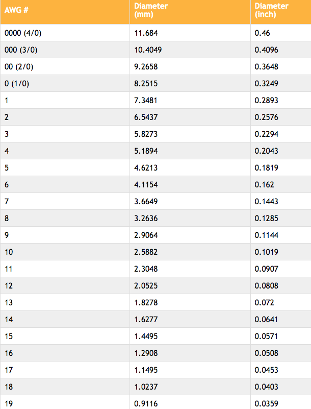

9 AWG (American Wire Gauge) is about 3mm (.1144 inch) diameter for the wire itself, jacket size varies considerably.9AWG wire (8 mm diameter) is nonsense inside a home/HiFi speaker cabinet.
8mm wire diameter would be around AWG "0" (1/0) "One Aught", generally used for arc welding, household mains power connections and the like.
That said, 9AWG is still more than needed for any short speaker hook up.
I've used 10AWG for 120 foot (~37meter) 2 ohm speaker runs, and it was on the light side for performance (but heavy to coil up..), but the 14AWG internal cabinet wiring was plenty.

8 AWG about equal to 8mm2 in conductor cross sectional area.
Kind of says itself once you encounter sectoral conductors (triangle" shaped), that is fairly common in larger sizes.

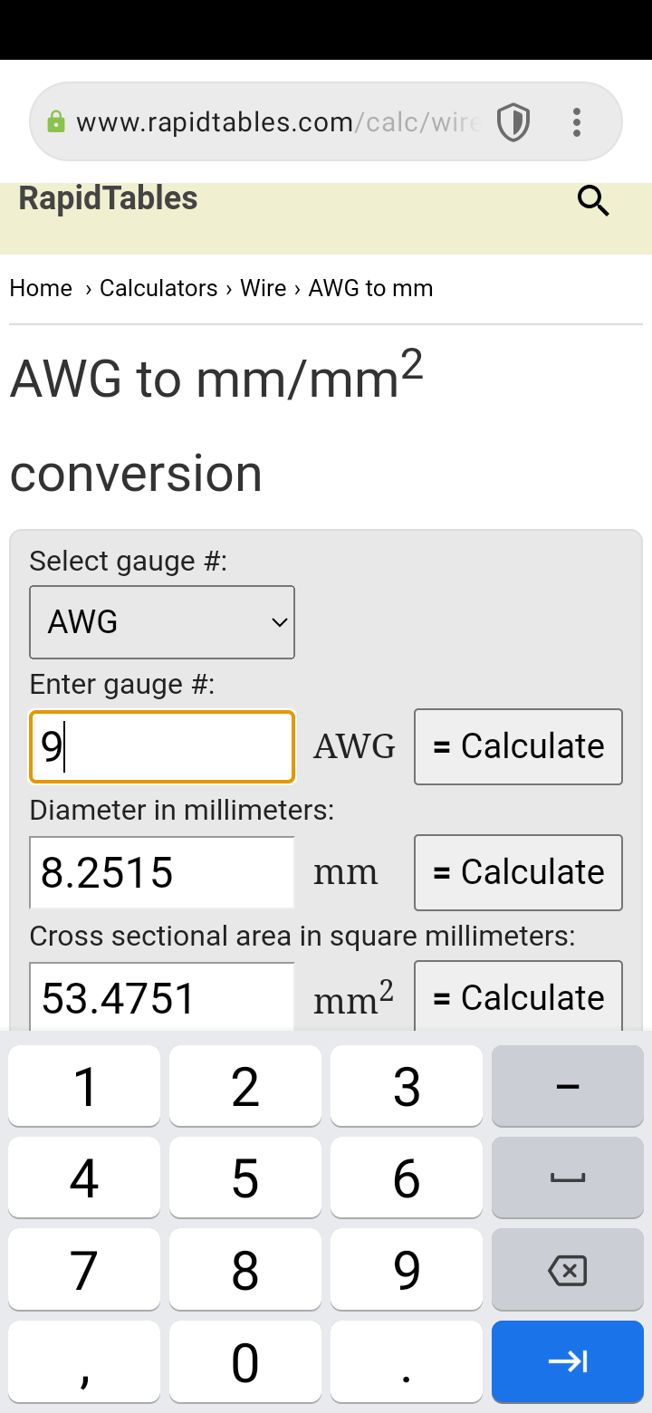

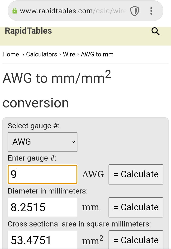

I do not use AWG at all (in fact I hate that scale), being a dyed in the wool Metric, so I used an online calculator.
https://www.rapidtables.com/calc/wire/awg-to-mm.html
Which gave me:
WTF?
I trusted it because first I had checked the only AWG value I know by heart, since it's so widely used, 18AWG which is almost exactly 1mm (now that is a nice round number 😄)
It gave me what I expected:
That said, I trust you of course.
Now I am thinking maaayyybbbee I didn't fully reset some earlier calculation or something similar and calculator spit some old number it had in memory.
Well, 3mm is more reasonable, in any case still too thick for my taste.

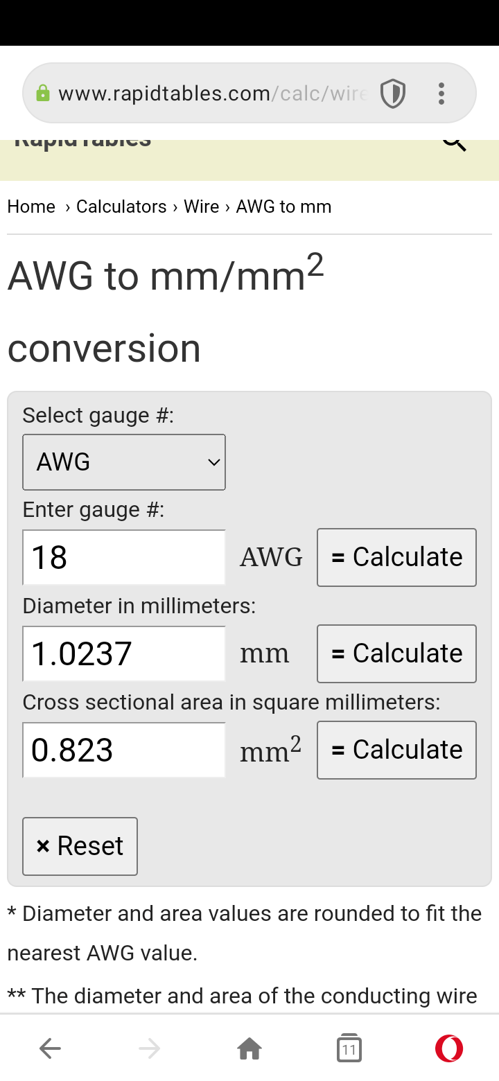

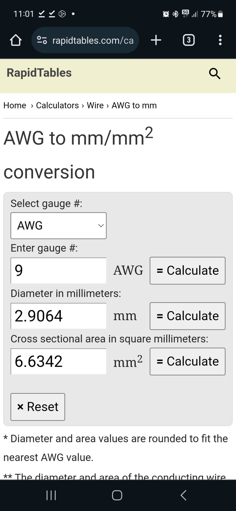

Same here, but as you can see, that is the first value calculator spit out, so I used it.The standards are mm2 and AWG. Diameter in mm is not normally used for conductors and wiring when looking for electrical characteristics

It's the calculator having a error or something.Now I am thinking maaayyybbbee I didn't fully reset some earlier calculation or something similar and calculator spit some old number it had in memory.

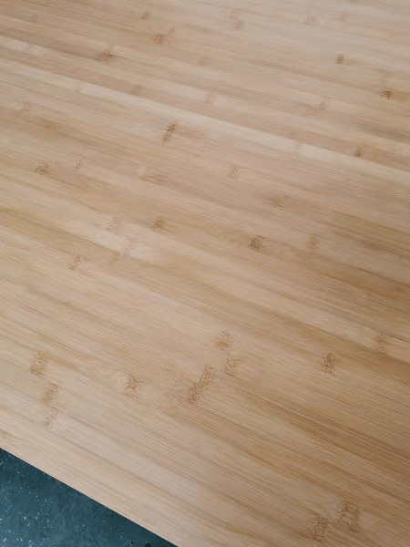

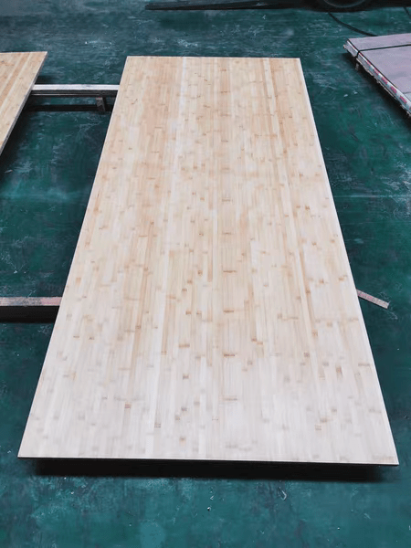

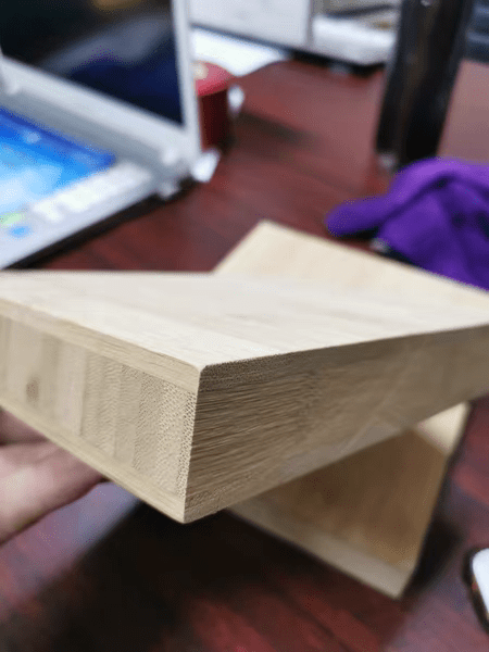

Are you hesitant about using the bamboo board? I've used 3/4" thick bamboo board on several speaker builds and like it very much. It machines nicely and can be finished either naturally or with stain. There is a 3-ply type of bamboo with a fairly thick center core that's not, but the outer two parts are pretty thick too. My current build has a solid 3/4" thick bamboo baffle and the rest of the cabinet is 18-mm Baltic birch plywood that I've applied bamboo veneer to.The wood vendor has just told me their Bamboo board isn't really a plywood, it is actually as n annexation of small pieces of bamboo and turned into a larger board.

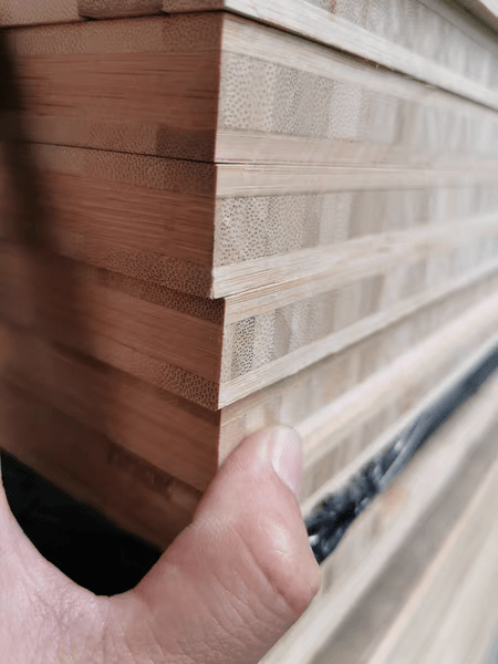

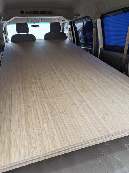

Here are the bamboo board from the supplier, and they claimed that those are not bamboo plywood but bamboo annexation.Are you hesitant about using the bamboo board? I've used 3/4" thick bamboo board on several speaker builds and like it very much. It machines nicely and can be finished either naturally or with stain. There is a 3-ply type of bamboo with a fairly thick center core that's not, but the outer two parts are pretty thick too. My current build has a solid 3/4" thick bamboo baffle and the rest of the cabinet is 18-mm Baltic birch plywood that I've applied bamboo veneer to.
Paul
Can I have it for speaker cabinet?

...those are not bamboo plywood but bamboo annexation. Can I have it for speaker cabinet?

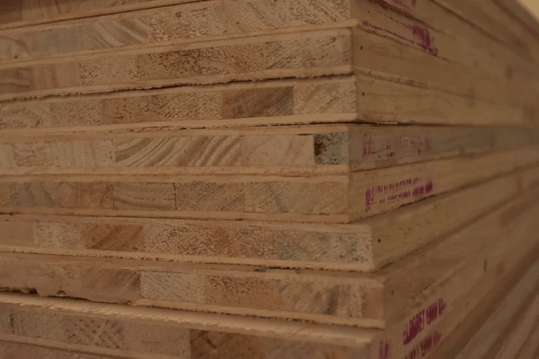

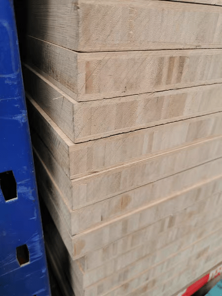

The bamboo amalgamation looks like the blockboard which is commonly made from ordinary wood (see image below).
Blockboard is not recommended for speaker cabinet construction as it often contains voids (empty spaces).
There is a possibility that your bamboo blockboard may also contain voids. You would have to do some investigative surgery on a sample.
I think they have a point.Here are the bamboo board from the supplier, and they claimed that those are not bamboo plywood but bamboo annexation.
Plywood is made out of HUGE (many meters long, up to 5 or 6 meters wide if they want to) very thin (1-2 mm thick) wood sheets "shaven" from huge tree trunks, sandwiched and glued together.
Physically impossible if you start with bamboo.
So only option left is to crush it into larger or smaller bits, I am thinking pencil size at best, and press/glue them together.
IF they call that "plywood" it's an unfortunate choice.
If they aim at that market (I guess they do), they should have called those boards "plywood substitute" or "equivalent".
In fact, the proper name would be "bamboo chipboard", only the word chipboard carries a stigma 🤷🏻
But "aggregation" means the same, so.....
Or they could have called it "bamboo OSB" .... almost as bad.
