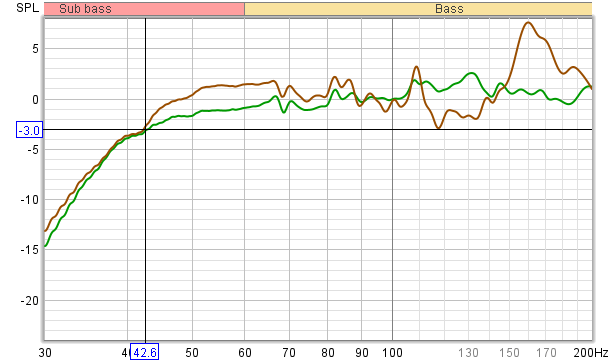

Here's the results of some recent measurements I took, same driver driven by the same voltage, used in my POC3 TH and my new POC7 ODTL design. Fb for both designs is pretty close (within 1 Hz). The TH is 1~2dB more efficient over part of the passband. However, the POC7 has a much wider useful passband (the TH is pretty much unusable above 100 Hz), and the ODTL box is smaller, and the rolloff to Fb is shallower. Output is pretty much the same at Fb.
An interesting thing to consider here is that, if I made the ODTL larger, the efficiency around Fb would be increased, which means output at that around that frequency would be better than a TH of the same volume. In-band efficiency however is set primarily by the driver, so in-band efficiency would still be less than the TH, but not much less. The TH should have better power handling within the passband however.
