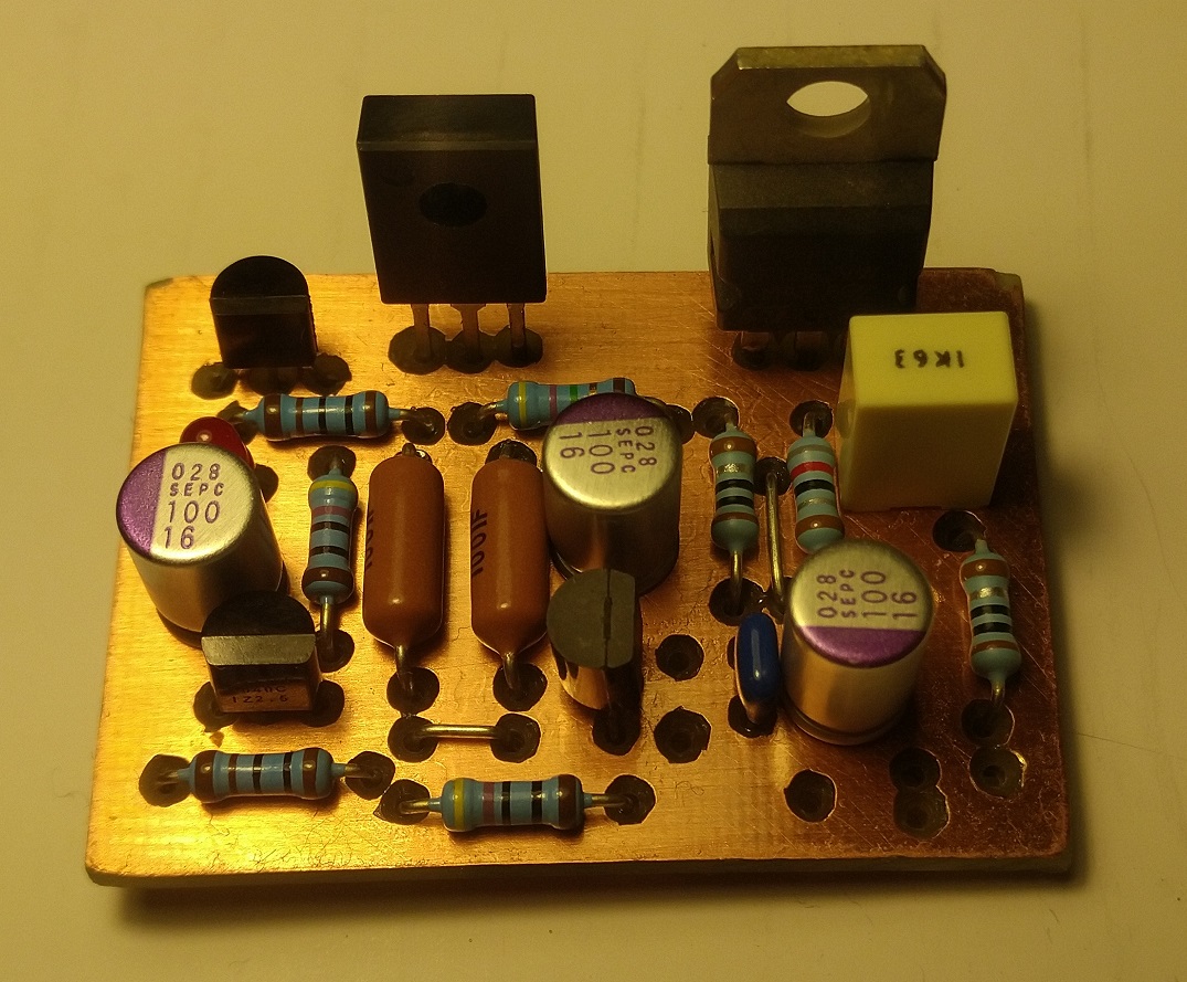

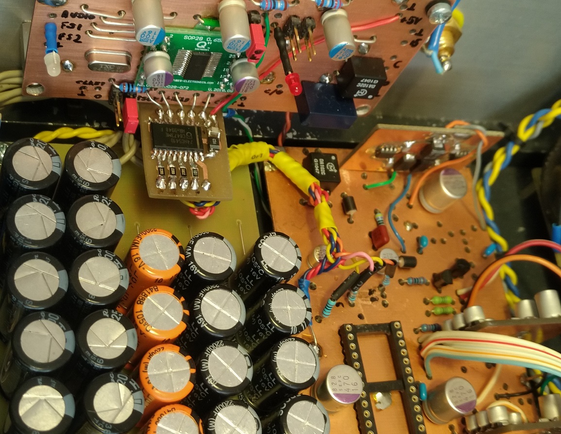

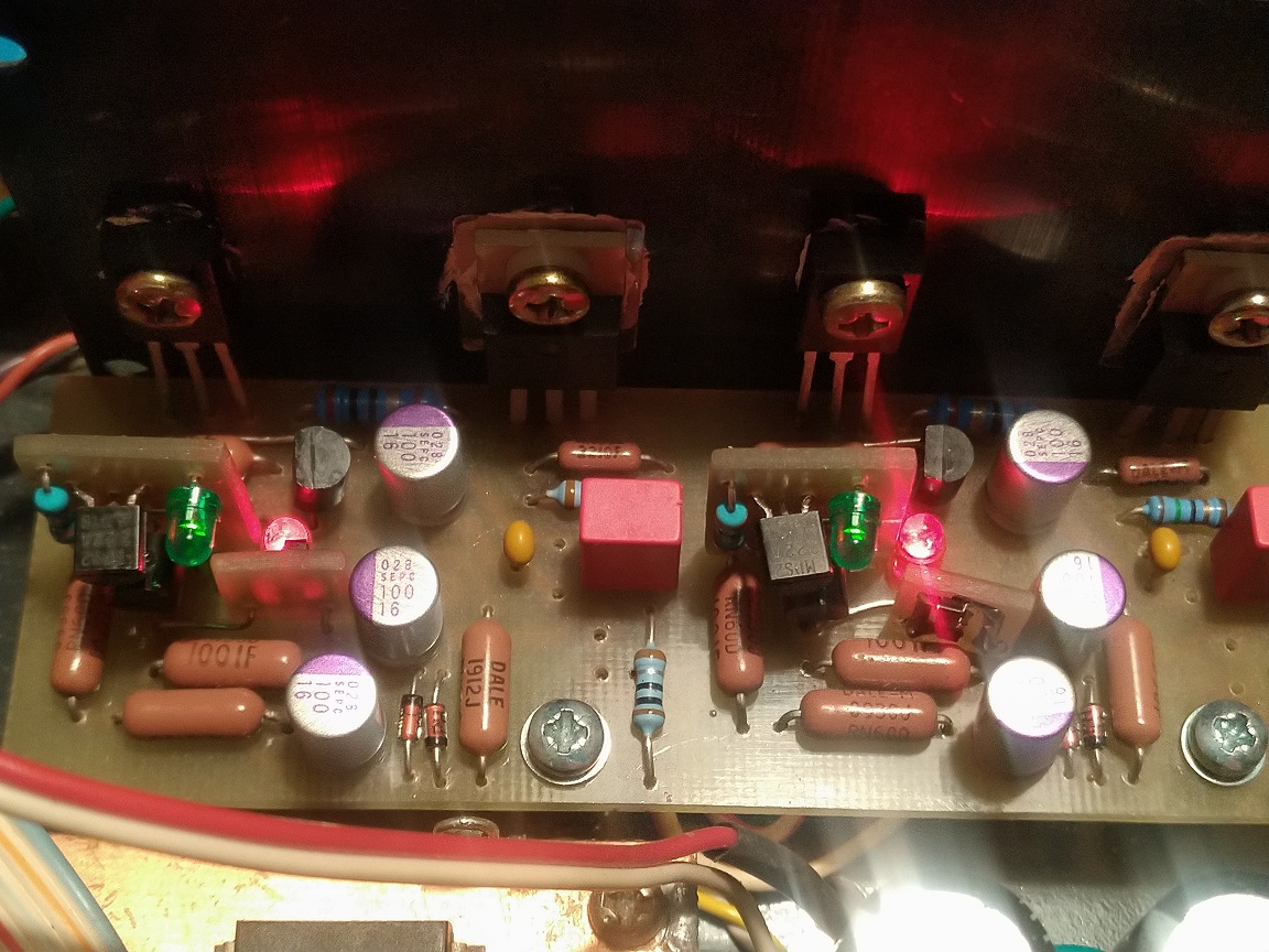

In my DAC (DIR9001-PMD100-PCM1702) I have five separate power supplies (five secondary windings), one with three ADP7181 for DIR9001 and digital selector, two separate with ADM7150 and Walt Jung shunt regulator for PMD100 and one double for +/- 5V for PCM1702, the regulators are also Walt Jung shunt.
It is certainly better to separate as much as possible, especially analog from digital sections.
I recommend the Walt Jung shunt regulator to power digital circuits, especially the dac ICs .

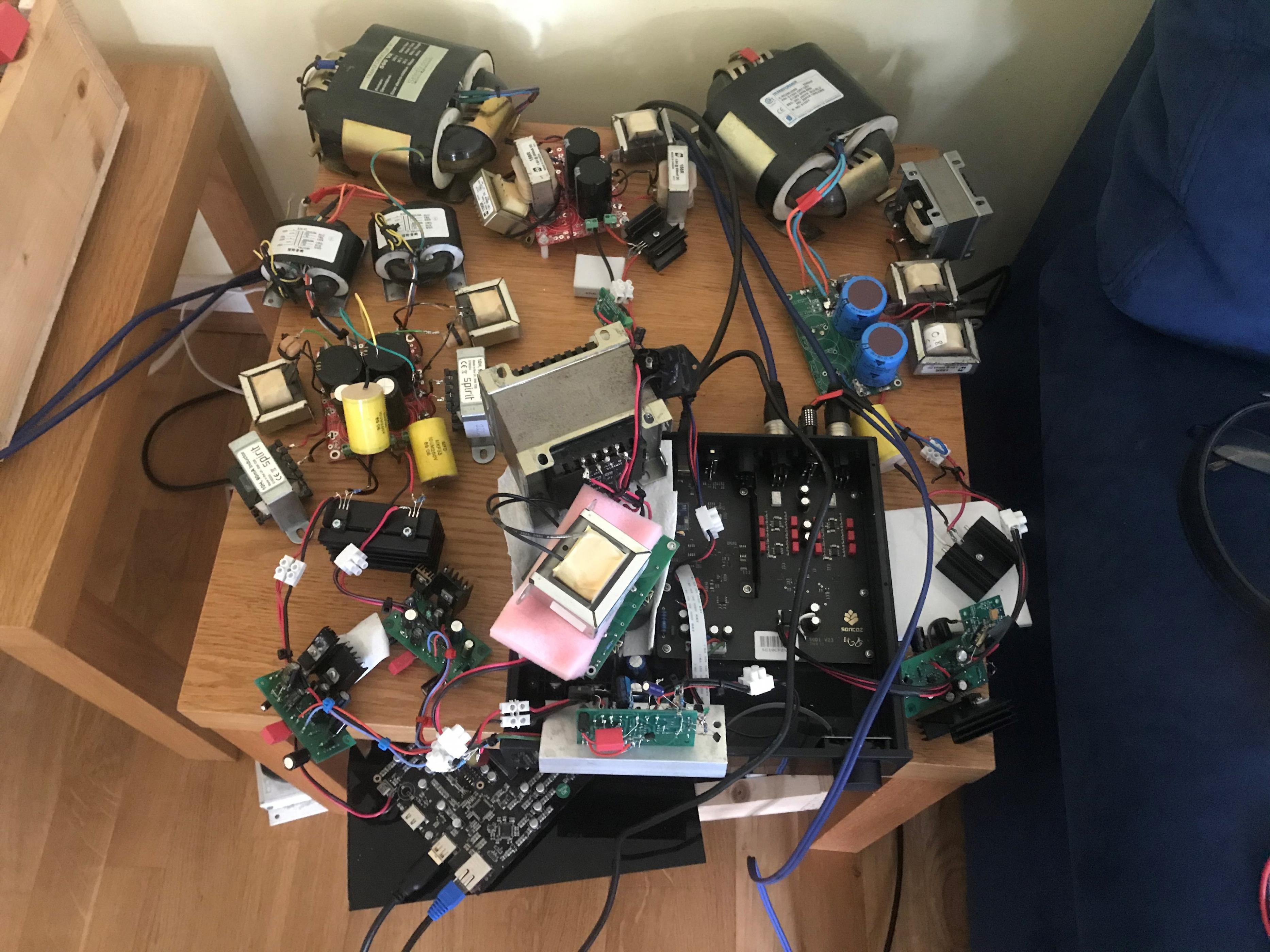

I agree wholeheartedly with grunf above. It surprises me that no-one has yet measured (or been able to measure) the obvious sonic improvement brought about by separating supplies even though this is commonplace in high quality commercial equipment. I recently bought a Soncoz SGD1 and have separated out each of its supply feeds resulting in the best DAC I have ever heard.
I would recommend the Jung super regs, both shunt and series versions. The series version is available from the DIYaudio store. These offer lower noise, lower output impedance and better line rejection than other regulators that I have tried. I would also recommend a separate transformer winding for each and an upstream cap multiplier for each regulator. The only down side is then the need for higher voltage transformers and more space.
If you are able make the changes incrementally, listening at length after each you will be convinced of the benefits. I find this very rewarding. Suggest you start with just one well built super-reg feeding both loads and then double up on the regs and separate the loads.
Be warned though, you could end up with something like this...

I have tested a lot of regulators in my DAC, Salas shunt, ADM7150, ADP7181, WJ serial and shunt and various other regulators.
Those that sounded the best attenuated the HF noise the most, which can also be seen on the oscilloscope.
It is important that the regulator is as close as possible to the ICs, that it has a CRCRC filter before the regulator itself and that each regulator has its own secondary on the transformer.
In my opinion, the winner is the Walt Jung shunt regulator which is not something popular on the forum, probably because there is no kit or PCB on sale.
The ADM7150 and ADP7181 are also good, especially the ADM7150 and can be used for input receiver and auxiliary circuits (clock, filter, ..) or possibly the DAC ICs themselves. Salas' shunt is OK, but it's not in the range of WJ shunt or, say, ADM7150. The WJ serial regulator is more for powering the analog section, I wasn’t happy with it when I tested it around digital.
For the DAC ICs itself the best is WJ shunt, especially the analog section, I now use them to power the PCM1702 and only to power the VDD1 filter for PMD100, to power the VDD2 output interface I use the ADM7150.
The PMD100 is otherwise great for testing regulators because it produces quite a lot of HF noise.
A WJ shunt can be made on a small PCB so it can be easily implemented in an existing device. By the way, I have been making WJ controllers for the last 15 years and I can say that they are the best audio regulators.

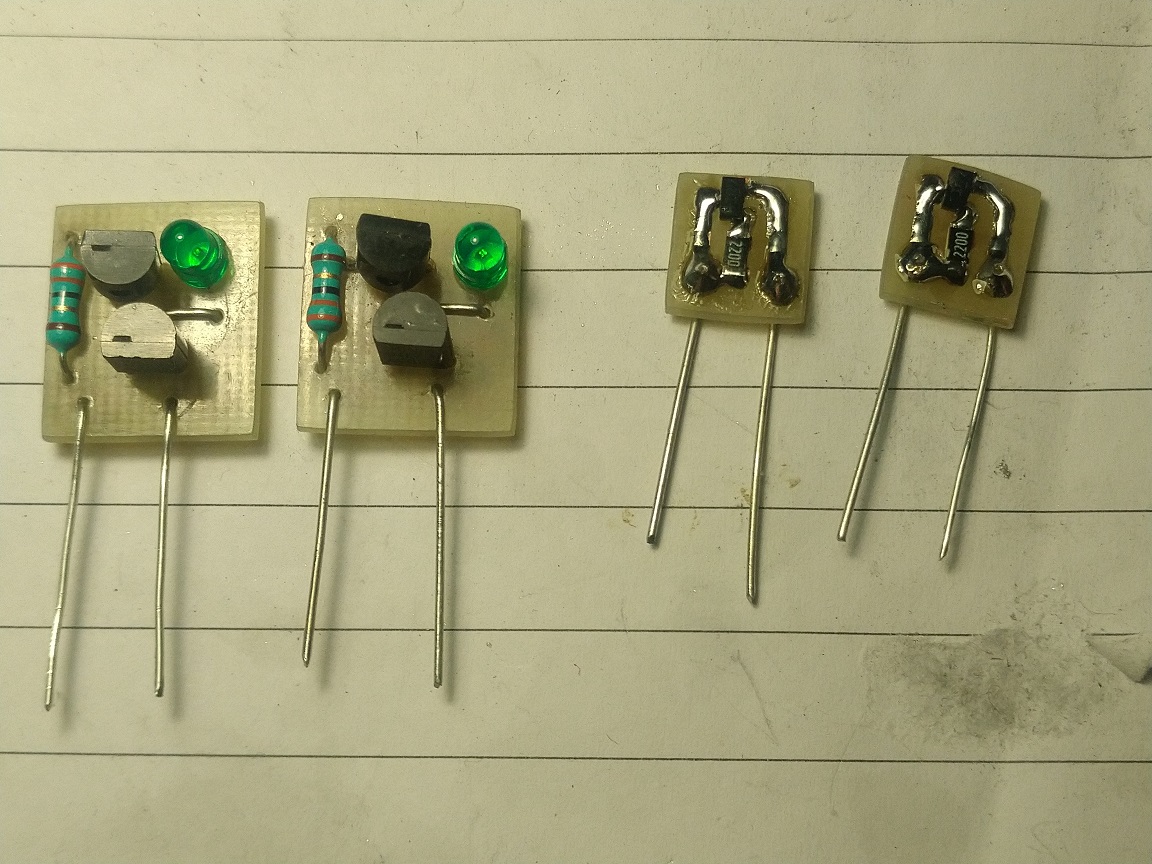

I plan to make two more DACs, one with SAA3750 + TDA1547 and the other with PCM1794, both are R2R and I will greatly use WJ shunt for regulators in them.
And not to forget the WJ shunt can still be improved, I'm just working on it and so far I have great results with 2.5V WJ LED references.
Pictured below is a WJ shunt I made for the PMD100 and a new 2.5V reference with jfet CCS for power reference.
I could have PCBs produced if there was a good interest. I would be happy if you could help me in the PCB design too, what do you think?
