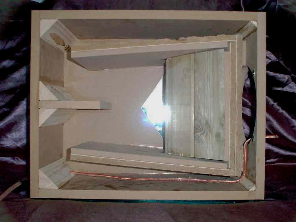

In the process of the final assembly of the Sachiko speakers. Got them up and running at the moment, but have not made final decisions on damping material.
At the moment I have two inches of Dacron batting on the top/bottom and rear wall of the compression chamber. I also inserted a think 1/2 sheet at the back end of the throat to the horn to filter out some low level vocal information that was making it out of the horn.
Trying to determine if there are any alternate damping materials that would result in better performance in this application.

One of those things that's suck-it-&-see TBH. I have no idea how you would define 'better', so YMMV. There's nothing wrong with the dacron.
Incidentally, FYI, back-horns (with a tiny handful of exceptions) do not really have a compression chamber per se. The room they are sitting in is their compression chamber. They generally do possess a low-pass filter chamber though.

Damping material is a very personal matter, its best to try and keep trying differing amounts /locations until you get the sound you like, the less the better. Ensure the speakers have broken in before trying to adjust the damping otherwise its a moving target;)
Keep damping away from the filter chamber path.
One of the main uses of damping material in most cases (such as this) is controlling reflections and to effectively control them, damping should be fairly central. Think behind the cone. I usually make a "ball" of damping material and "hang" it in the centre of the enclosure, thats where the reflections are meeting and causing the most problems.

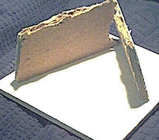

Pardon my jumping in, but I believe what hm is calling softfibre is close to what in the US is called "particle board," i.e. wood as opposed to stuffing material. I recently disassembled a German horn (an imported Einstein Rigoletto imitation) and got a first-hand look at this material.
http://www.diyaudio.com/forums/full-range/112744-soft-fiberboard-help-please-2.html
see post # 13
I call particle board a totally different material, what I refer to as particle board is "large wood chips" bonded together with glue and heat and sold in the usual 4' X 8' sheet size.
Softfibre is more like MDF which has gotten wet and expanded but not broken, IOW it is very soft and can be broken by hand.
Horst, I do not think the Softfibre would work here because it would change the chamber volume too much. I think the speaker would need a total redesign to accomodate it.

andrew you wrote (Schalmei):
"The board I get here is made by a company called "cellotex" (sp). Its also known as "hushboard" and probably other names as well. It looks similar to mdf that got
wet and expanded and breaks pretty easily."

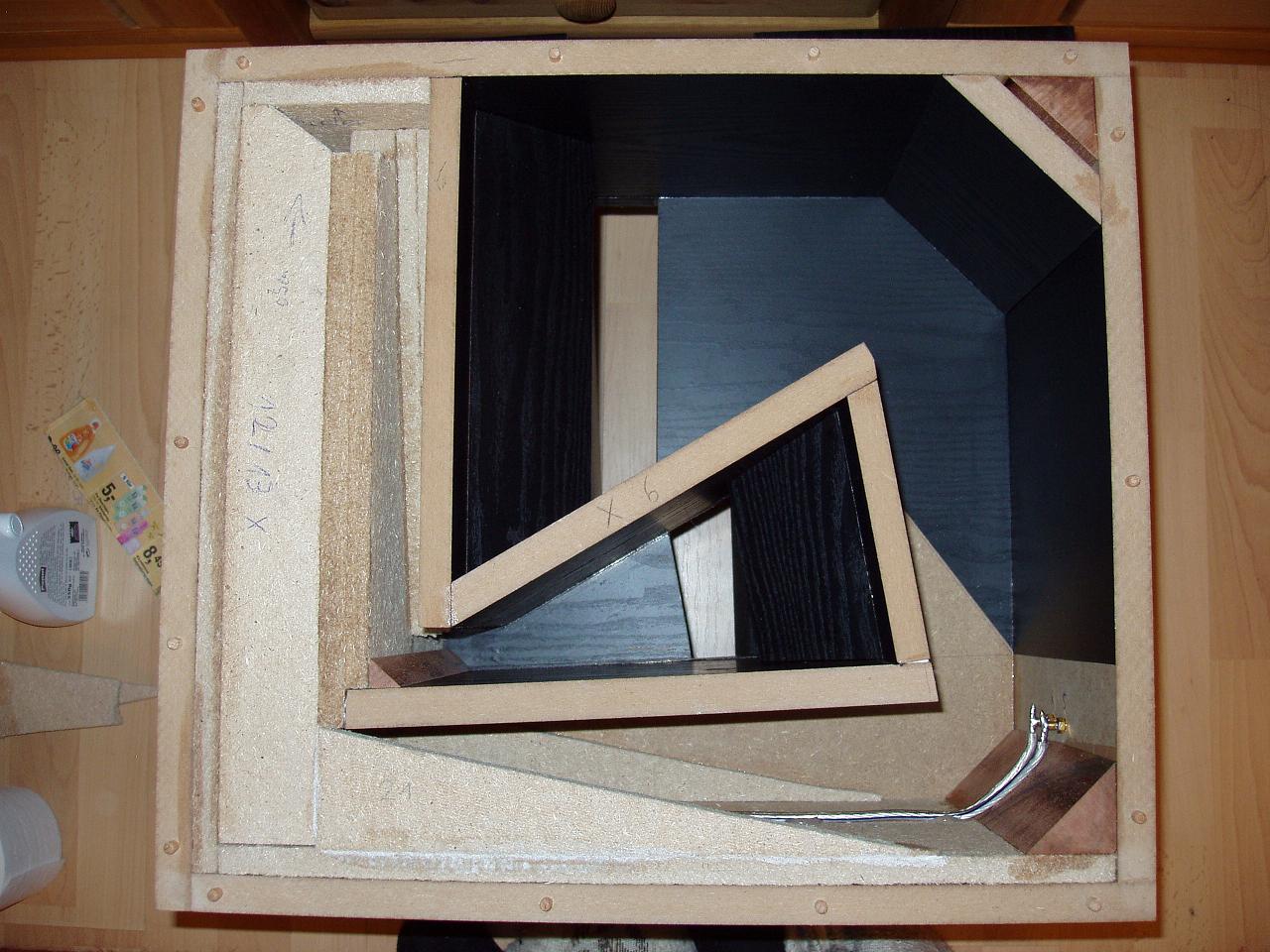

right,
here a link i hope it works in english:
Produkte Detail - PAVATEX-Standard Dämmplatten
and look at "about what" in the middle a pic, on my HP
pic
better show here:
