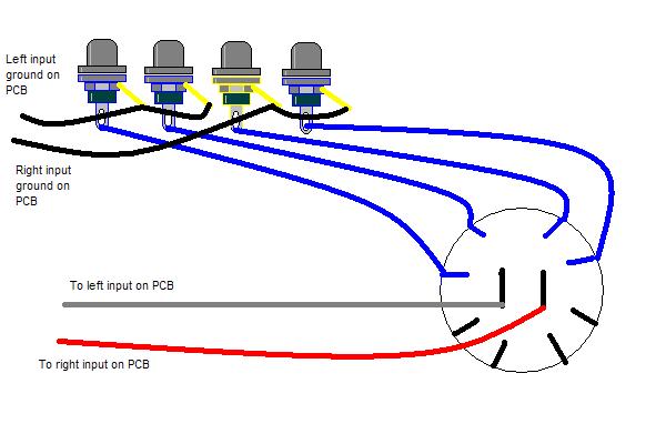

Question on building the switch into the K-12. This would be great. Did you find wiring schematics somewhere to do so, or do you have any tips on achieving this? I'm not comfortable designing something myself yet. Thanks again!

I've attached a quick diagram on the basics. I've only drawn 2 inputs but you should get the idea. The round thingy is the back of the rotary switch.
One thing to note is you need to make sure which pairs of contacts on your rotary switch are switched together for the left and right channels.
If you go this route don't solder the RCA jacks that come with the kit to the PCB. Instead solder the leads from the rotary switch and the grounds from the new jacks to those holes in the PCB where the original jacks would have mounted.
