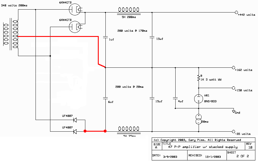

OK, I have built the power supply for Gary Pimm's PP 47 almost exactly as drawn (I used a separate 25 v transformer for the driver cathode ccs). My PT is an old Thordarson 375 -0 375. My current HV supply consists of FW CT secondaries to 12ax4 damper diodes to 1.5uf cap to 7.5H choke to 30uf cap. Output voltage is ~330. What I'm trying to accomplish is to use this transformer to construct the stacked supply of Gary's rev 10.
Sorry to leave you hanging, I thought for sure somebody else would pipe up.
If you want, you can try to build the stacked supply with the components you have. You can make a hybrid bridge with the 12AX4s and SS rectifiers. How this would look is: the top rail would be connected to the cathodes of the 12AX4's, the middle rail is connected to the CT, and the bottom rail is connected to the anodes of the SS rectifiers. Be warned that there might be some tweaking required since your voltages will be slightly different, and you will certainly need to play with the dropping resistor to get that VR tube to fire and regulate properly. I would recommend that you model this in PSUDII. The program might seem confusing at first, but becomes so easy to use after you get past the 1st hurdle.

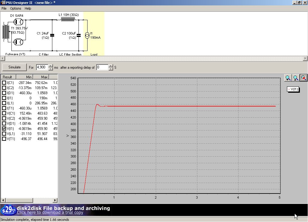

I've modeled quite a number of conventional PSs in PSUDII, so I'm comfortable with the program. I assume I would model the entire 477v range? What would be the best rectifier model to simulate a graetz bridge?
I'm planning on ordering a bunch of small to medium value caps to tweak the cLC filters and trying different values for the VR dropping resistors.
Thanks again!

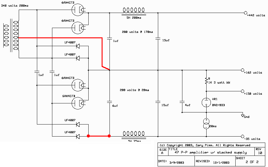

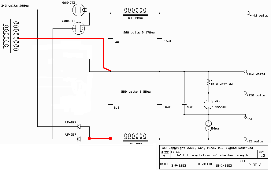

Your schematic isn't quite right: get rid of the 6AX4s and UF4007 and caps in the middle, and just leave the 6AX4s and UF4007 at the top and bottom respectively.
Sorry, I can't give you a more detailed answer about PSUDII right now because I can't run it here at work; I'll get back to you later if nobody else does.
Getting close: delete the connection from the bottom of the transformer winding to the middle rail, and instead connect the bottom of the transformer winding to the bottom 6AX4 and UF4007. The top 6AX4 and UF4007 are already connected to the top of the transformer winding correctly.
