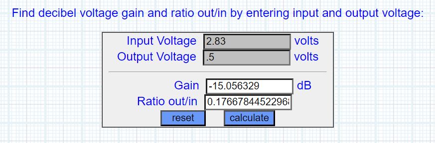

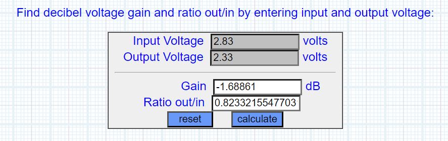

Hi, here's a good calculator for comparing two voltages http://www.sengpielaudio.com/calculatorVoltagePower.htm
Note impedance is immaterial (assumes it's held constant).
If in your example you meant the voltage difference was 0.5V such that the voltage of comparison is either 3.33V or 2.33V, depending on direction
then the dB gain or loss is either +1.4dB or -1.7 like shown.
If you meant the compared voltage was actually 0.5V, then you get this, about -15dB.
Those dB differences will be the same dB differences in SPL measurements of speaker output.
