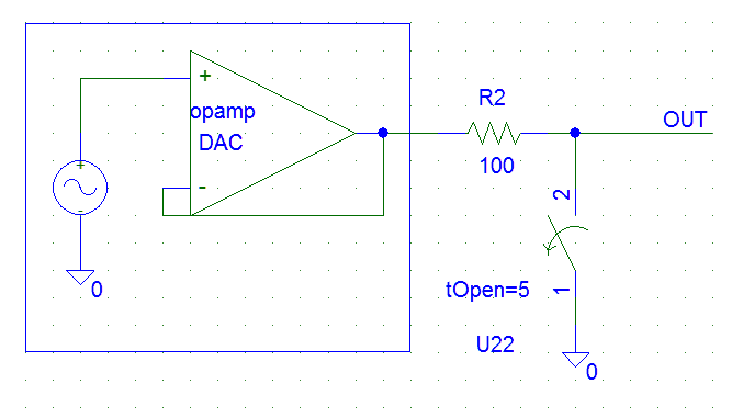

I don't use outputcaps in my Twisted pear setup, that's fine but i've got a "thump"sound when switching on the DAC.The (Ventus) LME49600 has a short circuit protection. I want to short the output with a relay for about 5 seconds before enabling the output. I don't want to put the relay in the signalpath. Can i do that without damaging the LME, or is it saver to put a resistor in serie with it. If yes, what would be the value ? Would 1kOhm be enough ?

Short circuit current for LME49600 is rated around 500mA, or a minimum of 30 ohms at 15V.
But best to have at least 100 ohms in series before the shorting relay to ground, to avoid stressing it.
Even larger (500 ohms) would still not be a problem. Don't directly short its output to ground though.

Shorting the output with 500 or 250 Ohm didn't help. .... Still wondering why it made no difference. .......
Because the DAC can drive a few hundred ohms with ease! Maybe a bit more distortion, but no useful reduction of thump.
Put the resistor in line with the -load-, and short the far side. If the relay has 0.1 Ohms contact resistance you get 60dB attenuation.

Shorting the output with 500 or 250 Ohm didn't help. I have now ordered some
good Panasonic relais to switch the signal itself. Still wondering why it made no difference.
Was the resistor in series, or in parallel, with the output?
Of course it should be in series with the output, and before the relay to ground.
See post #3.
...Of course it should be in series with the output, and before the relay to ground. See post #3.
"....best to have at least 100 ohms in series before the shorting relay to ground, to avoid stressing it.

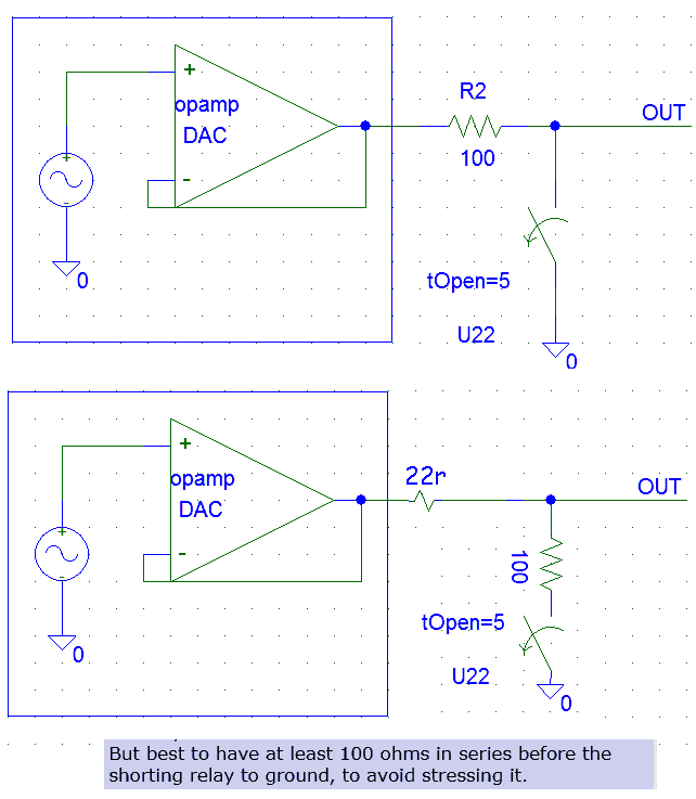

Ambiguous. Which "it" is being stressed?
Long-term circuit shorters (I was putting thumbtacks in line-cord when I was 4) will understand where a short may be applied without flame or strain. People with a less interesting upbringing may need a picture.
2nd one is not a complete mute tho. 1/5th of the signal will still get through
