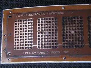

btw: Patent GB1,239,658 issued to B&W in 1971 also deals with PCB-alike stators. Which makes them already three besides Quad and Beveridge.

and solosound from the 1970, also Van medevoort had pcb stators, and yes they dont look as good as a nice coated sheet of metal thats for sure. 🙂

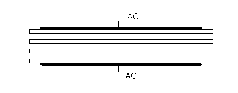

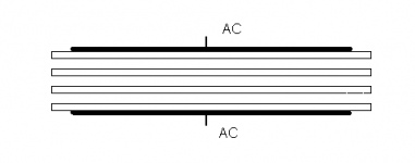

1. Corona discharge relies on avalanche, i.e. there has to be free space for ionized particle to accelerate and, colliding with other partilce create even more charged particles. Removig air voids mitigates this condition.
Solutions:
a) make the radius bigger i.e. deburr the holes in sheet metal,
b) make isolatior more or less perfect.
Without vacuum it's almost impossible to remove air, so, in case of paint make a lot of thin layers instead of single thick one.
2.Please fo not be misleaded. Pic below shows a part of real discharge device. Isolators and air gaps are 20mils or 0.5mm each.
This yeilds 2 mm of alumina and 1.5mm of air. It takes 3.5kV RMS or 10kV pk-pk @ 5kHz to operate.
Type of dielectric does nor change much. FR4, PTFE glass quartz etc. Alumina is just most durable material.
This gives you a clear indication what AC voltage level in regard to barrier discharge required or the other way around what AC voltage is permissible for a given thickness of air and dielectric.

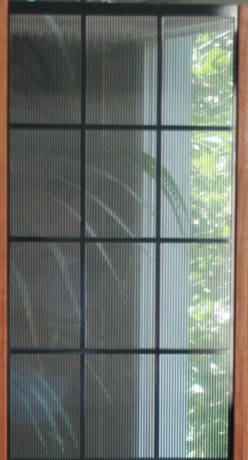

Some level of visual transparency is apparently possible for those who value this feature highly. This picture is from Sanders' site:
I like semi-transparent panels, but transparency is not a top priority for me.

Alexberg, did you intend to attach a picture to your post?

I surely did.
If its gonna serve any purpose, it's discharge device

im sure fr4 1mm does not come close to 1 mm steel stifness wise. use both allot, and not at all the same 🙂 fr4 is bendy 🙂 the way they are used in the ESL from sander.. in these tiny slits... im sure you can push them with a finger into major trouble. the wires used in an audiostatic or any other solid coppper wire stator can have the benefit of being stretched along solid rods. making them stiffer then equivalant 1mm pcb in my opinion 🙁 and far better insulated all around. also the touchable side. that does not crack or falls off due to the high voltages. like many solosound panels start becoming troublesome after a while. a while does mean 10-20 years... so stikll rather ok but they will fail in the end !
