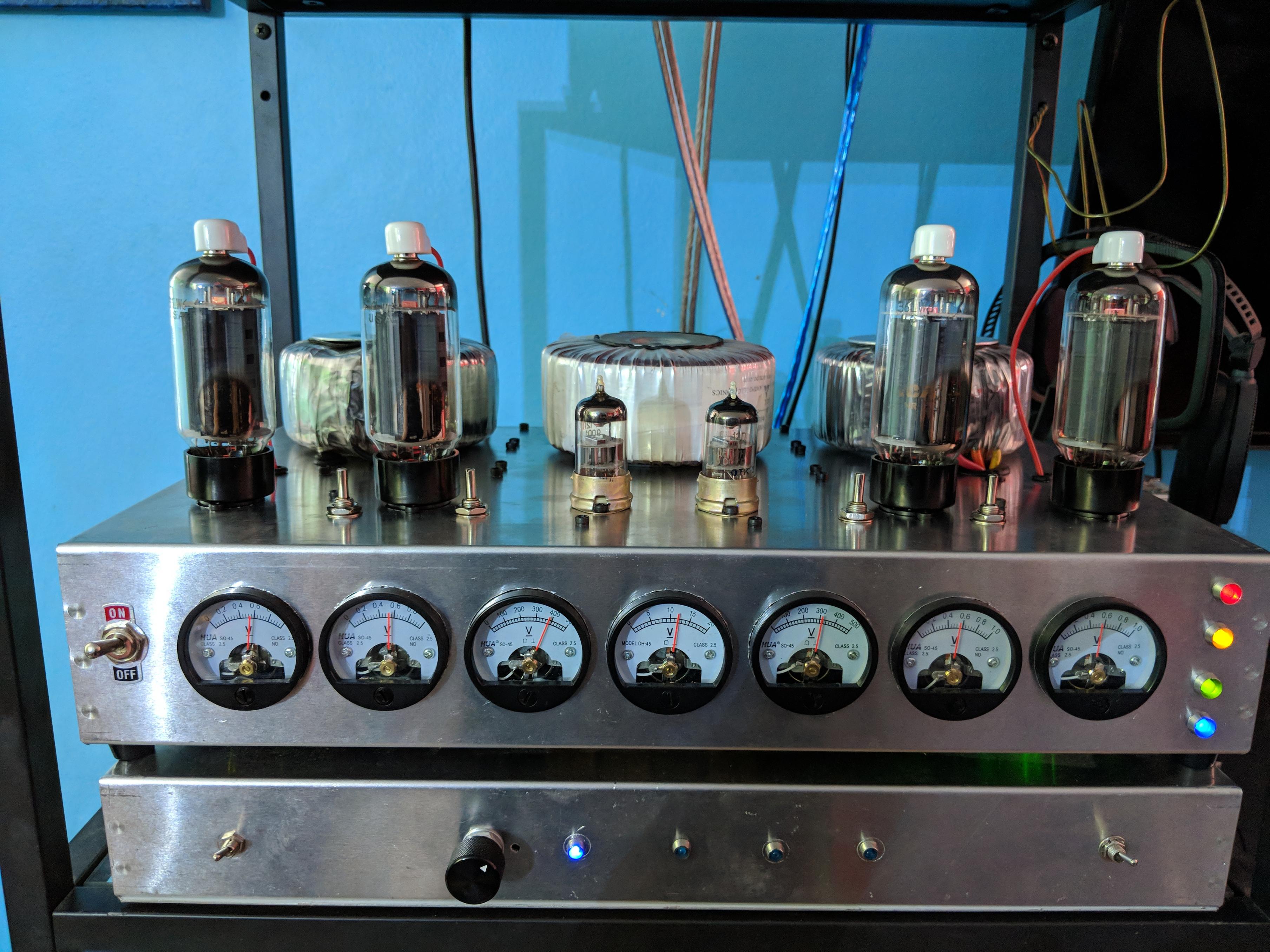

OK. So I've built an amp. It's triode connected, 300V B+, 120ma fixed bias, and RLa=~1k3.
I haven't made any non aural measurements yet, but it sounds great.
Push pull calculator says it'll deliver 75W at 0.3% 3rd. That's before gNFB.
I'll probably start a new thread for it, but here's a glimpse.

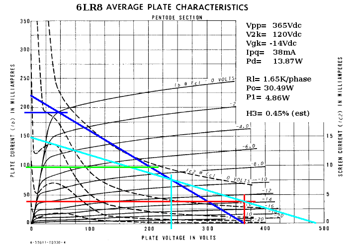

Horizontal (line output) sweep tubes were never designed for class A operation. It has been stated that the most linear part of the curves lie in the red zone. Vertical (frame output) sweep tubes are DESIGNED for class A operation, but the biggest ones are only good for 15 watts or so.
The "or so" part is true. Here's what I get for the 6LR8 (I have a bunch of the 21V version). 30W with a PD of 13.87W -- less than 7.0W/tube for a tube rated for PD= 14W is running them pretty conservative. You could do more power with higher voltages, deeper into Class AB1, and larger plate loads. At the expense of more distortion, of course.
The 6LR8 was one of those specialty tubes that included a small signal triode and a power pentode in the same glass to make vertical time base oscillator/amplifiers. Still convenient as you have your grid drivers right there. Looks rated for big screen, color TV use.
I wouldn't use *LW6s as pseudotriodes. Delicate screens that can't take much voltage goes against that. Besides, as pents, you can get north of 100W with a PP pair. If these are anything like the other TV HD finals, they should sound real good as audio pentode finals, requiring just a bit of gNFB to take the "edge" off.
The screen is rated at 280V, it's getting 320V through a 220R resistor. The plate is still the main target. Also the screen can tolerate 40ma at 320V for a few seconds (the plate cap fell off when I was testing it upside down). I'm thinking in tetrode, they would make 150W or so. I wouldn't run them at 400V with lower current, but 320V, 120ma is well within spec, even if the max screen voltage is exceeded slightly.

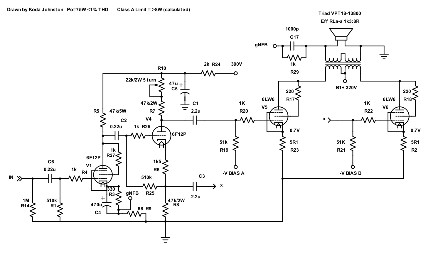

Here's the current schematic.
It takes about 15 minutes to stabilize at it's bias points. This is by far the best demonstration I've made to date in favour of toroidal power transformers as OPTs. These transformers still sound fine (at low volume, while the amp is heating up) with a 40ma DC mismatch.
The model I'm using is rated at 250VA.
The calculated output is 75W. The class A limit is about 8W. The tubes idle at about 40W Pd.
To me this is nothing because these tubes ran for years basically full out as horizontal outputs in televisions. I've kept the voltage low (for a tube with a peak of 7kV anyway) to better serve the screen grid, and to maximize the power from the OPT. High current and low voltage is preferable with an off the shelf PT as OPT in my experience. And as George (Tubelab) has said, they tend to die at higher voltages, and his suggestion was to keep it under 350V which I've done.
Any comments?
Any comments?
The only comment I have is good job!
My thoughts are for the bias mismatch saturating or magnetizing the output transformer.
You said the bias stabilize about 15 minutes , how much variation? 2. is it tube related or simply the circuit heating to stable températures?
In my amps the bias is offset for at most 1.5 mA for the first 5 minutes, then it gradualy sets to the desired bias within +/- 0.25 mA often and 0.5 sometimes depending on temperature of the room.
I am currently building such an amplifier with a toriodal with 2mA tolerance, So I though about using an auto bias board... not very familar with it and its compatibility with class AB , I want to bias to be like 50% higher when tubes goes into class AB, goal is around 60 watts 1% with KT-77
