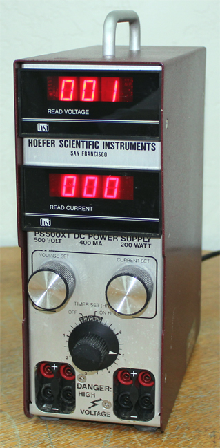

A variable power supply with current limiting for testing could be a big help.
These PS500XT things are cheap:

Cheers. Yes, I've heard of these before. My "Adjustable" power supply is in the form of taps. 110 160 200 220 280 380 400 440 560 760 🙂

Current limiting power is useful in any case. Even the timer on those Hoefer things can be useful for when the listener falls asleep on the couch auditioning the sound.

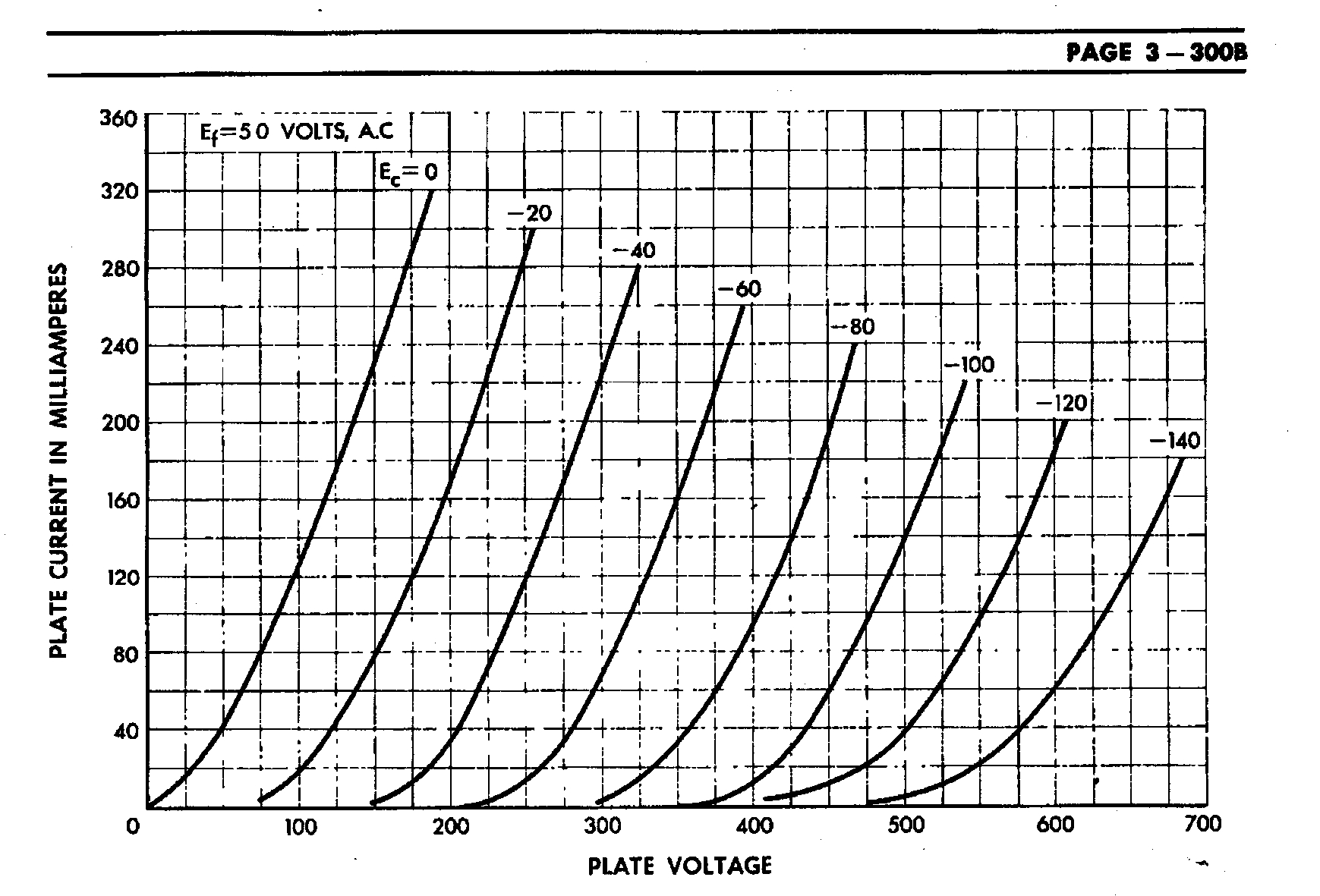

Could the 6LW6 in triode sub for a 300B I wonder...

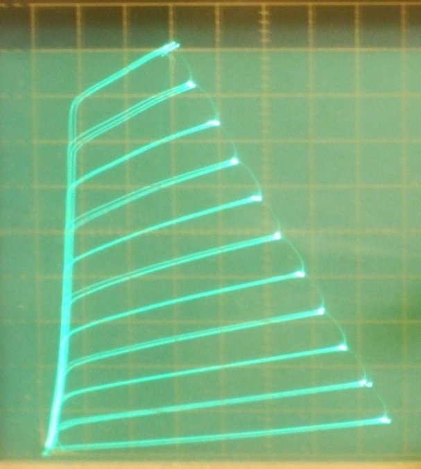

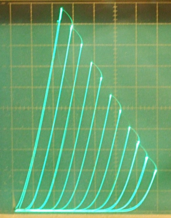

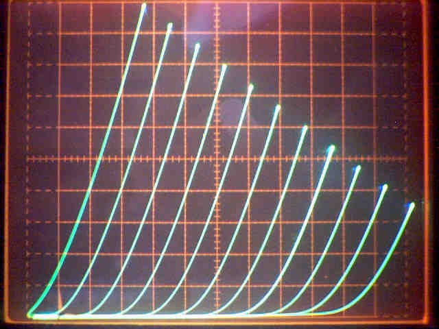

a) 36LW6 in triode, 50 V/div horiz., 50 mA/div vert., Mu approx. 3.7 at 125 mA
b) 300B Mu 3.9 at 60 mA
c) $4 tube, for reference, best used as an emulant tube in inverse triode

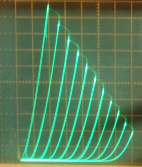

d) $1 tube, 10 Watt, frame grid, Mu 30 (curve tracer selected)
e) same tube in Crazy/Twin drive (perfect pentode now!)
The _LW6 looks better, but probably just a poor curve tracer got used for the 300B datasheet.
What's the grid step used? BTW, does anyone have all the pages of the 6LW6 datasheet?a) 36LW6 in triode, 50 V/div horiz., 50 mA/div vert., Mu approx. 3.7 at 125 mA.
I think those would be -9V grid1 steps for the 36LW6 curves. That fits the Mu 3.7 spec, and 90V was the max step range available back when 10 steps (11 curves) were available on my Tek 576 tracer (my 1st modification).
Later modification (#2) to the Tek 576 allows 14 steps (15 curves) and 168V step range (so 14 steps of 12V)
The 300B curves look like they might have been combined curves from 2 step ranges. The last two curves (HV curves on RT) look inconsistent with the left 6 curves.
I used to use the same kluge when I needed more than a 90V step range, just wire in a fixed DC V supply in series with the grid1 lead wire and trace again. Been there, done that. The inconsistency on the 300B graph is probably due to capacitance to ground of the floating supply. (possibly some R to ground too)
