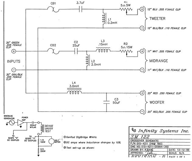

But I looked up the Infinity SM122 crossover. A few reuseable components there by the look of it. I'd prefer to measure them before recycling since version numbers change.
In fact, I don't see why you can't reuse the circuit board too with some changed values for a two way. Saves a bit of work and money. It's not hard to cut PCB tracks and drill a few extra holes and add some wire to make connections. Most of the hook up wire you can buy is 15A or 30A copper fuse wire. Easily obtained.
