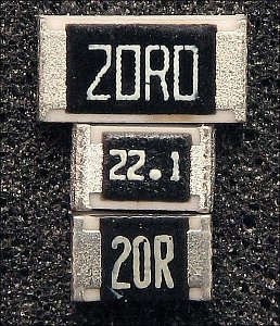

What he told you is correct for 1% components. 5% components only have 3 characters/digits and the 3rd digit is the multiplier. One exception is when an R or decimal point is used. For those resistors, the digits to the right of the R/. are part of the resistor value and not a multiplier. From top to bottom, the following are 20 ohm 1%, 22.1 ohm 1% and 20 ohm 5%.
