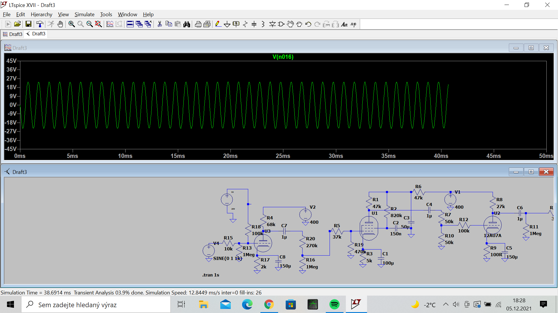

Recently, one of my teachers came to me and asked me if I could design and build a tube amp for him. So I got excited and started to work. Here I came up with preamp section which uses 12AT7 as a gain cell where the gain of upper tube tube is controled by the voltage on the grid of the lower tube. Then there is a EF86 and one half on 12AU7. As the power tube I chose a KT88 but I dont have it in schematic because I couldn't find the right output transformer model. At the full volume the preamp makes at the output 250V from the 1V input. Do you think, that this design should be working well? Isn't that 250V too much for KT88? Is there any way how to calculate tube headroom? Thank you very much.

So a computer simulation of your circuit produces 250 V signal at the output?
The cathode voltage of the 12AU7 would be around -1 V (at Ia = 10 mA and Va = 120 V). The gain stage is about 12. So to reach an output voltage of 250 V an input voltage of almost 21 V is needed. I don't really see how there is room for that with Vg being only - 1V.
I don't really get the idea behind the 12AT7 stage. If I understand your description correctly, the input of the amplifier is at the upper section of the 12AT7. That section is grounded through R13. The lower section seems to function like a kind of cathode bias resistor for the upper section. There's 20 V on the control grid of the lower section while at the same time hardly any voltage can develop between its cathode and anode since that voltage is the same as the cathode voltage, so the bias, of the upper section. I would think that grid current will flow in the lower section of the 12AT7. What is the benefit of this idea?
Yes, there is 21V on the input of the 12AU7. I know that the bias voltage isn't high but the simulation shows that it is working but I'm not sure if is it working irl. The idea behind the 12AT7 stage is to have a volume control without the signal passing trough the pot. Yes you were right, the lower 12AT7 acts like a variable cathode resistor.

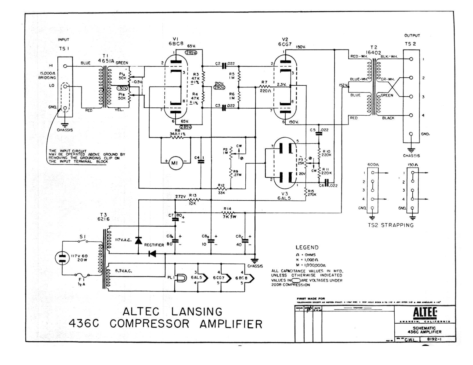

For reference, a classic Tube Compressor/Limiter
Audio signal is rectified into DC by double diode V3 6AL5 charging 1uF capacitor C4 and that DC is fed to V1 grids to directly control their gain, nothing on cathodes.
Yes, their bias varies wildly, also plate voltages (what happens in your design too) but they null it out at the output transformer T2

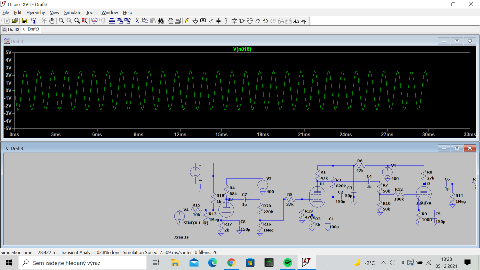

Thank you for your reply. The audio source will be I think CD player. If I got it right from what you said, I can vary the gain also by the voltage on the grid? I tried this and it seems to me that it works. What do you think. Resistor R18 is the one that varies.

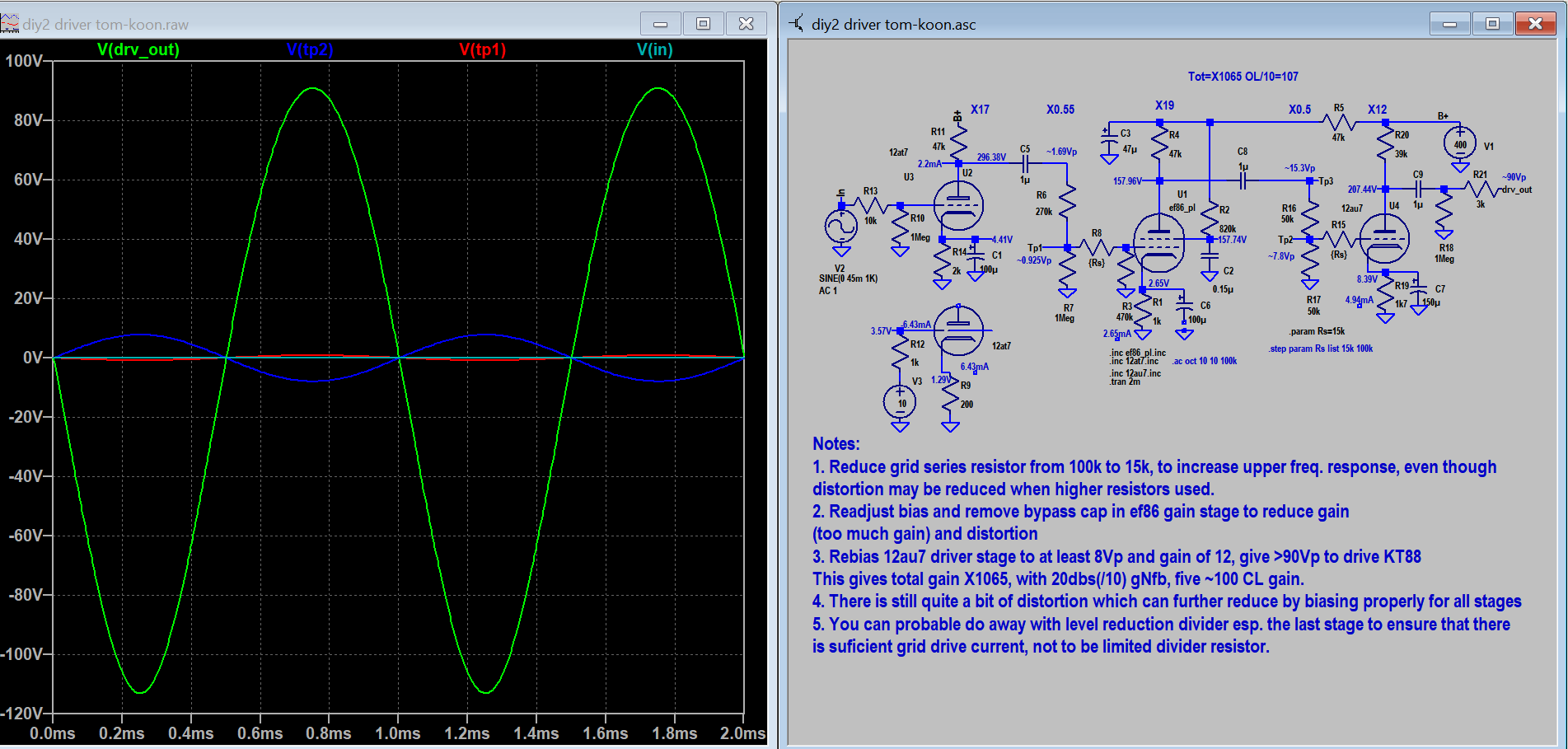

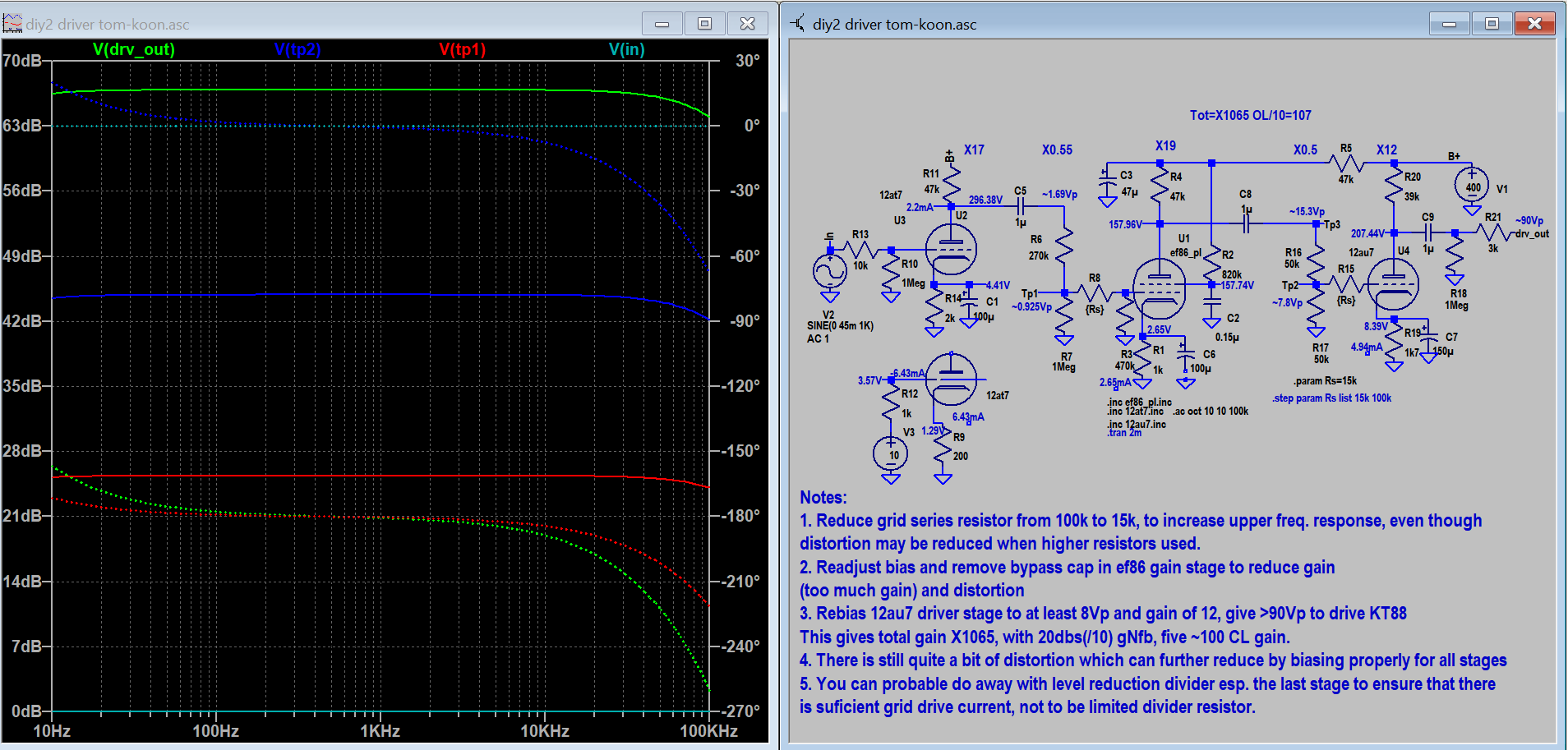

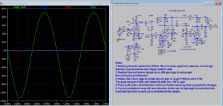

Please see my comments as attached, there are only a few area needs mods obviously which can make it works.
