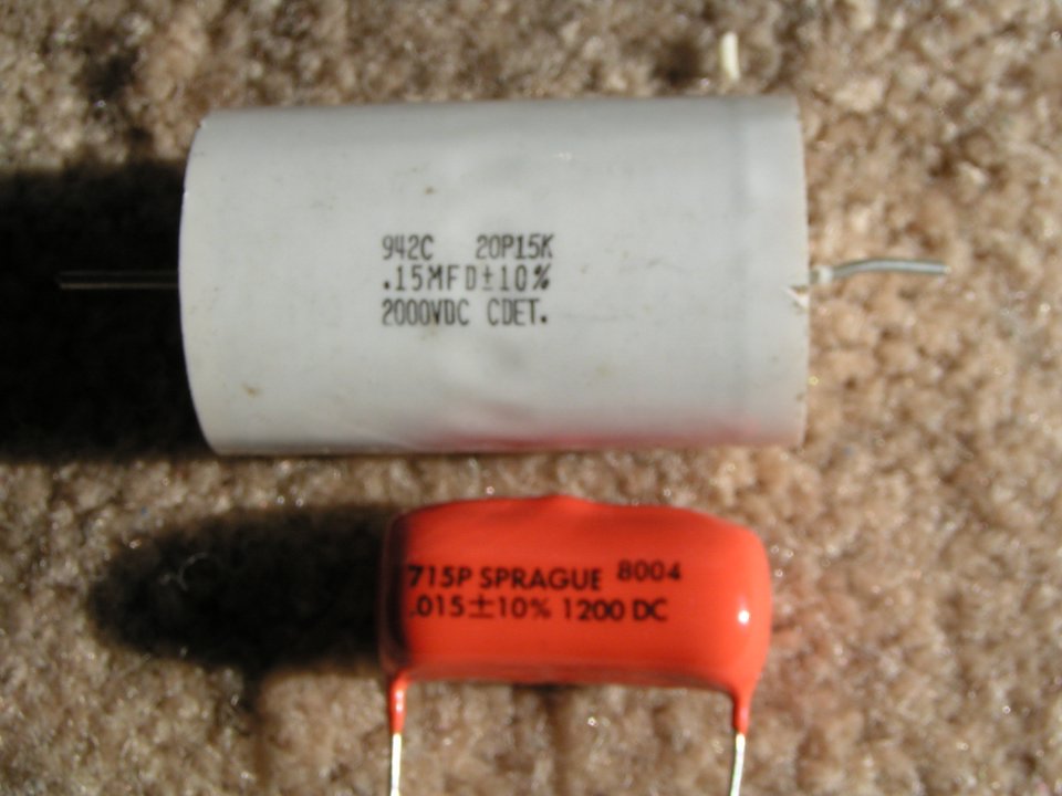

poobah,
When first built I had Sprague OD, .05uf 600v.
The bias was always a bit funky. The under-rated diodes didn't help much either...
When I would take a reading at the test points for plate voltage I always got a rock steady reading, but when I'd check test points for the voltage drop on the 27k cathode resistors to ground I'd get voltage that would fluctuate. If I had the DC balance set to .905 for each 7591, it would constantly fluctuate up and down to .910-.899-.905-.915 and so on.
The bias continued to move more negatively all the time as well, causing me to constanly monitor and adjust-I knew this wasn't right but I also knew I followed the schematic exactly so I knew it wasn't a mistake in the build.
A couple weeks ago I was checking and adjusting bias and one channel stopped and I shut it down. Went checking and found the .05 600v orange drops had shorted.
Replaced them with a pair of .022uf 600v in parallel and brought the amp up with my variable AC power supply and checked voltages-everything was in line so I listened for a few minutes, then checked the plate test points and read 560v when I should read 480. Shut it down, checked the new caps-no shorts-and started suspecting the diodes.
On Saturday I replaced the 1,000piv diodes with 1,500piv and brought things up slowly on my variable AC power supply. After a few tests things looked good so I gave it a listen, but found the test points for the 7591 cathode resistors are still fluctuating as before.

Well Mojo,
I ask about the Orange drops 'cause there are many types that go under the same name. And after hearing the horror stories from Kevinkr, I am reluctant to tell you to throw a bigger (voltage)cap in... Although a cap with a good AC rating should do it.
Do you still have your old caps and can you give us the number on them? Did you happen to touch them while running... if you do so... do it carefully!!!!
We can calculate the whole nine yards; which seems a smart thing at this point.
1. Do you know what voltage you're trying to get out of the circuit?
2. Do you know the current that is flowing?

The Cornell Dubilier caps would work, but are kind of hard to find in that value in small quantity. Mouser has .1uF 2,000VDC 942Cs, but its too expensive to series them to get .05uF.
Digikey has has Panasonic ECW-H16473JV in stock, which is what I'd substitute. 1600VDC, .047uF. These capacitors are suited for electronic ballast use. In testing the slightly larger .056uF 1600V Panasonic capacitor 3.5 amps RMS of 350khz sine wave continous lead to a 3.1 degree C temperature rise. $2.78 each. Pushed, they can take 6.3I RMS, short term. This is in real testing, not simulation.

I ran some numbers... assuming I read the resistor values right.
The total current flowing out of this circuit to the bias network is about 590 uA. So for the most part the caps see the first 27K resistor, with their 5 mA flow. Its just a simple AC thing at this point.
The caps have an odd waveform 270 VAC across them on one phase and a MAX of 380 VAC on the other...
So, if you had 225P orange drops they would have died.
If you had 715P's Orange drops with a DC rating of 600 Volts, and an AC rating of 200 Volts they would have died...especially when the inside of the amp heated up a bit.
Now if you use 715P's, 1200 VDC, 475 AC (rms), you should be good to go...
p/n 715P1200V0.047
Mouser $2.02
Now these voltage ratings only hold true up to 85 deg C. but if your amp was that hot you'ld be cooking Christmas roast or something.
You could put 2 - 0.022 uF's with 1600 VDC but it won't buy you much on the VAC rating... 500 volts instead of 475.
These caps are big though... 1.7" x .9" and that's the key to the heat problem... more surface area.

Just a note, the CDE 942Cs are a better choice for a high current applications than 940Cs, even though the voltage rating is lower. Unfortunetly they are harder to find. The specifications of interest here are dV/dT, I peak, and I RMS, as Kevin noted.

Thanks for the pic-it's gonna take a little creative manuevering to get these bigger caps in there...😉
One other thing I've been thinking about; and maybe this is what you guys have been trying to get through to me all this time-like I said, I'm no engineer!
Dissapation factor. Schematic lists PIO caps since in 1961 that's all that was available. But PIO also has a lower dissapation factor than poly/film caps: .05% for PIO and .1% for poly. Maybe that's what enables a 600v PIO cap to survive.
So I got to thinking, maybe the best route is three .015uf 1600VDC/700VAC poly caps in parallel-as Kevin suggested. That should give me a dissapation factor of .033% and at a suitable VAC rating as well.

Foil vs. metalized is the key here... along with obvious issue of AC ratings (which we have all thoroughly beat to death)... you're good to go here Mojo... relax. Put in the 2 cornies and away you go!
Put 'em in and run it... if they get warm, that's FINE. if they get hot (they won't), go nuts with the parallel stuff. Heat is what consumes voltage and current ratings in caps. 'Sides it would suck to screw up your pretty amp with a kluge of caps hanging all over the place.

Dissipation factor in this application is not a problem once your at polypropylene or better. Some specialized (pulse duty) metallized capacitors are just fine here.
Here are the results of some dissipation testing done on polypropylene pulse capacitors by Terry Fritz:
0.047uF 1500V Arcotronics capacitors "RS" from Richie Burnett
2.5 amps RMS 350kHz 2.2 degrees C rise
0.022uF 1200V Panasonic Q-E?? from Bill Noble
2.0 amps RMS 350kHz 4.8 degrees C rise
0.056uF 1600V Phillips 376 KP/MMKP HQ from Finn Hammer
3.5 amps RMS 350kHz 1.5 degrees C rise
0.056uF 1600V Panasonic ECW-H16563JV stocked
3.5amps RMS 350kHz 3.1 degrees C rise
This is way higher frequency than your application. RMS current here is in series with the capacitor. Do not confuse RMS current with average current.
Your main issue is I2R related, PIO caps are of foil construction so have more conductor than some.

Incidentally the value of that capacitance is quite important, you should stay quite close to the recommended capacitance value or see the voltage increase/decrease dramatically.. 😀 If you are using 0.015uF then three in parallel will get you quite close to the original value.
As others here have indicated the construction of the capacitor is important, foil types will handle the current much more readily than any metalized film types.
Incidentally what is important here are the voltage & current waveforms across the capacitor, not the voltage to ground. If you have a two channel scope you can check the voltage waveform across the capacitor using differential input mode with channel a on one side of cap and channel b on other. (On Tek scopes invert channel b and select a+b mode, set both channels to same range.) Make sure you have high voltage probes, connect probe grounds to chassis. To measure current just stick a 10 ohm resistor in series with that cap and connect the probes across it. Pk voltage and current ratings of the capacitor should not be exceeded if known.
