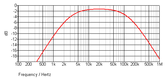

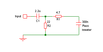

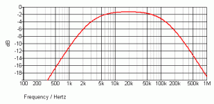

Piezo tweeters are capacitive (in this case about 300nF), so it makes sense to me to use a crossover something like this:
Bingo. Cookie cutter off the shelf crossovers will not provide the desired results with a piezo tweeter.
Using just a single resistor in series with the tweeter doesn't help the tweeter at all, it just protects the amp from possible instability at ultrasonic frequencies. You can use a piezo tweeter like that, but it's better to use a proper crossover as shown above. That keeps the bass and most of the midrange out of the piezo, thereby improving power handling and reducing distortion.
