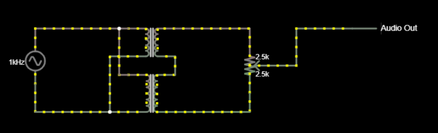

I have an audio source that always outputs a signal that is about half the volume as it should be.
What would be the downsides of simply using 4 audio isolation transformers to step up the voltage 2x before sending it off to the amplifier?
The reason for using 1:1 audio isolation transformers is they are cheap, easy to find, and already optimized for audio frequencies.
Something like this(This is only half, as there are 2 channels):

Technically, it can work.
But I don´t much see the point of using 4 transformers to get a mere 6dB voltage gain, where there are easier options.
You don´t give us any details at all, such as what is your audio source or what the amplifiers are (hint hint) but I guess you can either increase source out or power amp sensitivity ... IF any of those are really needed that is.
Are you sure you need exact 6dB gain?
We need details. 🙂
You only need 1 per channel.

The output is analog from my TV going to the amp that powers the speakers. The output from the TV is low, but not that low, but I thought I could save a wire by doing it passive, and keep things tidy. Yes, 6DB should do it, it needs just a bit more. I thought it would be a solution over running a preamp between the TV and amplifier, as when I do that, I have to ground loop isolate anyways due to ground loop noise. Audio isolation transformers are like 50 cents each, so don't think it's a matter of cost 😛
It appears that Rayma's doesn't actually isolate though, so perhaps that isn't really a solution unless the active preamp was the source of the ground loop noise all along.

Distotion, particularly at low frequencies.
Frequency response not perfect, especially without the right output network.
Bass power handling is a limiting factor, as this is where saturation will happen first.
Hum pickup if not well screen magnetically and kept away from hum sources.
Size/weight?
So a little care is needed in checking the impedance matching and response to get flat response, and bass handling might be an issue if the Xformer is too small.
Being passive is obviously an advantage for simplicity.

I see. I kept the isolation and stepping up on the high impedance side to help with the distortion. Just hooked it all up today, as I figured I would just give it a shot, and I am not sure I notice any effect to sound quality other than a positive one from having high enough volume levels now. I suppose I lucked out here if so much could have gone wrong.
I have it enclosed in an Altoids tin, should that be enough shielding(Although currently I hear no noise getting in).
I think you need to define cheap. Cheap audio transformers are usually hot garbage with limited frequency response and phase shift amongst other issues. A line-level 600:600 transformer of good quality like the Jensen JT-11P-1 will cost about $60. You will need two per channel in this case- that comes out to about $240. If you shop around you could find a pair of 10K:600 Jensens for that price. I've seen JE-6110K-B transformers go for as low as $40 each.
But IMO, a 5532 (or even a TL072) and a pair of 600:600 transformers could do a better job for less than $100. This allows you to use the pot for a gain control, rather than an attenuator, and you will be able to get a lower noise floor. And I would hazard a guess than 90%+ of the music available has already passed through at least 20 5532s and/or TL072s in the desk it was recorded through, so I wouldn't worry about putting it through one more.
Also, I am assuming that if you're throwing a bunch of transformers at the issue you want to go balanced. Your attenuator, as drawn, will not do that. If you don't need balanced, why the transformers?

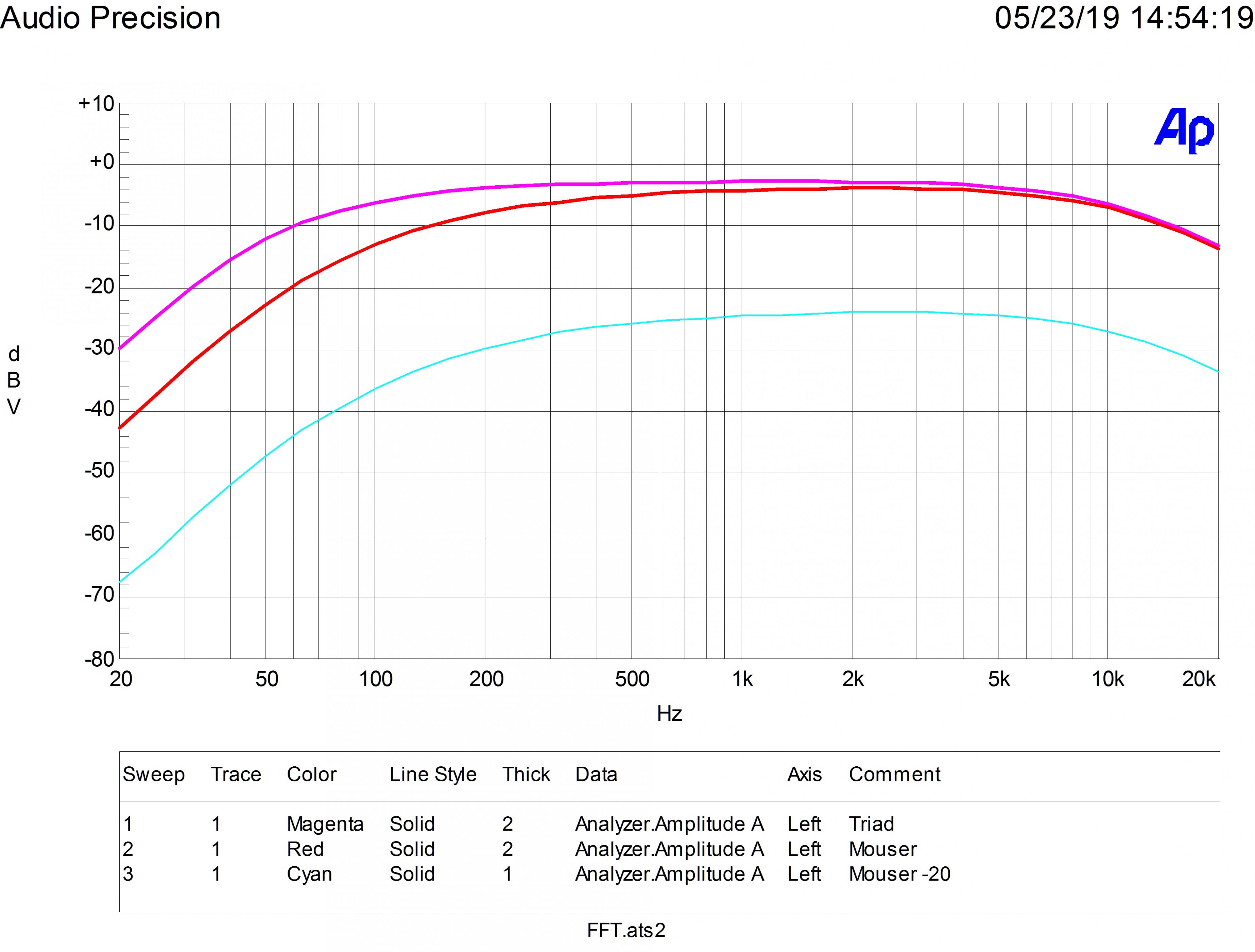

Here are actual curves from a Triad TY-145P transformer and a Mouser 42TL016-RC. For better low frequency response the Triad TY-146P can be used. The high frequency roll-off is in the circuit used not the transformers. (Funny don't see any hum pick-up! Used just free air on my bench.)
All are 600 Ohm to 600 Ohm center tapped so use the input on the center tap and the output across the entire winding.
Completely under $25.00.

Wow. Wasn't expecting anything this in depth 😀 Is that the response with a load? I didn't notice anything that severe, but the input impedance of the amp I am using is very high. I used EI-14 transformers.

Doing a project that will end up using 20,000 or more of them. Source impedance is 660 ohms load is 10,000 ohms. I show the same transformer at two levels which suprisingly shows it is not saturation rolloff on the low end. But they are tiny transformers.
I use the TY-146 models by the hundreds, never had a problem.
The other really good application for transformers is that transformer balanced inputs work really well for things like microphones. Their bandwidth limiting at the high end also has the positive side effect of blocking RF.
The (likely quite high) distortion and poor frequency response of the Triad makes it something I wouldn't want in the signal path of a high-fidelity system. IMO, for high-fidelity recording and reproduction, if you can't afford good transformers in a design, don't include them at all. Of course there are exceptions to this, but this sounds like an application where a TL072 makes more sense. Lack of a power supply with the transformers is an advantage, but you will lose load-driving capability and unless you spend a lot of money, you're going to limit your bandwidth as well, especially on the low end.
