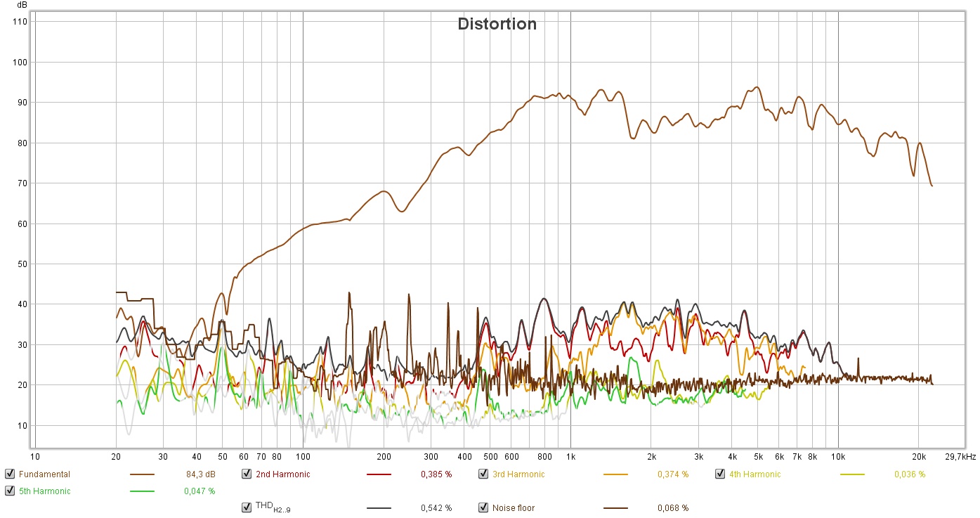

here few pics dont look at FR i just added 4 traces on there to act like tweeter.
Pic 1 Bass panel alone sweep

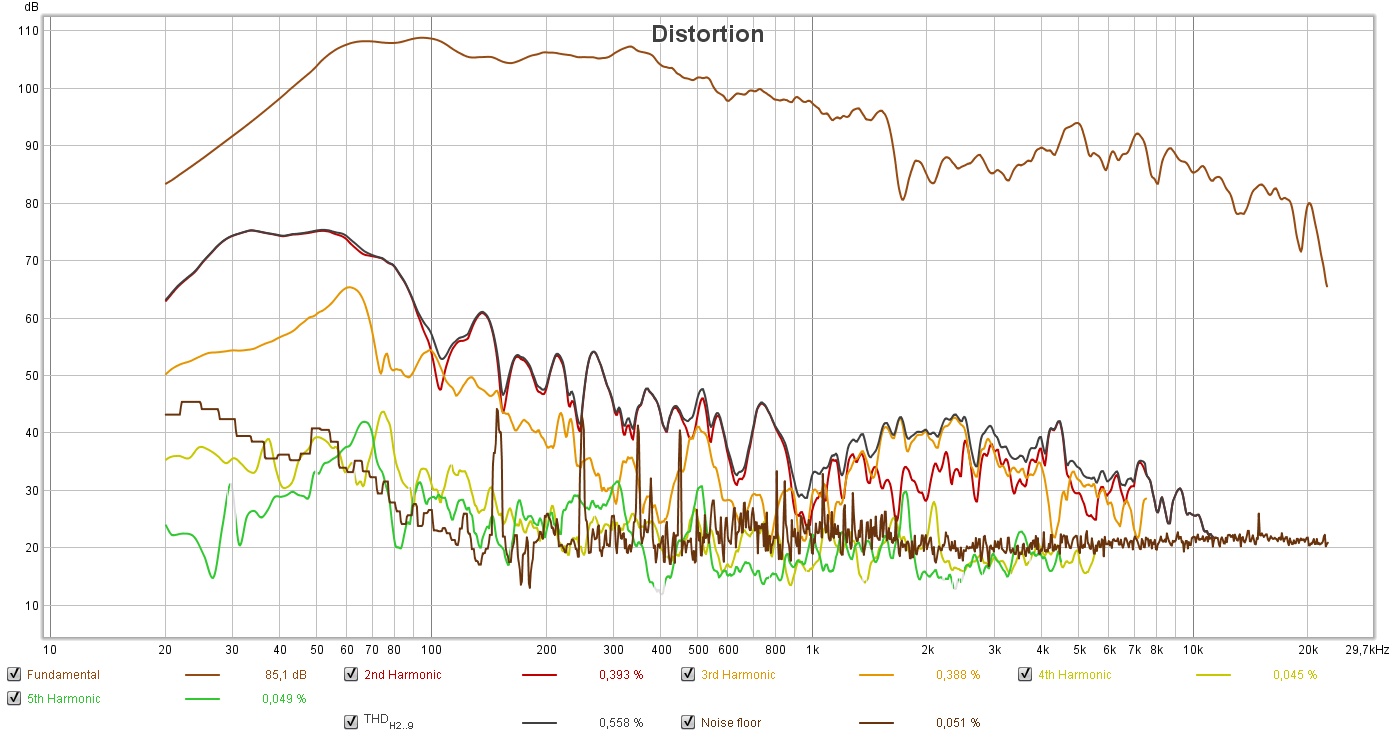

Pic 2 Tweeter alone sweep

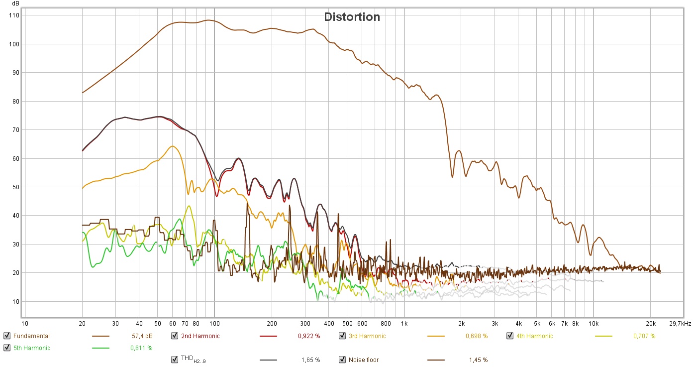

Pic 3 Bass 38 hz sine wave and tweeter sweep at the same time
Now we can see distortion when playing a 38 hz tone increases distortion in the tweeter, FR response seems to be almost not affected.

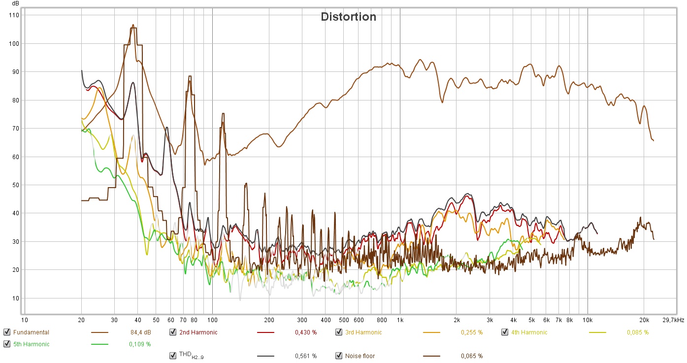

Pic 4 Bass and tweeter same time sweeped
here we can see the way it is when both are measured at the same time by REW , they both perform almost the same as they would be when playing on there own separately. and does not give a good insight.
its hard to say what im looking at haha. might be that noise of whatever of playing 38hz (like mechanical influenced it as well)
