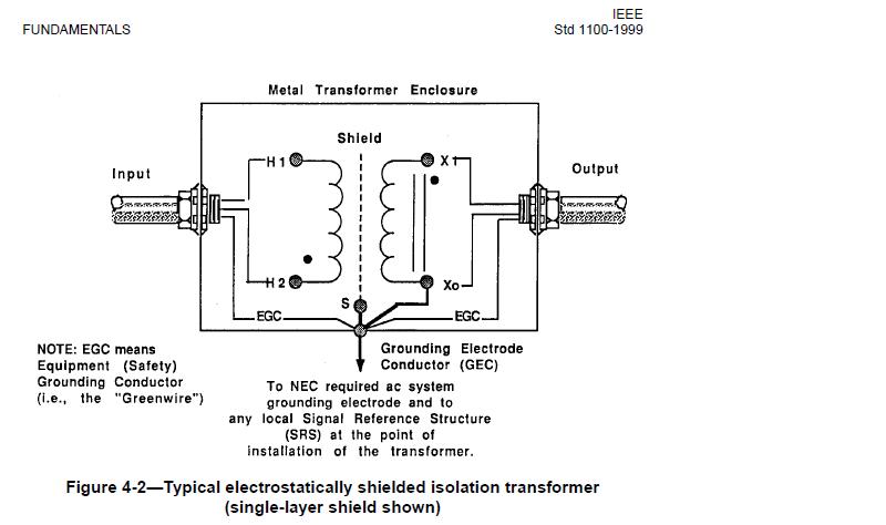

That would be fine, but as always, there are requirements to doing that as well. Not to make this too much of a Code class, but you have to use a receptacle listed for isolated ground service, as the construction is different.
Also, you still have to ground the enclosure(s), which in your case of wanting a completely isolated ground for your equipment, would require a secondary grounding means i.e. the bare conductor in NM cable or the armor of AC cable. MC cable would be insufficient as a grounding means, as the sheath is not recognized for fault current.
I agree with Zigzagflux. While I am not an EE nor am I licensed, I do create power systems design recommendations for large and small AV systems that are to be reviewed and conformed to local electrical codes by licensed electrical engineers.
The NEC codes are specific, as are the IEEE Emerald Book recommendations. The primary purpose of grounding is safety. Any advantage beyond safety is a bonus. I have included an IEEE diagram that shows the recommended wiring of a single phase isolation transformer. Any other approach is leaving oneself open to a wrongful death lawsuit.
What happens if someone touches a device with no safety ground connected to your floating power supply and simultaneously touches a device that is properly grounded to the building power system?
Chris
Chris
