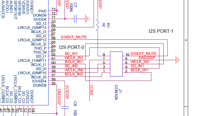

Are you asking how to connect I2S to ADAU1452?
For example, like this:
Reactions: 1 user
