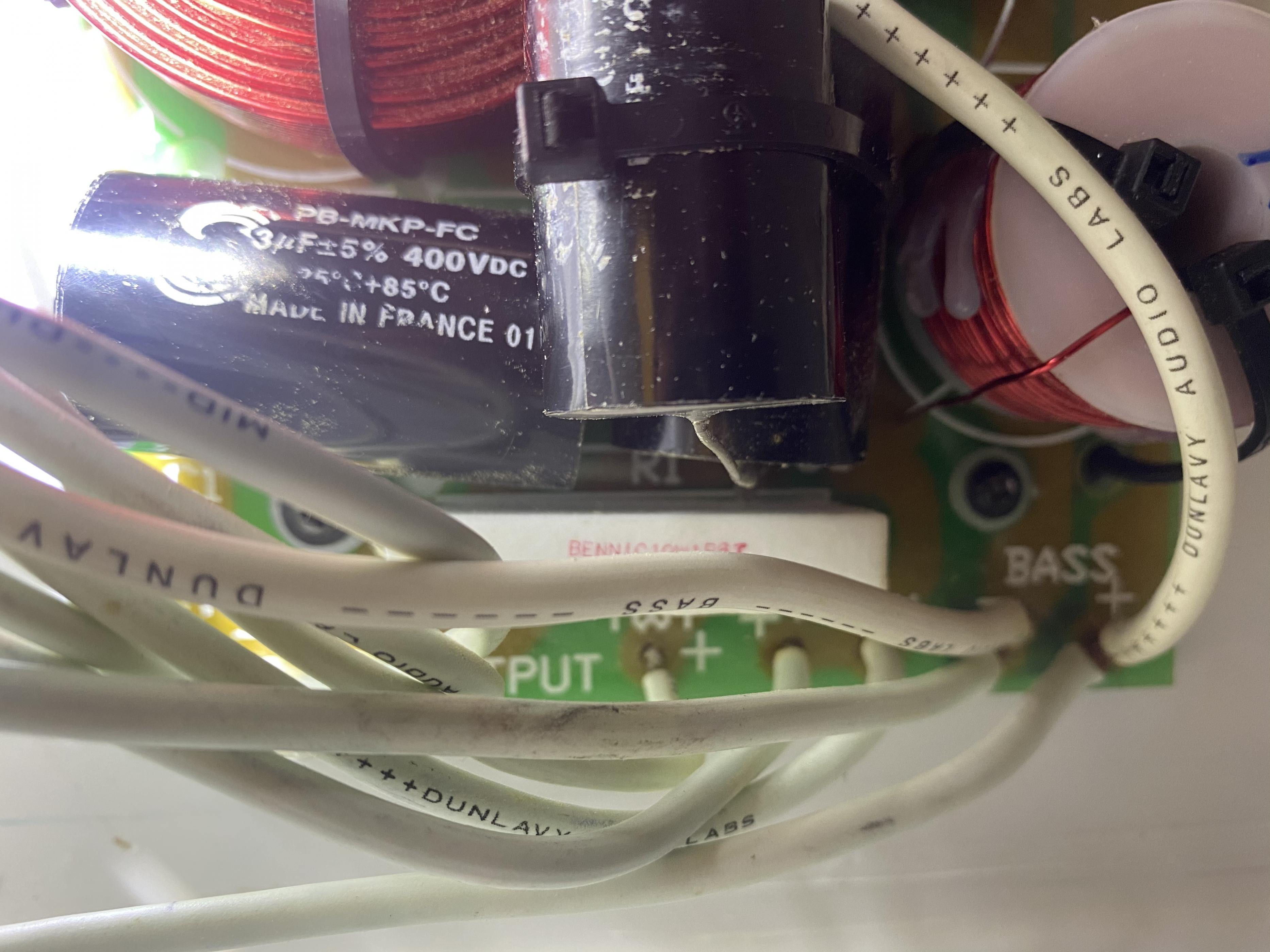

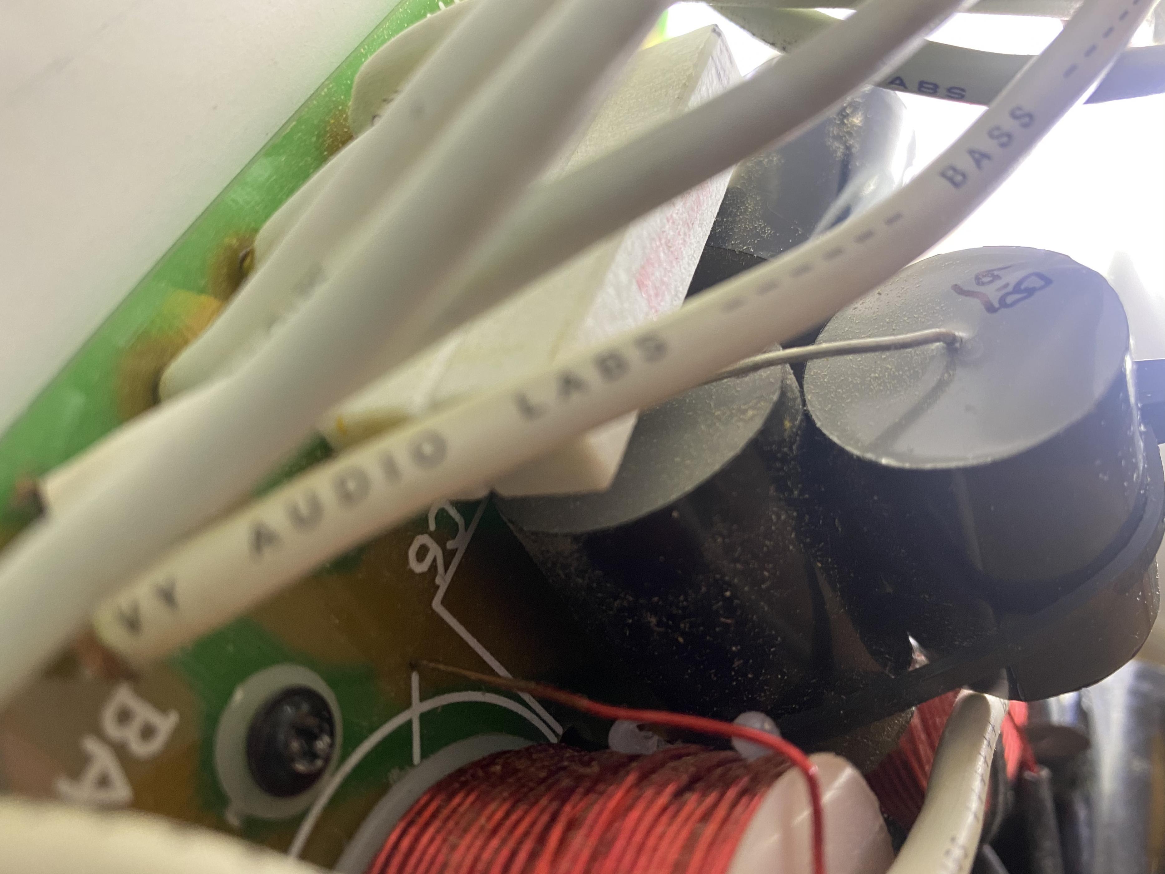

Here is a shot of that part off board.
Not sure if it help...

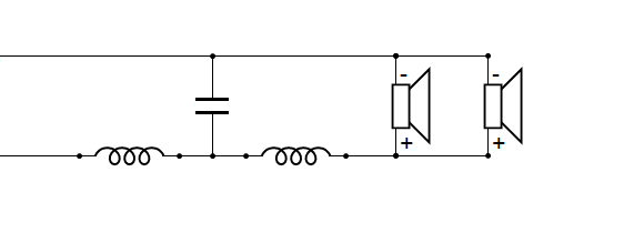

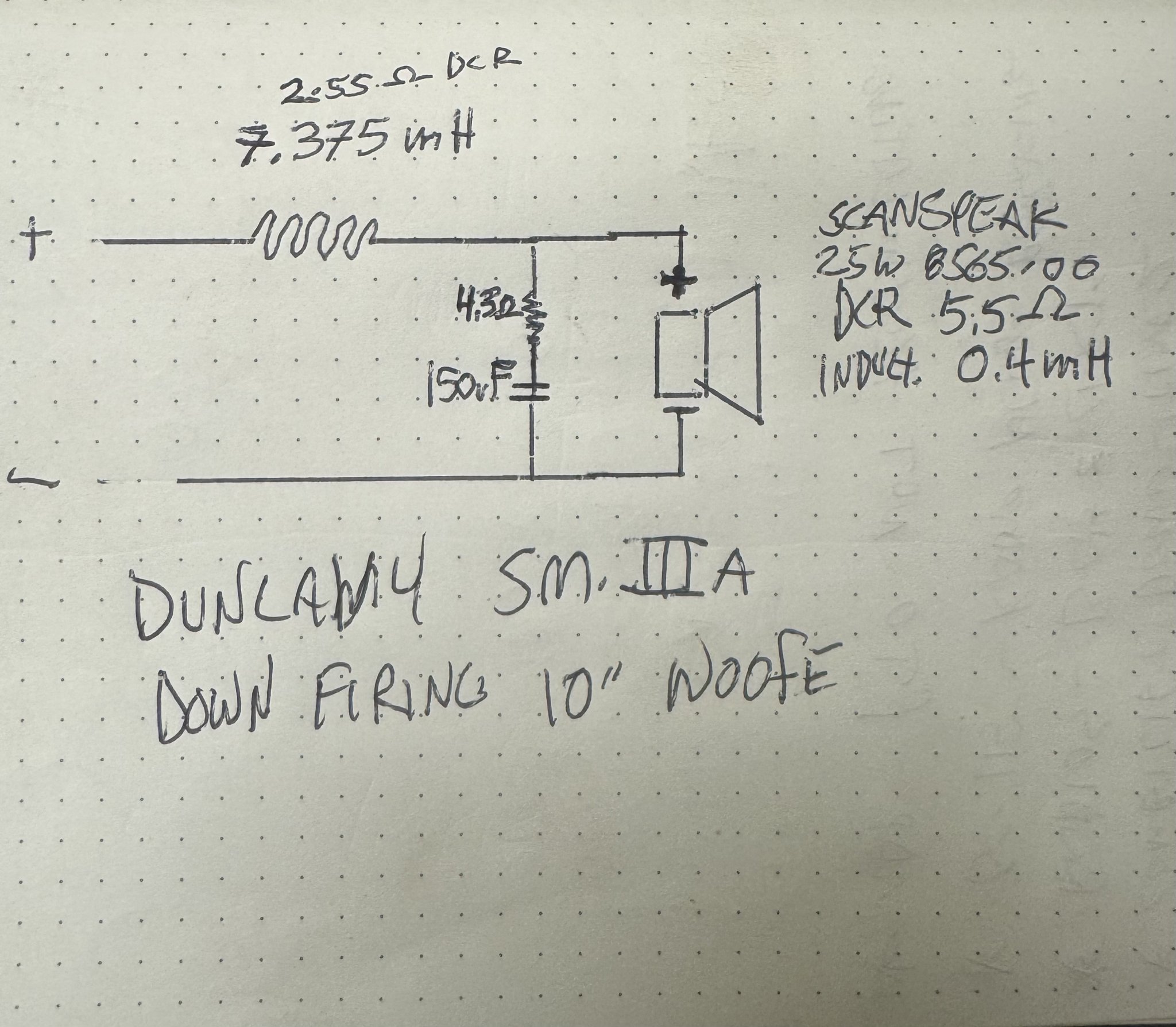

I will give it a look and see what I got wrong...
Thanks again.

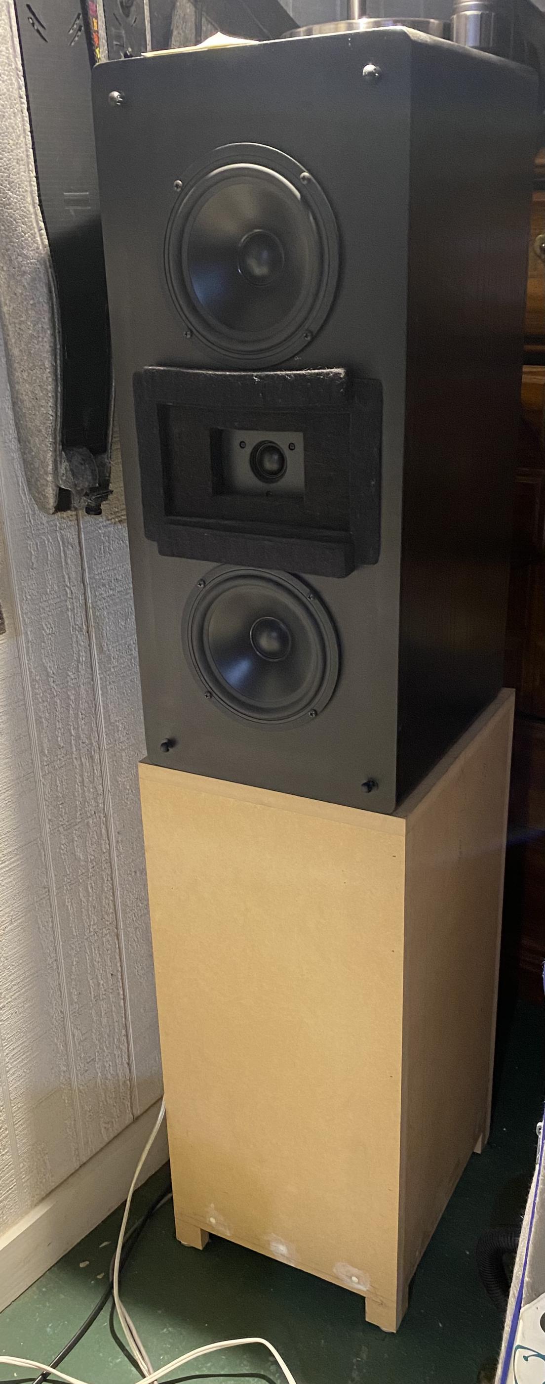

Here is my SM-1 & Scanspeak 10” so far....
With a 14.5 mH it sounds pretty dang good, with Dirac Live it sounds great!
But my end goal is to have this a a stand alone speaker without DSP.....

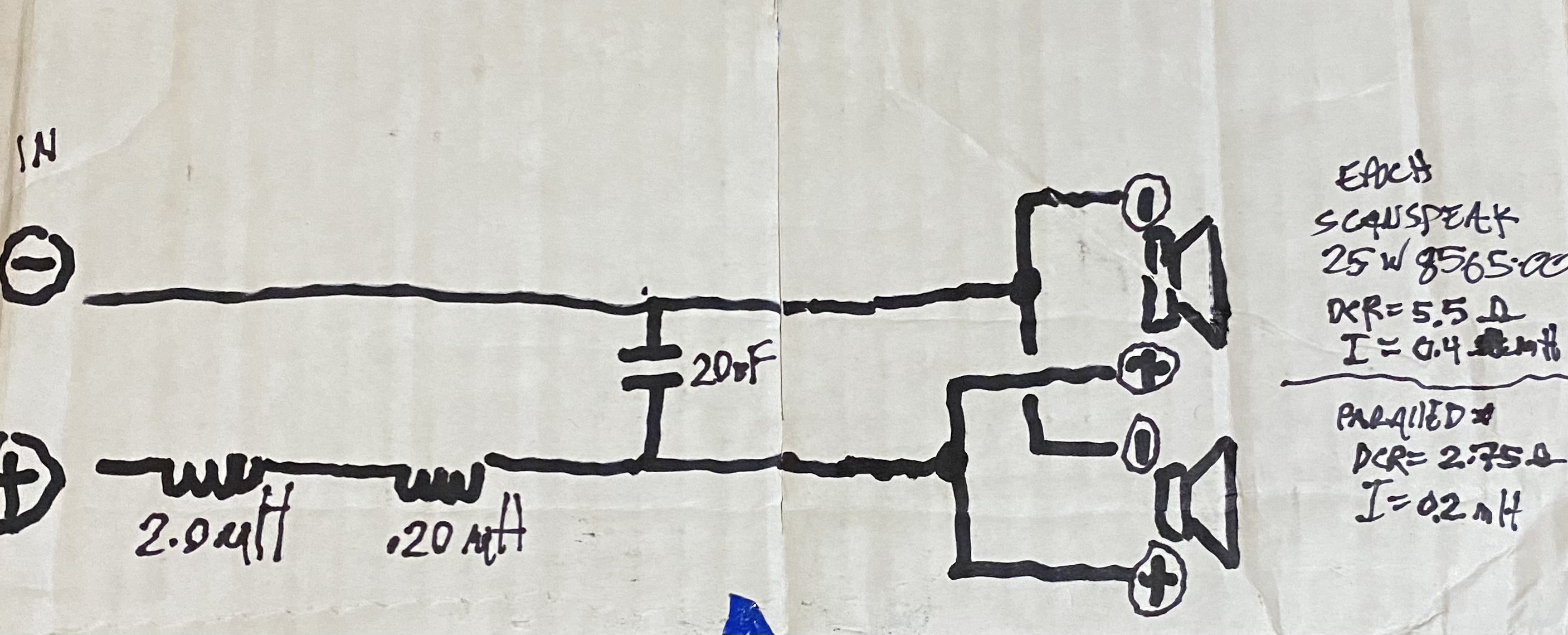

Sorry for the delay….
I picked up another HRCC crossover and I did have the Scanspeak 25w8565 section drawn incorrectly. Here is a rough sketch of the correct bass section.
I apologize for the handwriting, I am not feeling my best today.
