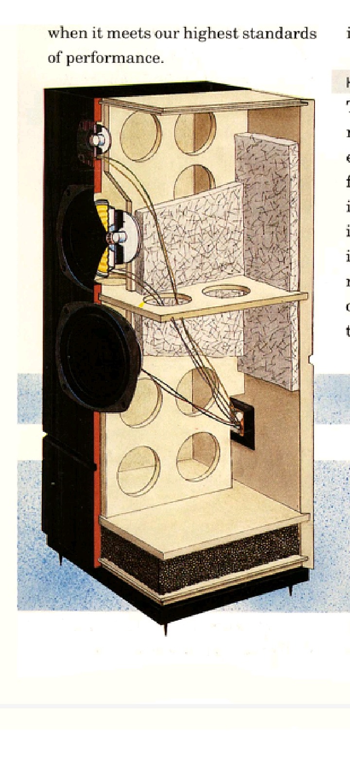

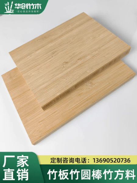

I rebuilt my (acoustic suspension) loudspeaker with 20mm thick bamboo plywood.
As you can see the attached picture, it has some bracings inside the speaker, what type of bracing would you recommend? Marine grade mahogany plywood, spruce, baltic birch or stick with same type of bamboo plywood for the cabinet?
I also attached some pictures about marine grade mahogany plywood I can get from the local shop.
Thanks 🙏

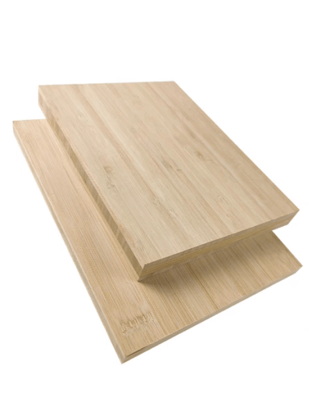

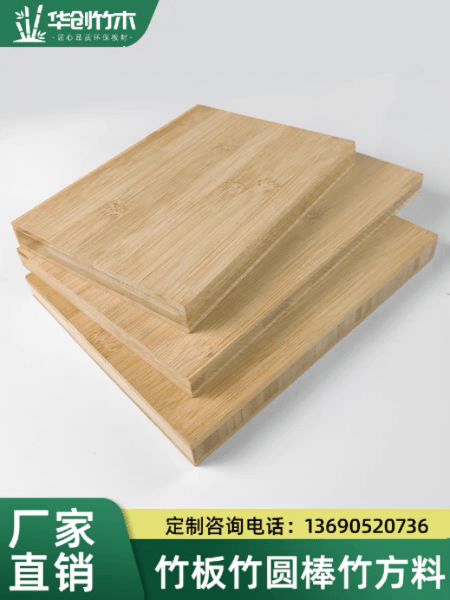

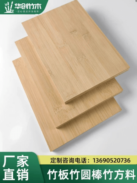

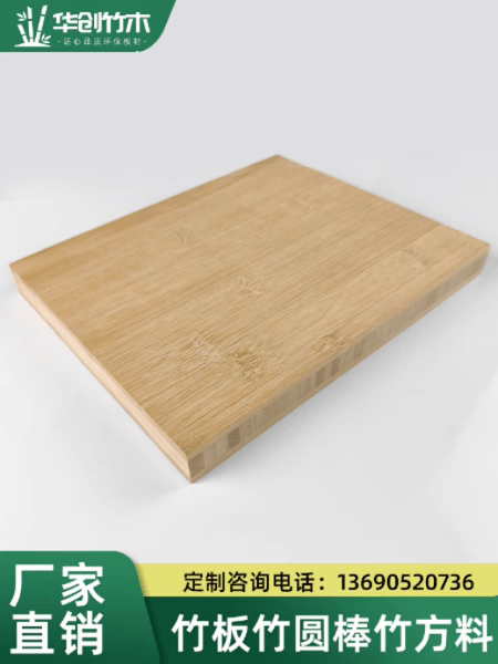

BTW, my cabinet maker is working on the cabinet with the bamboo plywood as the attached pix shown.

No real view of the contruction of the ply, but it looks to be block core — what grade of surface veneers?
You can use any decent plywood if you are trying to save money, if you don’t have a use for the left over bamboo you can ue it. I believ we have done both with our Bamboo cabinets, The firt one we builkt back and other bits are ply, there was only a half sheet of bamboo left over from someone else’s project.
I would rotate the horizontal brace you have in your visualization.

Bamboo is very stiff, so you've got the two options of either getting the extreme braces to increase the frequency of the board frequency by brute force/stiffness or you are using the soft method of absorbing it by including dampened braces (glued on one side, Alubutyl etc on the other side.
I do not recomment bamboo as speaker material in general since it's a quick growing grass (yes, it is!) and contains so much silica (silica oxyde) it extremely quickly dulls your tools, reducing their lifetime easily to 1/5th. Not by but to. Aside from that, it got some extremely good properties but an equally magnitude of negative attributes. No free lunch in physics.

Bamboo ply (stranded/fossilized) is the best flat speakerf building material we have used. Some of the Richjlite could be even better.

Normally how thick the material should be used for bracing. The cabinet is 20mm thick.
The thickness should be enough to not vibrate on itself and support enough force transfere between the sides it's connected to. That usually means it can be thinner than the walls but usually isn't reduced in thickness because of optimal use of the material but for PA use, where the weight is a major issue, the braces might be thinnner, though they usually are not.
Bamboo
I would be happy to uw 15mm BB inside 20mm bamboo walls — the best studd is probably stiffer than 35-40mm MDF.
In that direction it's just about 5-15% stiffer than particle board of equal thickness. The boards don't differ very much in that direction. If the braces have to bridge far distances, they are even more suseptible to cross resonances. If that's a problem (very unlikely), I'd no replace it with particle board (better in this situation than MDF) but dampen the ply brace with alubutyl or bitumen instead.
How big is the box? I would be happy to uw 15mm BB inside 20mm bamboo walls — the best studd is probably stiffer than 35-40mm MDF.
