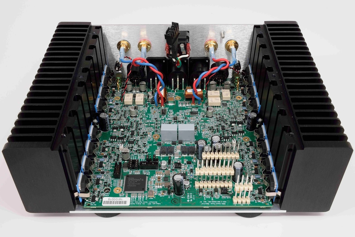

Do you by on:
  • Audition
  • Specs
  • Impementation

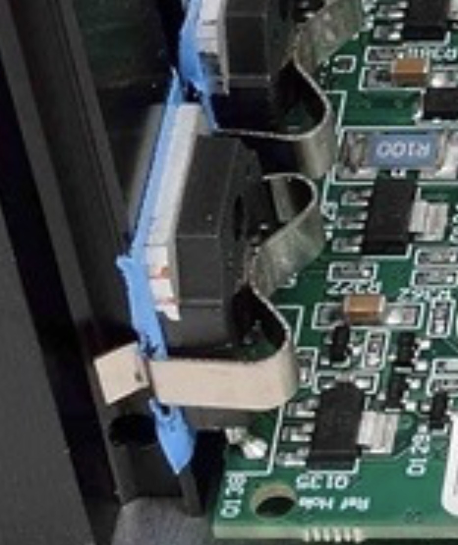

In the pic above you see the discrete power transistors on each side. Thats compleatly normal - what is unusual is what the heck they use a Spartan 6 FPGA for in a power amp? Thats odd....
The FPGA is used for monitoring the amplifier’s state relative to designated safe operating area. This amp uses class-H tracking rails from a switching power supply that sits above the main amp PCB, and this is also monitored.

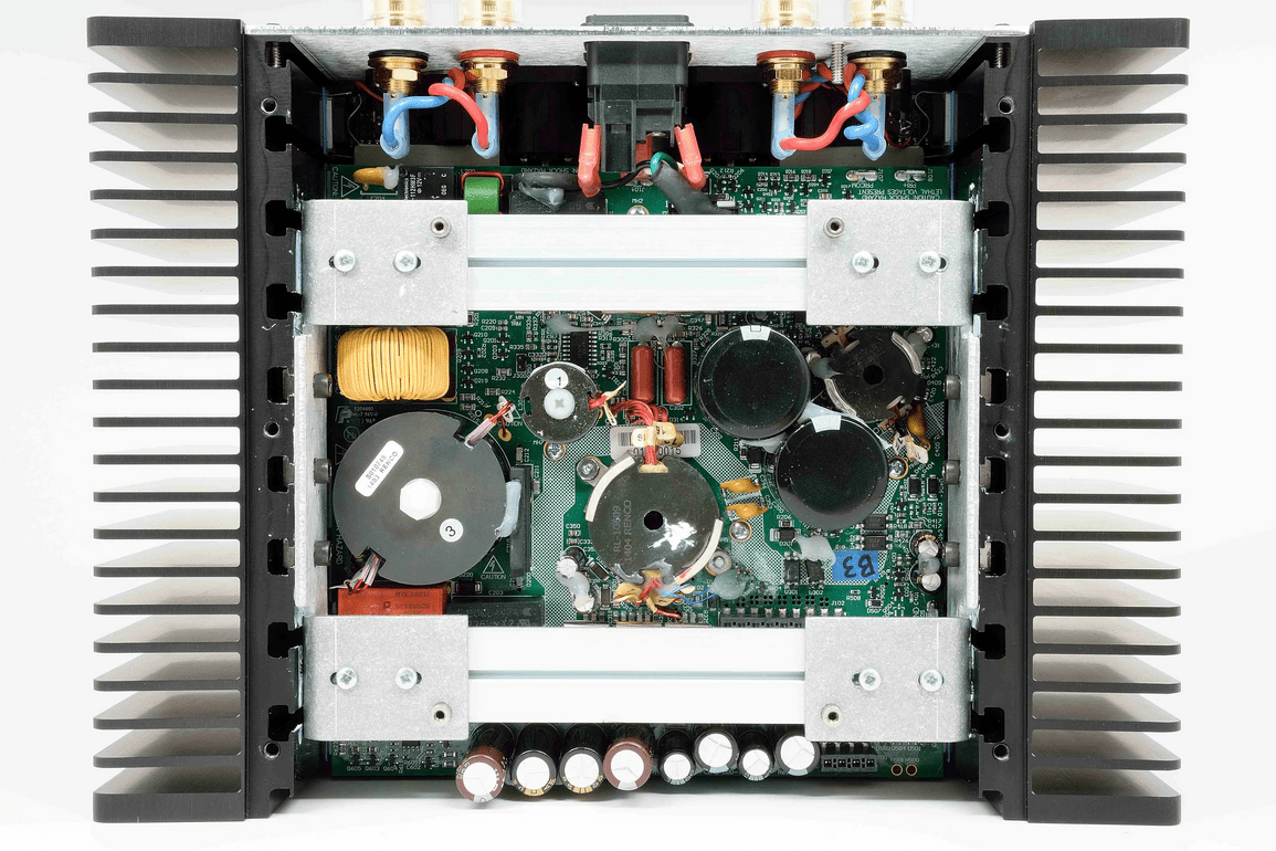

I see it as the equivalent of modern cars.
It's pretty, it seems very well built, it should probably work well, but there is little chance that it will be repairable
and even less to find a schematic or a service manual.
In addition, I hope that there is ventilation and that they have provided a temperature grade of 105° for the capacitors, otherwise we will talk about it again
in a few years .
