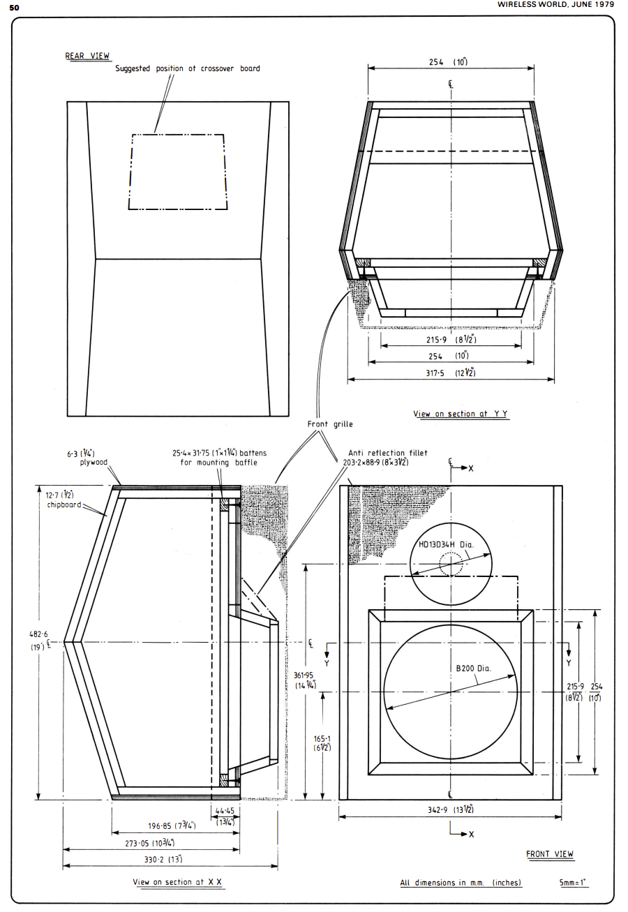

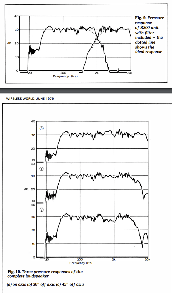

Anyone old enough to remember the Wireless World June 1979 design "Bookshelf Loudspeaker MKII" by Jim Wilkinson.
I built one back in the early 80's and still use it today. Just curious as to how good or bad it was.
It used an Audax HD13D34H tweeter and a KEF B200 ( I blew mine, so I now have B200G)
My cross over is hand wound aircore with heavy wire( some ~14 ga)
Peter

That is one complicated crossover! The B200 suspension tend to stiffen over the years but a closed box is less sensitive to such things than a tuned construction. The capacitors may have degraded if they are electrolytic and the bitumen damping may have dried out and have become brittle. If electrolytic replace the ones on the tweeter parts first. If that brings an improvement go for the others as well
That for sure is one crossover. The whole design is well-thought out. And better documented than the average modern design. I think it really is a bookshelf design, though the measurement conditions aren’t clear.
The main issue is: how did the drivers age. Some old D34s lying around here still perform OK, but that is no guarantee. And next to that, the SP1075 isn’t a SP1014. One last issue could be the electrolytes in the crossover, they probably have drifted due to their ageing.

Not something I would build today - very complex crossover, labor-intensive cabinet, modest off-axis behaviour - but as object in itself, a loudpeaker on par with a lot of good non-waveguided 2 way bookshelves. B200 surround should benefit from plasticizer treatment, like DBP.
Hypotehtically, 3D-printed or CNC'd baffle can really bring this design up to today's standards.
I took the front facisa plate off of the tweeter so I could mount the tweeter as close as possible to the B200/B200G. My cabinet has almost the same volume but is a simple rectangular box. The wood working required was beyond what I could do with hand tools so I took the easy route.

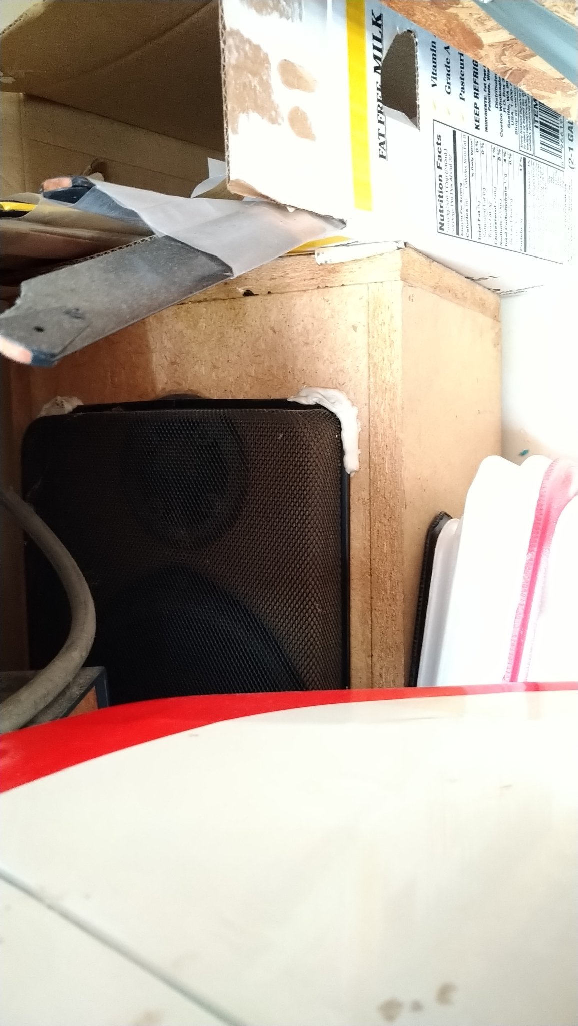

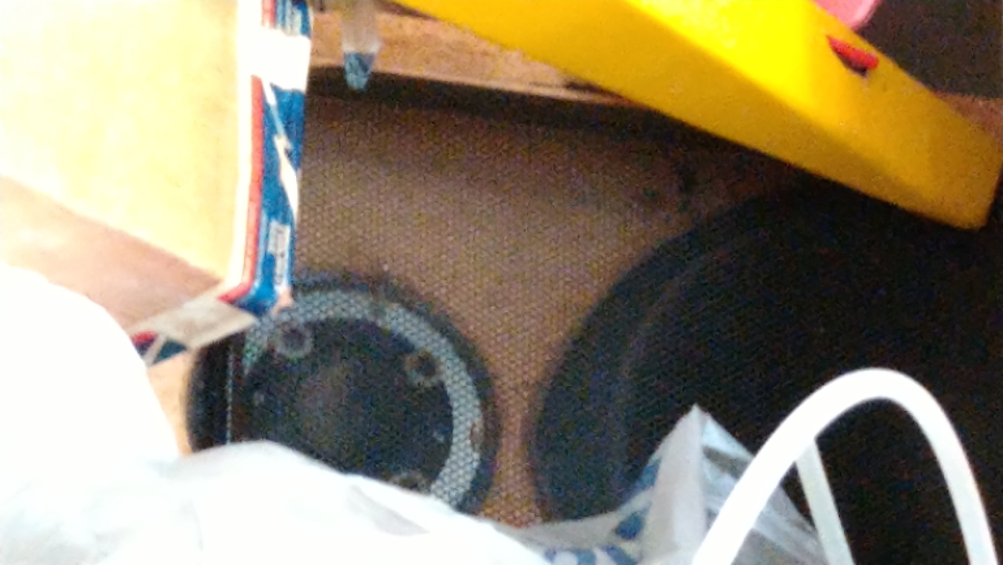

My B200G's surround looks new. Its been in my garage near the ceiling and never gets sunlight. May be I need to look again, but its probably dusty!
I guess I should take a picture of it, so you guys can have a laugh.

Kind of hard to take a picture since they are up on a shelf next to the ceiling.
The fascia of the tweeter was removed so I could mount it close to the B200G, and also leave a space for a panel brace between the two drivers on the back side.
