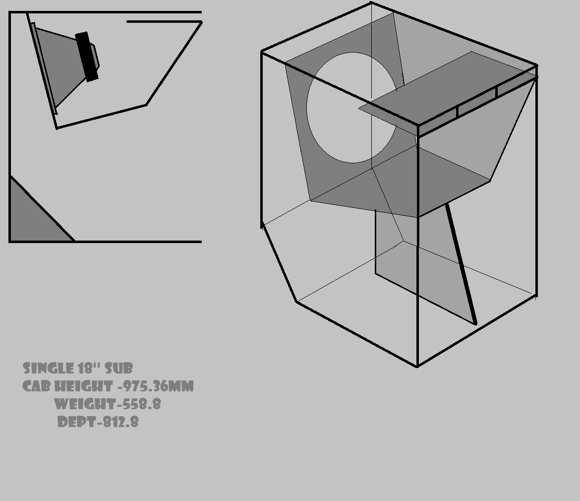

Been rounding up 6th order bandpass, about my design i have question
front port is larger than front chamber, is this going to act like front loaded vented horn or 6th order bandpass, hornresp shows some difference between these two, not much but visible to my eyes.
6th order bandpass is bit mindblow, it´s just group delay controlled vented box
I dont know which i went but went as planned on first post.
Its more simmed as offset front horn than 6th order bandpass. Thin red line between those two
Yeah, about the same but my rear port is inside the front flare. Series tuned offset front horn? Now simulate that on hornresp
