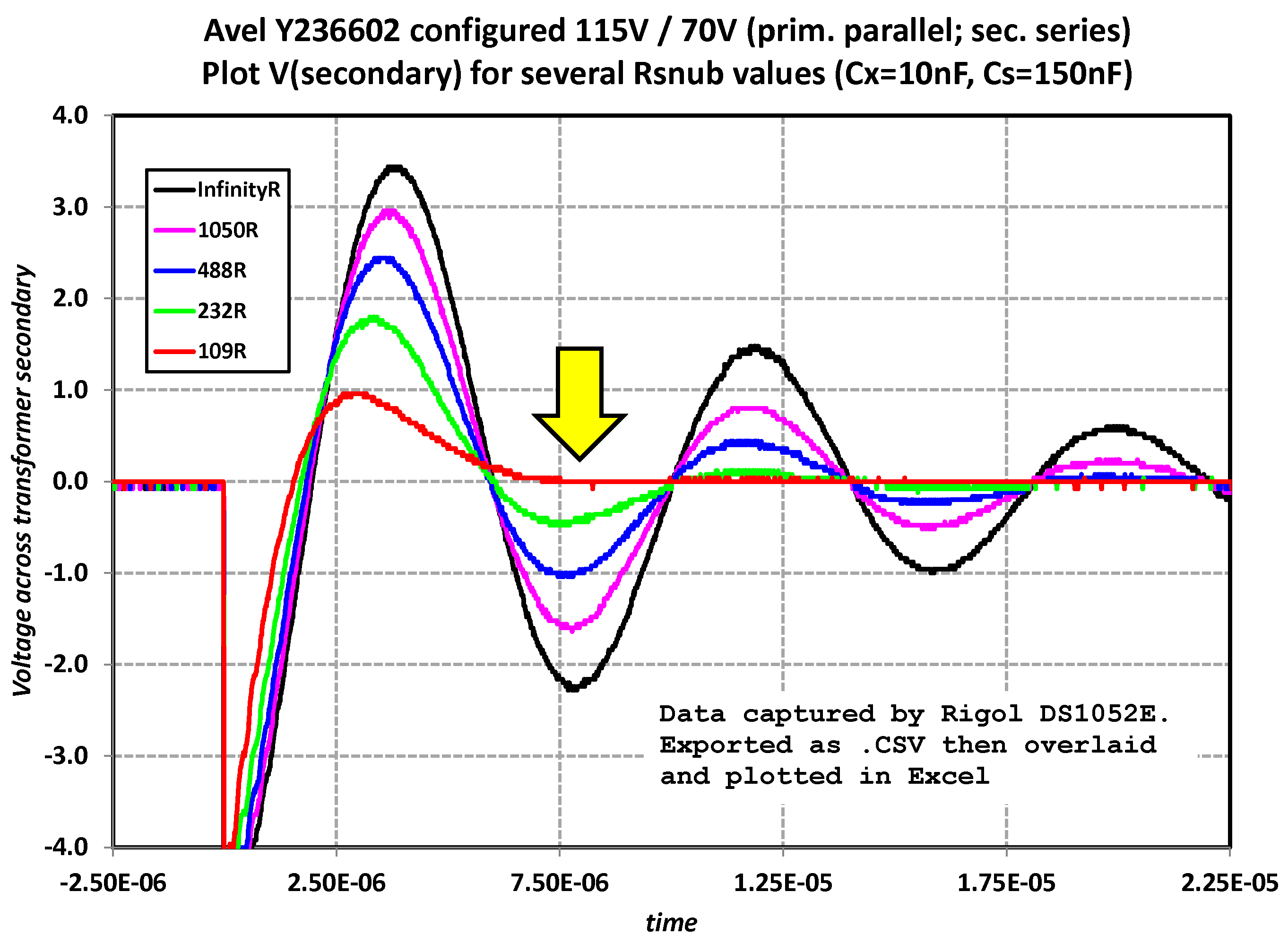

Although Quasimodo really is "as simple as that" and a joy to use and find that lumpity bumpity moment (THANK YOU MARK!), as I am starting this little expedition, I have some issues and question-marks (pun is fine 🙂 )...
My first steps are indeed promising, with results looking like good, but not yet spot on, just close to.
first image = 18V 50VA tranny
second + third = toroidy 16V 30VA, secondaries connected / unconnected
fourth = connection scheme (an ugly sketch, apologies for that)
fifth: bump
Now, something itches me with the toroidy 16V30VA: While I can reduce the ringing, there seems to be a "sticky point" in the curve, that makes it look a bit bumpy.
My guess is that it's something with the 1:15 Cx - Cx ratio, but... what values should I aim for? Increase Cs? By how much?
I ask because I'd prefer not to waste by buying nonsensical parts...
