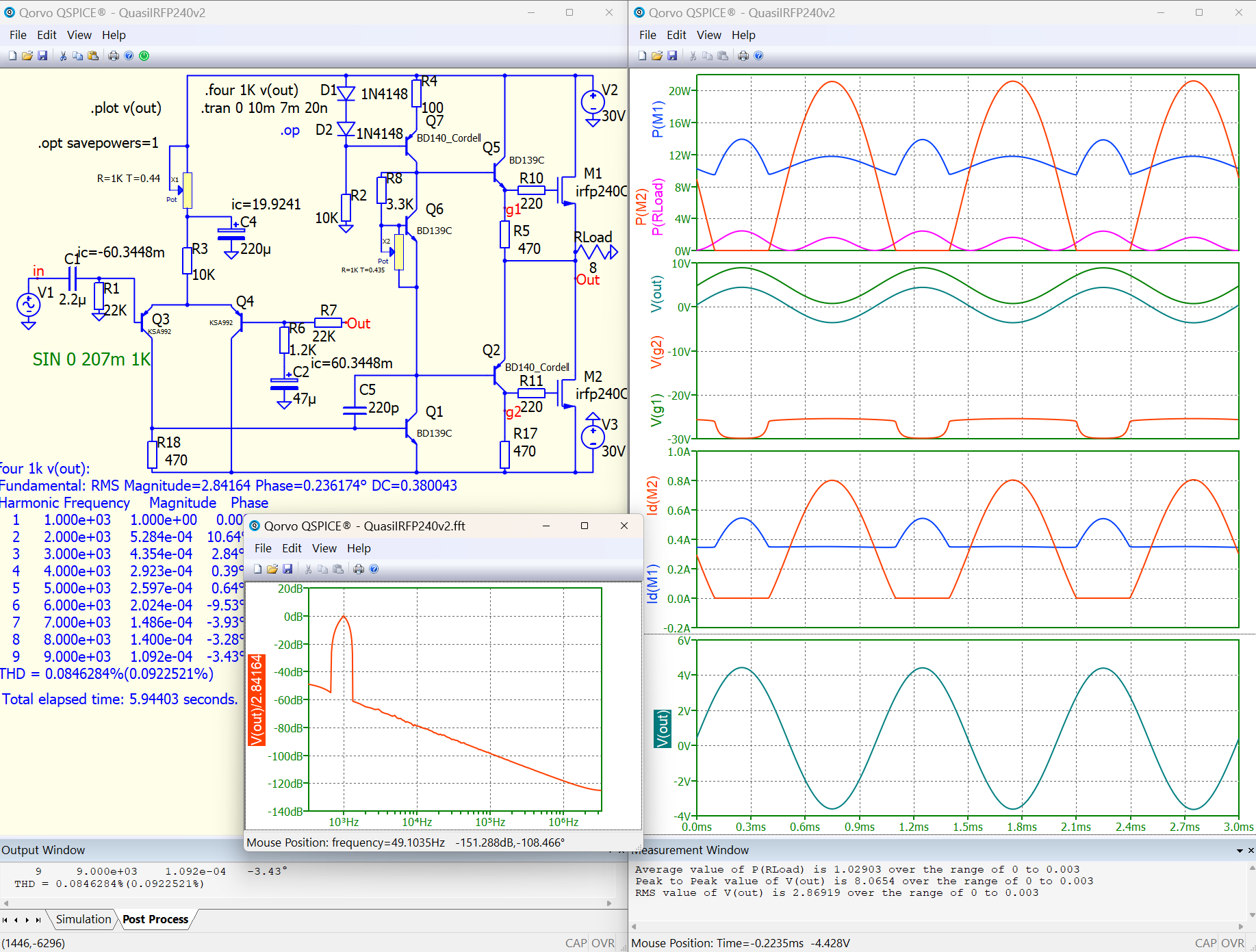

B bordodynov Member Joined 2015 Tuesday at 2:04 PM #21 Tuesday at 2:04 PM #21 My result is at an output power of 1 watt. Last edited: Tuesday at 2:10 PM PMA Member Joined 2002 pmacura.cz/audiopage.html Paid Member Tuesday at 2:18 PM #22 Tuesday at 2:18 PM #22 bordodynov said: My result is at an output power of 1 watt. Click to expand... = MOSFET quasi complementary crossover distortion of 0.1%/1W. This is to be expected if we look at the circuit. Prev 1 2 First Prev 2 of 2 Go to page Go You must log in or register to reply here.
