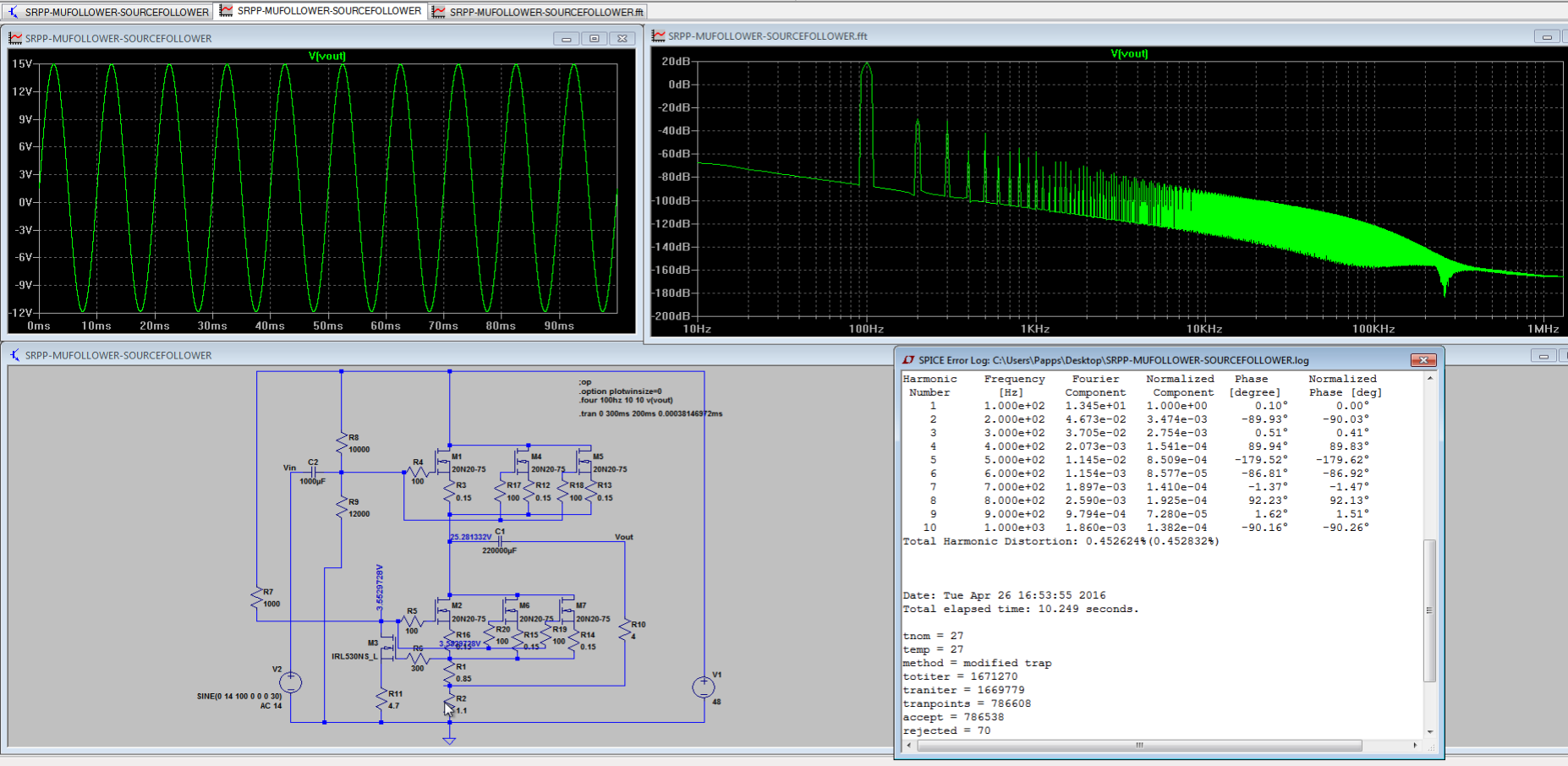

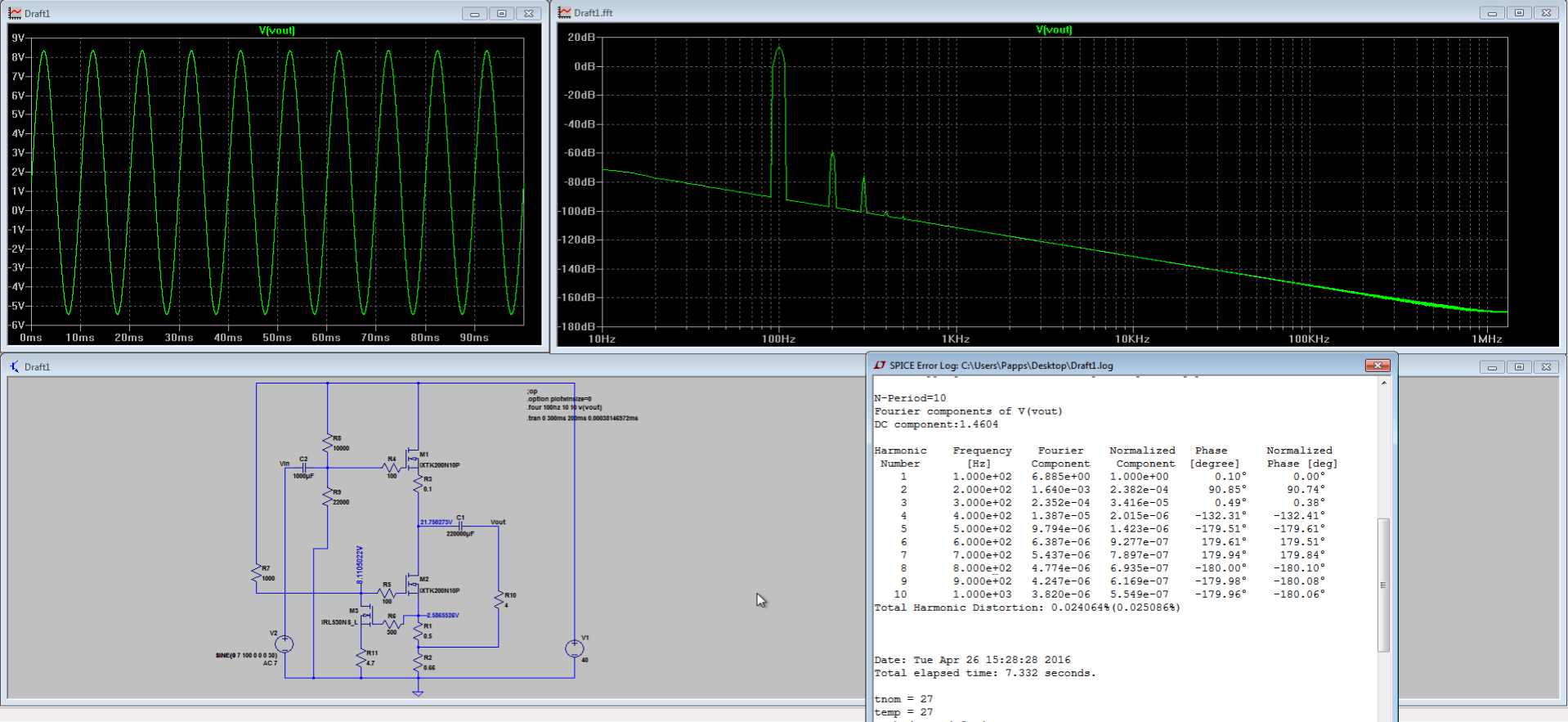

With so many nice SiC devices becoming available, I thought it made a lot of sense to do a quasi complementary Firstwatt F4, I've modeled it with double die lateral mosfets but it should perform as well if not better with SiC devices.
Bias is 1.35A
I was too lazy to do a detailed bias circuit. I can do one if someone needs help with it.
4Vpk into 8 Ohms
Total Harmonic Distortion: 0.005069%(0.005069%)

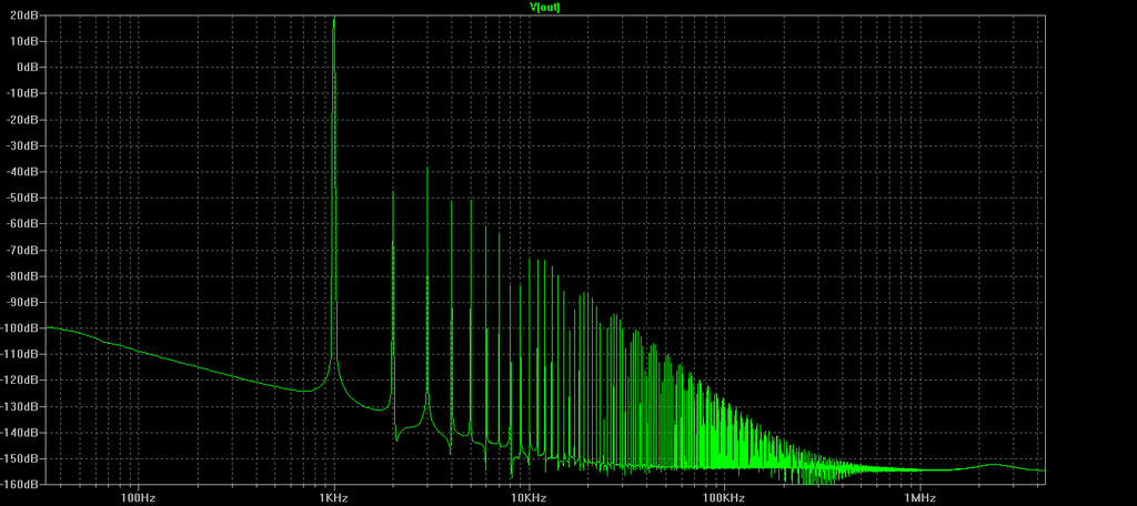

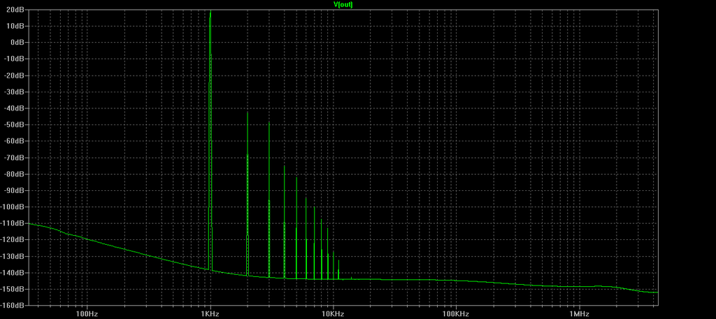

Pico's Quasi vs F4
Pico's Quasi Circuit
Bias = 1.35A
14Vpk into 4 Ohms
F4 Circuit
Bias 1.35A
14Vpk into 4 Ohms

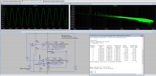

Bias = 1.35A
14Vpk into 4 Ohms
F4 Circuit
Bias 1.35A
14Vpk into 4 Ohms
