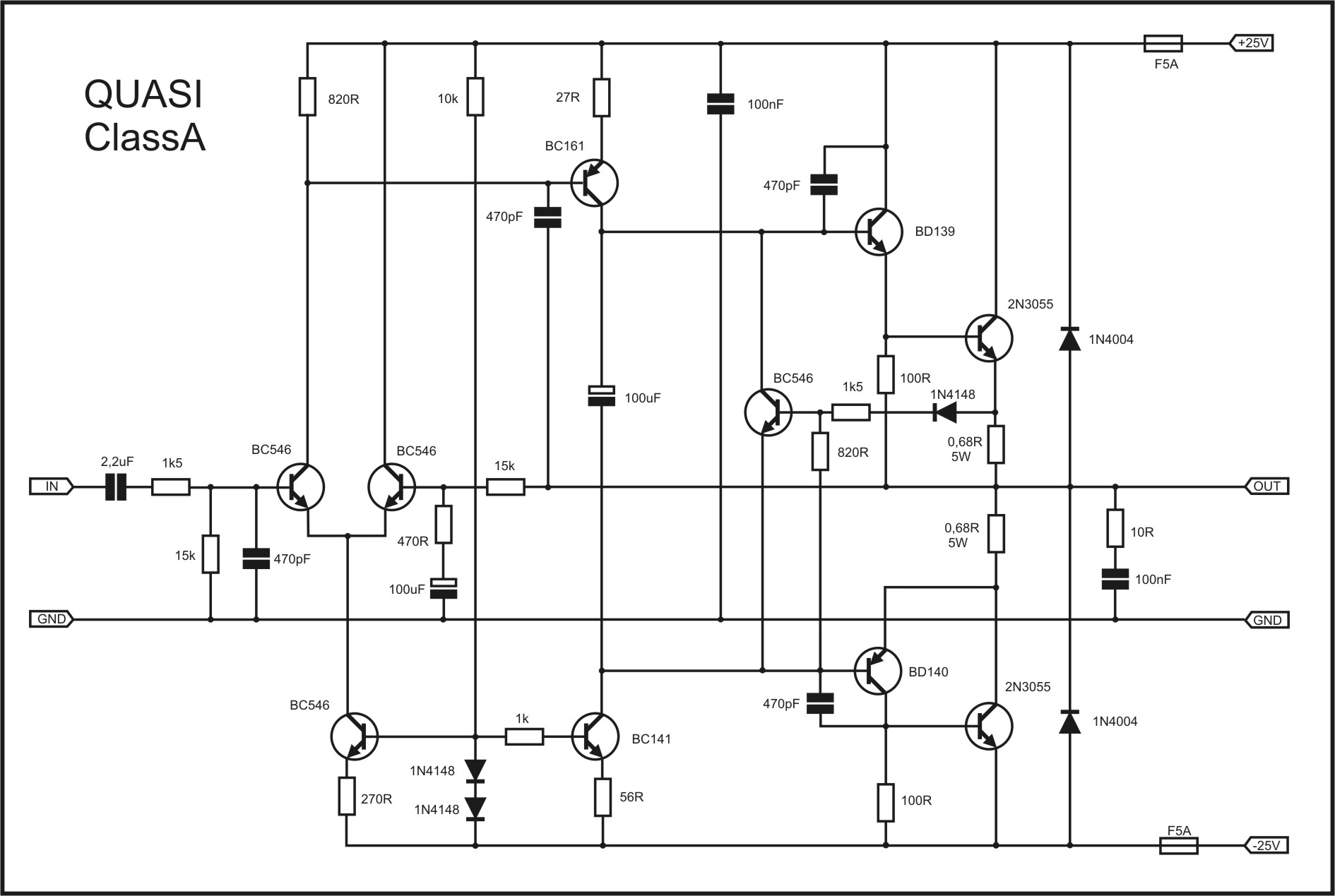

I need some help regarding Quasi's Nmos200. I have build one using the schematic provided on his website. used 50 + 50 volts as power supply and used just one pair of irf840 as i only need 100watt power. also for VAS i have used BD139/BD140 (T6 / T7). but VAS transistors and BC546(T8) and R12/R12 (47ohm) blowup fast as i try to input some signal. working fine when there is no signal or very low signal on input. also i have adjust quiescent currrent to 30mA and dc offset to less then 10ma using this method.

can some one please guide me where i am doing wrong and what i should do to get this resolved.

1pair of irf840 is not sufficient for a reliable 100W of maximum output power.
You need ~ 400W of total Pmax for each channel to get a reliable 100W power into severe reactance speaker with decent heatsinking and domestic type duty.
Pmax irf840 = 125W therefore 1pair comes to 250W and that is good for ~ 65W
2pair would do ~130W, but the maximum Ic is still only 16Apk
Note that these very high voltage devices have Ic = 8A and the SOA plot does not show DC nor 100ms curves. this probably indicates these are purely switching devices. You may find that the DC SOA is far below 125W at 100Vds

Thank you AndrwT for guiding me.
So 2 pairs of IRF840 is fine or what you suggest? i am using 50+50 supply. the burn up issue of VAS stage resolved by replacing BD139/140 with MJE340/350. i have used 2 pairs of irf840 but the bass on subwoofer (3 ohm 130watt) is not that solid as i expected. on high bass signal cone of speaker seems as it will come out of the frame. this is my first try to build an amplifier and i am not that happy with it. i am building 2.1 channel system. can you please guide me further.
two pair of irf640 would be better.
Better still to use two pair of irfp240 Pmax 150W, for 150W maximum output and 40Apk
With moderate or easier speakers, kept cool and +-50Vdc, you might get away with one pair, but I don't recommend that.

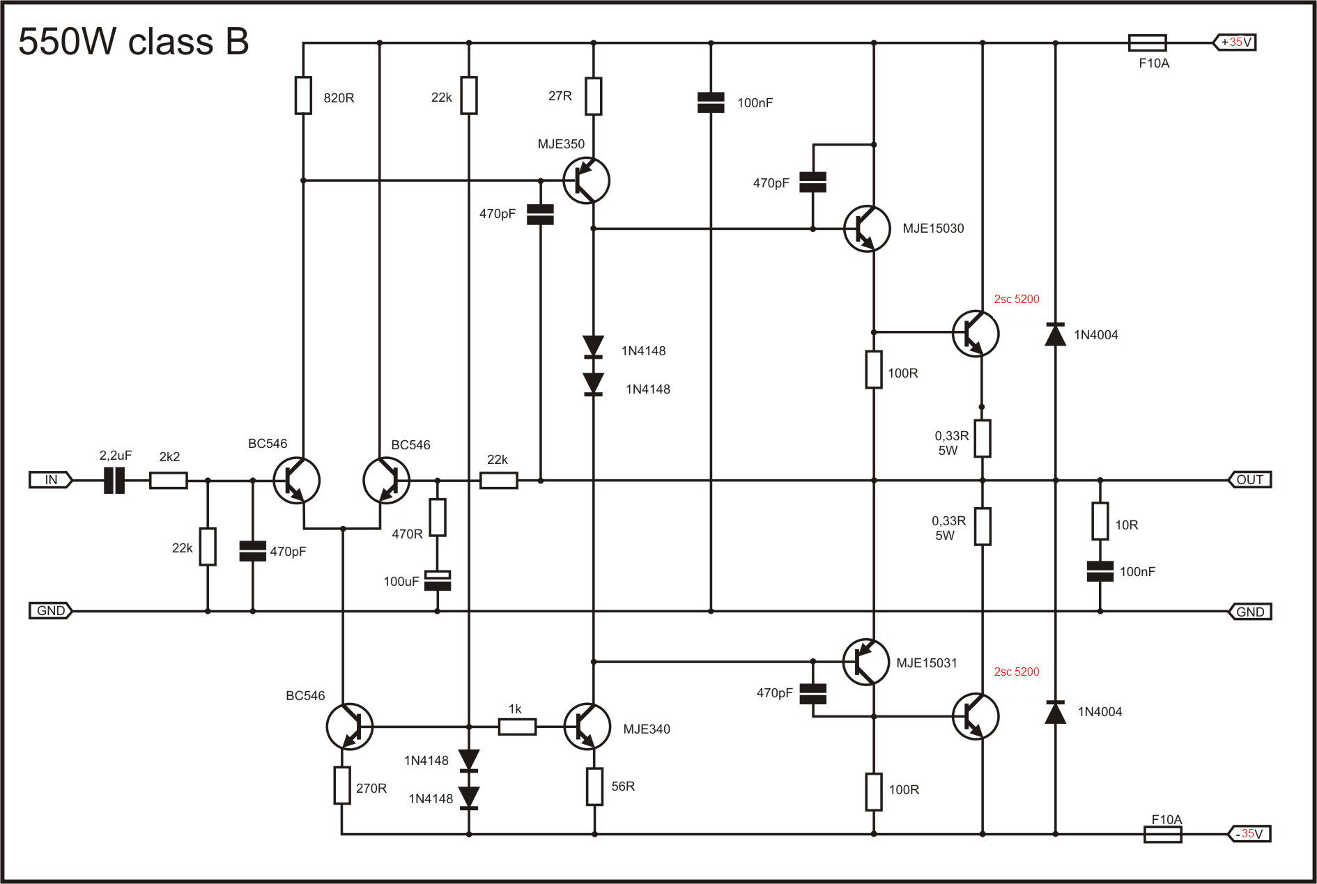

I have 35-0-35VAC 350VA transformer And one pair of 2sc5200 can I use b550 circuit and PCB, what other changes I have made in circuit & how many watts I can get on 8 Ohm load.please help
+-50Vdc supply from a 35-0-35Vac transformer will give a maximum output of ~40Vpk

You have the voltage and load information so you use the version P=Vpk^2/R/2
guess what, it comes out as 100W into 8r0
The maximum reliable output from a pair of 1943/5200 is Pmax/6 = 2*150/6 = 50W
That is half what the 35-0-35Vac transformer is capable of forcing through the output stage. Don't use one pair of 1943/5200.

b550 amp circuit with op 2sc5200, +-35v is enuff for one pair of 5200.Help if any other changes required in circuit.And which PCB layout is correct, please mention,
For +/-35Vcc power supply one single pair is enough, but you said you have a 2x35Vac transformer, if that is what you will use, then one single pair is risky even with 8 Ohm loads.
do a temperature de-rated SOAR for the 1943/5200 with a 45degree phase load (moderate reactance speaker) and with a 60degree phase load (severe reactance speaker) and see what you get for peak transient stresses.

NO, I start with the single pair on +-35V(8Ohm load) then upgrade to more, is it safe use 2*35VAC with 2 pairs of 2SC5200.And which semantics, PCB layout is correct.
+-35Vdc will allow approximately 50W into 8ohms. 1pr is OK.
+-50Vdc will allow approximately 100W into 8ohms. 2pr is OK.
But you must not let them overheat while trying to play "loud".
What temperature can you keep your heatsinks down to in India?
