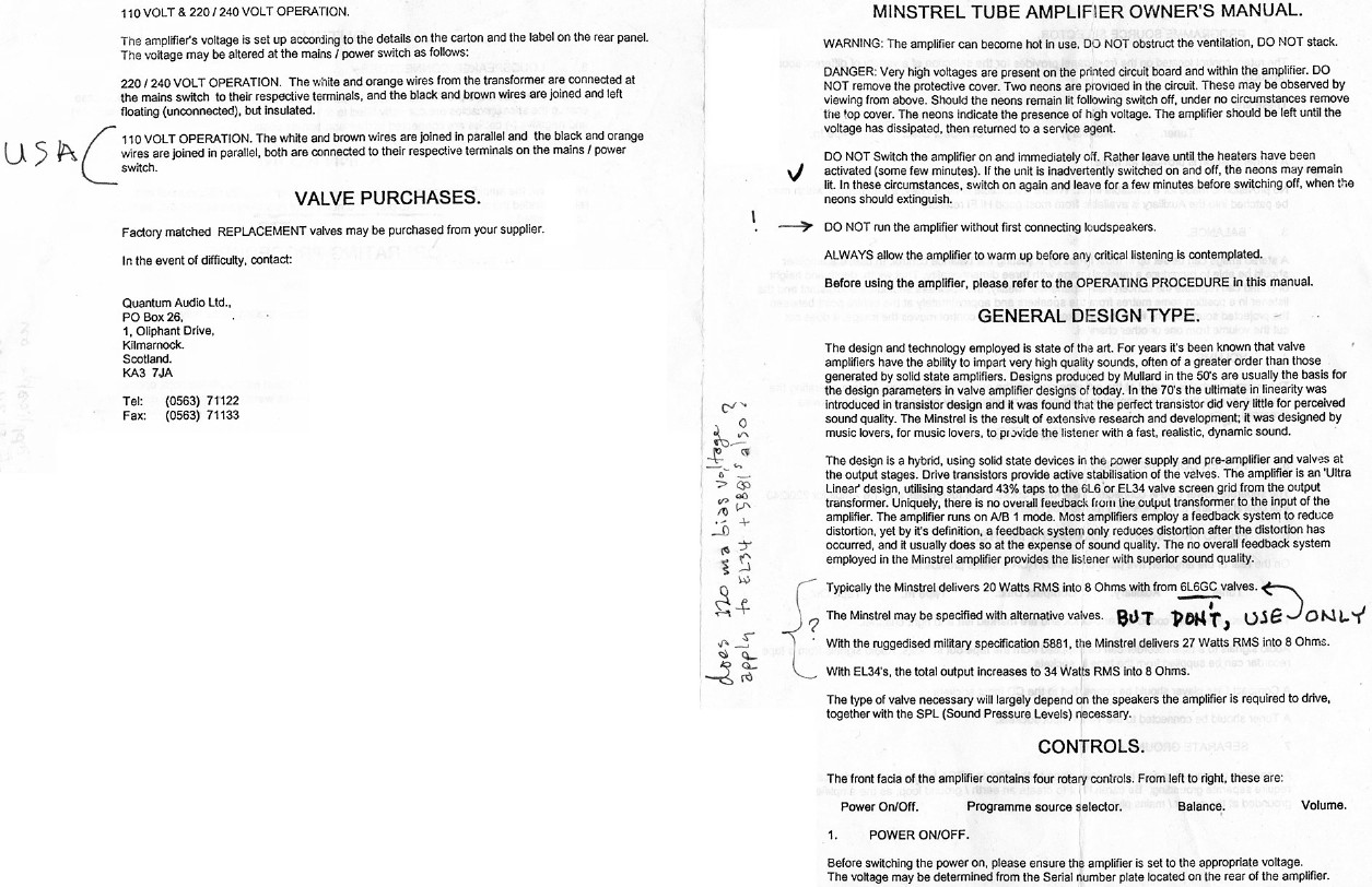

OK, I found some of the documentation. (I still need to find my glossy sales sheet) A very kind friend of mine gave me a matched quad of 6L6's for a "HOUSEWARMING" gift when I moved recently, and he included the data sheet for the amp. He marked it up a bit but I will scan it and make it available to those who wish to know. (splodgedog, I'll email it to you as soon as it's scanned.)
My friend specified that although the amp will work with other valves, the 6L6GC is the only one we should use.

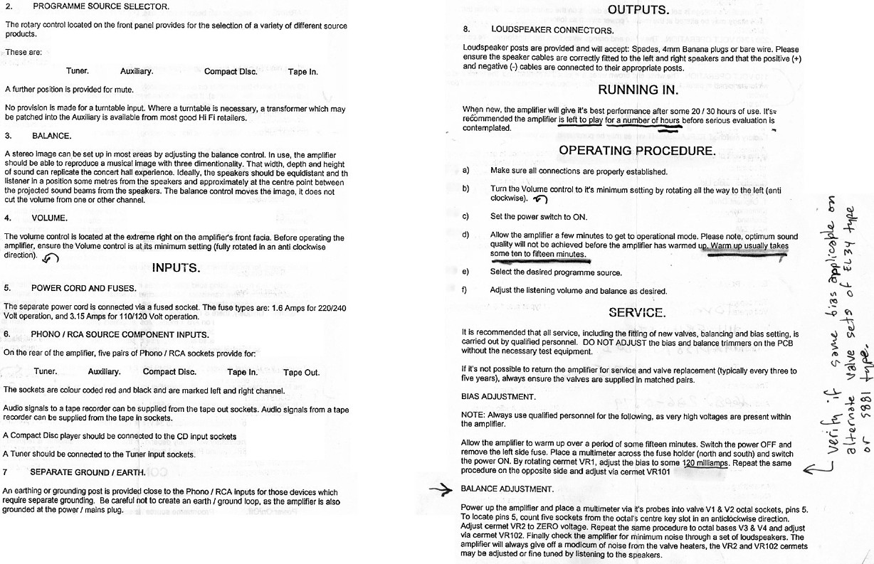

I have one of these tube integrated amps less the tubes and hope to find biasing instructions. Found this site just now via Google and as a new member can't e-mail the two guys who chatted about it long ago.
If either of you are still here or anyone else knows, I'd really appreciate the input. It looks like the manufacturer is long out of business.
Let me try to attach the scan here, so anyone who needs it can find it. .
(good thing I have this board set to email me when there is a reply to the thread!)
Ok let's try posting it on imageshack.us.. .
note my friend's instructions in pen, we were told that milspec 5881 tubes could be used, but we're not sure if the biasing would be the same. Note that use of the 5881 tubes will increase the power output to approx 40w/ch and will change the charactaristic sound of the power stage compared to 6L6 tubes.

Ideally need circuit diagram / biasing info.

I have a Minstrel amp which I have had to put new valves in. I would like to check the bias current, there are two led's which I suspect are indicators of the correct level, but any information you have would be appreciated.

if you are still paying attention, I applaud your patience. Here are the scans of my data sheet, with markings from my friend. It was originally folded, so we have two JPG's, one is page 1 & 4, the other was the inside of the booklet, pages 2 & 3
