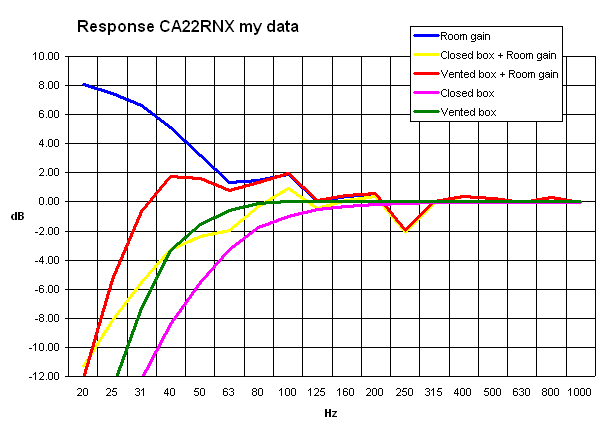

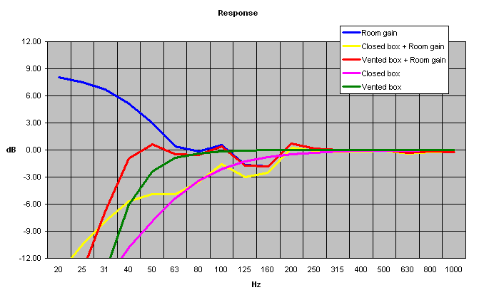

I'm coming round to the feeling that aperiodic or damped reflex might work best.
See, most reflex suffers from standing waves. But damp it with some stuffing behind the woofer and in the middle of the box, and it becomes BW3. And that seems to fall nicely between BW2 closed box, and BW4 or LR4 reflex. And works well with room gain.
It also keeps stuffing away from the crossover, which keeps it cool. So it could be the best of all worlds.
Bit of Allison Effect dropoff there at 150Hz with the Nomex 164. PEERLESS-NOMEX-164
The Poor Man's Strad with a lower woofer (causing an Allison Effect at 250Hz) seems to support the idea too: Poor Man'
