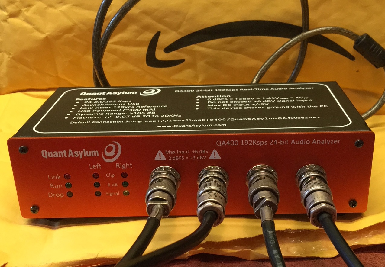

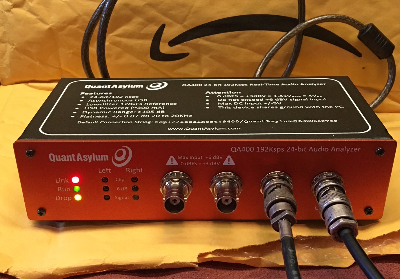

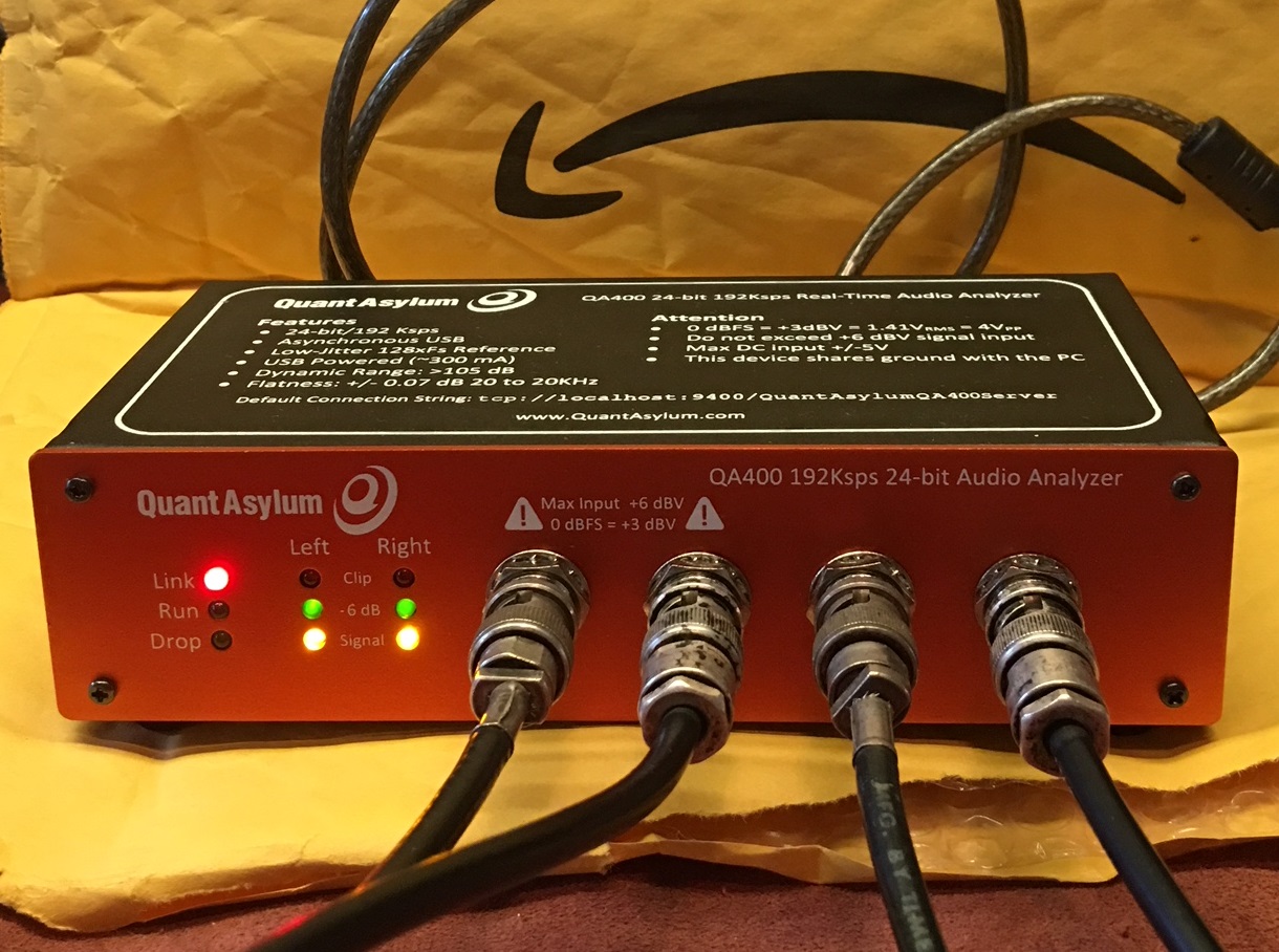

QA does not link any longer and on the face of the QA box it shows, left signal yellow LED, on; with -6db green LED, dimly on.
Problem launching the QA40x now, "Problem Launching QAScope" "Another instance of the application is already using the hardware."
more Ouh da joi. And yes I found the QA USB, but it doesn't seem to make a difference. Just to be sure the box isn't fried, it works on my desktop system. Either L or R, or BOTH. Links right up, properly illuminates, did the complete calibration w/o an issue. So I've eliminated the box as the problem.

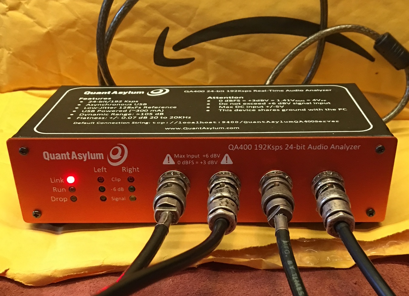

I went back and redid that, now I have USB 2 installed and verified. So I have the desk top win7 machine running QA40x just fine. However the Dell laptop win10 running QA40x v1.0696 recognizes and links to my QA400, it runs, read appears verify the signal in the left and right channels, but it won't read or log any data in the FFT. Desktop which works had QAs USB Driver 1.0.0.2, Dell Laptop which doesn't, QAs USB Driver 1.0.0.26.
Then in the VB-VM window I got the "Dink da-la-link" Rising higher pitched tones. the, "Da-la-la" falling tones, with Link LED - on. It still wont recognize any input from the device and show the USB: as Disconnected. Damn, I need this to work on my laptop and on my bench. It isn't worth upgrading to QA401 if they have the same issue and only run under VB-VM on a win10 machine.
